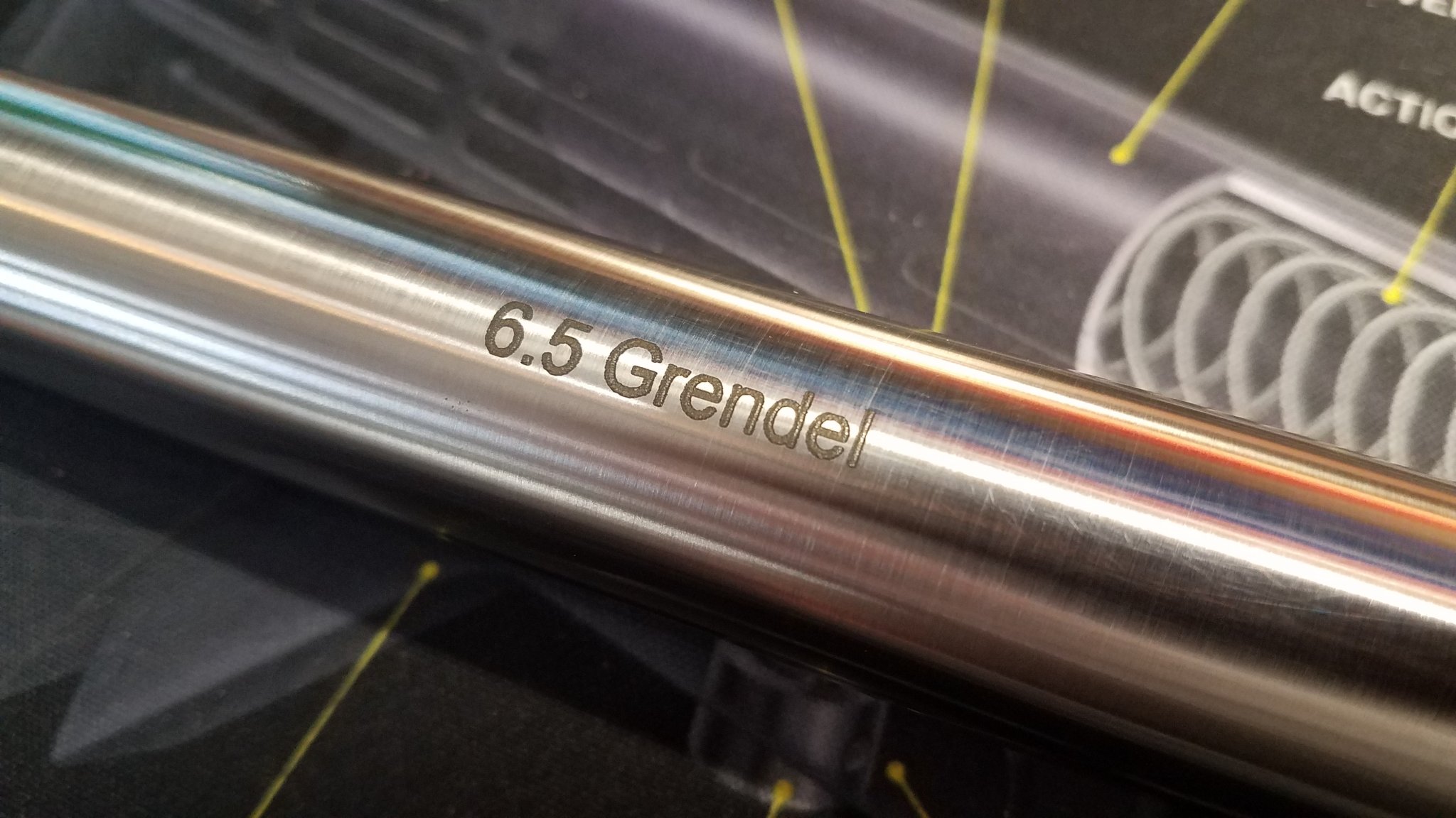

I've seen a lot of knife makers use electro-chemical etchers with what looks like good results to me. Not sure if you'd get the depth of a laser or mechanical engraver through.
Though this gentleman seemed to get impressive depth with an etcher.
Had my Grendel done by a local friend. Cheaper than buying one....

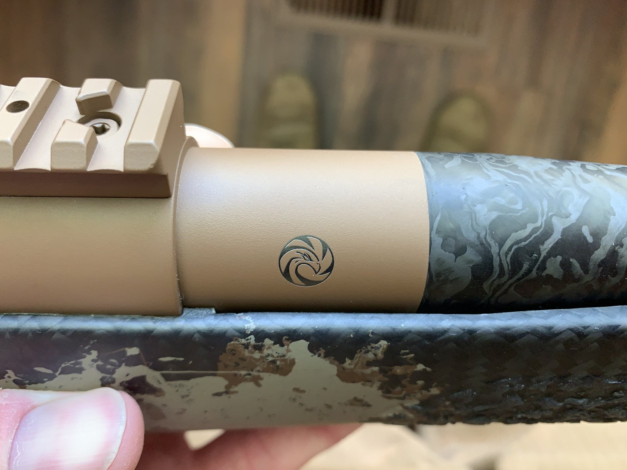

Your best bet would probably be to find someone who can do a laser etch for you. Excellent quality, and very very flexible. I have a nice electro chemical setup, but I don’t use it in favor of a local laser guy. Too cheap and easy, and he does it while I wait.
He has a cool technique where a frequency change on the laser creates a shiny almost iridescent look. I used to have him just etch then coat, but this looks much classier.
Here’s an example. Shallow etch through Cerakote and blackened.
Vs a standard etch through cerakote.

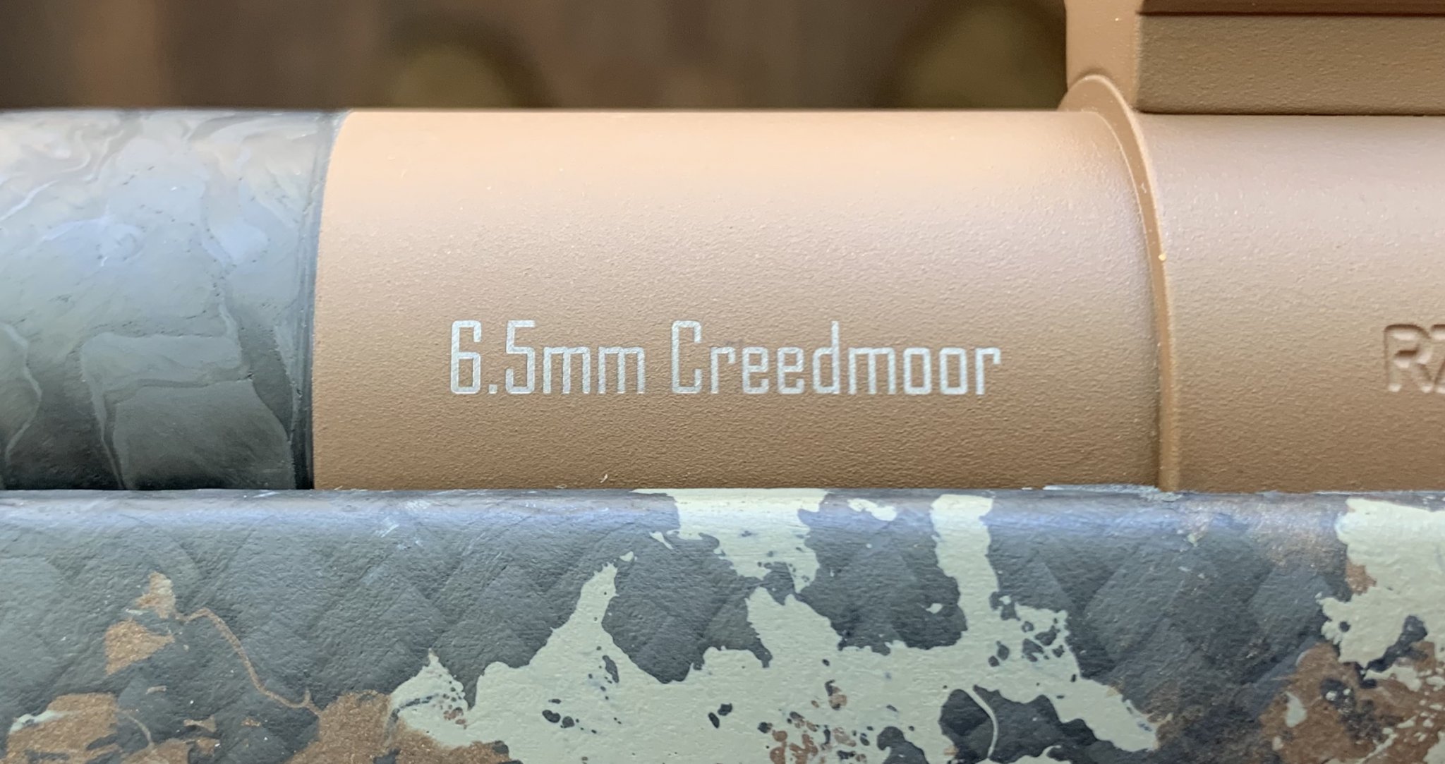

Deep etch through Cerakote and blackened. Note the gloss appearance in the “6mm”
