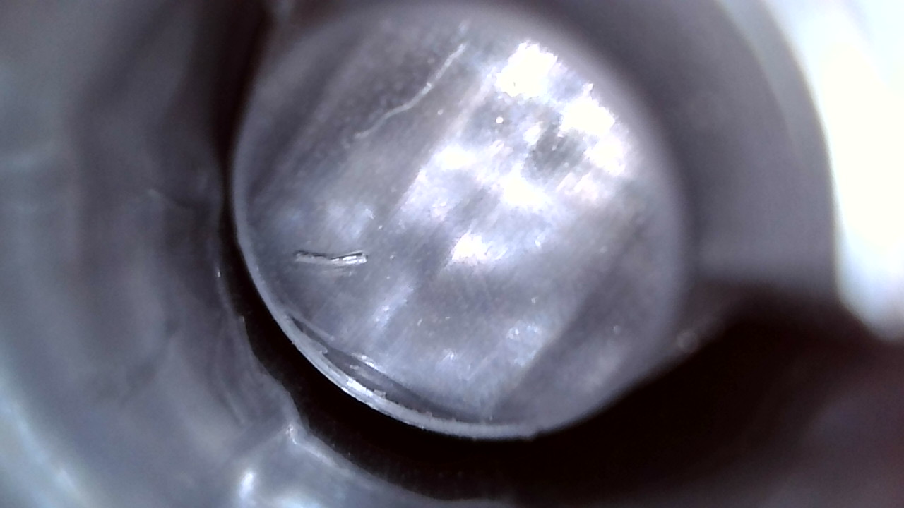

Marks on inside od 22lr barrel
scotty2hotty
Aug 6, 2017
270
210
Would these scratches? grooves make an effect in performance? I didn’t do this.

If ya' don't know ya' ask.
That's how ya' learn, right?
80be1d5a-9f30-40f1-b33a-6538633e2990-jpeg.7929337
Look carefully, can you see it in two places?
In the mirror and direct from the lens looking forward?
That's a piece of cotton patch.

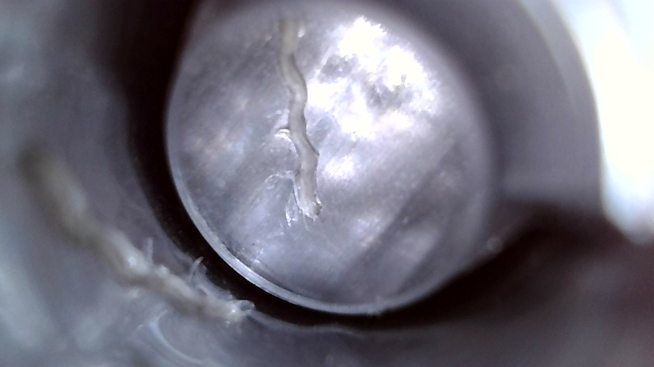

9aa91316-1285-4f6a-8539-d7c5debe1383-jpeg.7929338
It's barely visible at the bottom left of the mirror on the wall of the bore
but easily identifiable as another strand of cotton in the mirror, once you've had someone explain it.
Borescopes are handy tools, keeping mine. ;)
Ummmmm....is that bore a bit smoother than it should be?
Could be just at the start of the leade.
I don't see much in the way of rifling....:unsure:

It may be the potassium perchlorate is forming the crystals during decomposition I have found and what people see that the assume through guessing that is glass.
