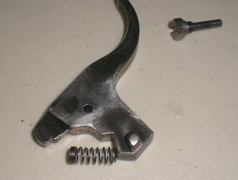

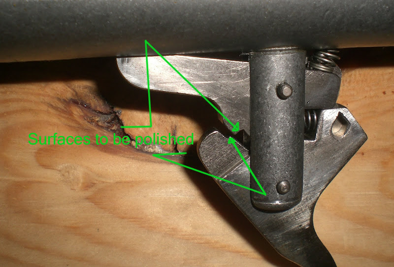

Once the barrelled action is removed from the stock, from the left side of the weapon, (I failed to take a pic of the right side but can if the need arises...)
Removal of two screws allows the entire trigger assembly to be removed consisting of 7 parts. 2 springs, 2 screws, sear, trigger, and safety lever. the bottom screw removes the trigger, and free's the trigger spring. This picture shows the assembly together, and notes the two surfaces to be polished:
same here, but with the sear surfaces mated:
I did not take the full trigger assy apart again tonight, I don't feel like chasing the stock sear spring. basically I took a spring from a pen, and cut off 1/2 inch, leaving about .35 inches remaining. The half inch piece replaced the stock trigger spring, and that spring is NORMALLY positioned vertically in the channel. I positioned mine longitudinally giving slightly less trigger pull resistance...the trigger spring has little to do with the actual trigger pull, and everything to do with sear engagement when operating the bolt.
the smaller piece of spring is then placed OVER the stock sear spring using the sear spring as a guide. the sear spring seats into two detents, one on the sear, the other in the action above...if you have one of these rifles and take it apart, you will see what i'm talking about.
once you have polished the sear surfaces with a very fine polishing stone, and you have placed the sear back in with both springs (stock plus the .35" piece of pen spring - these springs give the trigger pull break strength), you can then place the trigger back in with the 1/2" spring aligned as shown here:
other work done, I cleaned up the sides of both trigger and spring with a high speed stainless steel brush on the dremel and gave a quick polish to them. they don't look really smooth here, but they feel like glass. same with the sear engagement.
I also filed off a tiny amount of the sear engagement surface (not truly recommended, unless you have spare parts handy as you can render your rifle to a paperweight real quick).
I wish there was a way for you to experience the trigger over the net but there isn't. I also apologize for the crappy pix, I'm really a bit too lazy tonight to take the whole thing apart and chase that factory spring once I pop it out. It is a PITA to get it lined up and back in.
This whole thing really only took about an hour of trial and error to get the springs right and I mangled 3 pens doing so. the pen that worked the best was one of them old black military clicker pens with the silver ring in the middle and the 3 piece head.
If you need more pics than this, i'll re-take but I think you get the gist from here.
