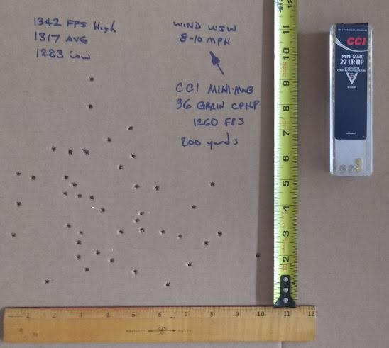

I have a Marlin Model 60 I got in 2018. I made the mistake of listening to people who recommended this gun, and I have been trying to make it work. I put an Mcarbo trigger in it, which is not great but considerably better than OEM. I rigged it up so I could install sling studs without anything touching the barrel.
Today I took it out and shot it with 36-grain Mini-mags at exactly 50 yards, confirmed by my nifty new rangefinder. I shot from a bench with a rear bag and a Caldwell Rock, Jr., and I pretended it was an AR-15. By that, I applied the stuff I learned here about shooting gas guns. I figured it would not hurt the Marlin's accuracy, and it would be good practice. I used a Bugbuster scope, which is a fairly nice Chinese 3-9x.
Once I got the scope working, I shot 4 5-round groups I was able to measure. I could not use my 5th group, because it contained a 6th shot which I fired while just making sure the gun was empty, and I have no idea which hole came from that shot.
Anyway, I got an average of about 1.97 MOA. I guess I should be happy, but I'm pretty sure my Savage A22 shoots better.
Is there any hope of doing better with this cheap gun and ammo? Are there any well-known fixes to make these guns shoot?
I feel like it's unethical to shoot squirrels with a 2-MOA gun outside of maybe 50 feet.
Maybe when ammo isn't a quarter a round!
I was thinking maybe the gun itself could be improved. I kind of wonder if the Model 795 is better because it doesn't have a tube magazine pinching the barrel.
On my property, most squirrels are 20 yards or more off, and a 2 MOA gun at the bench is less accurate in the woods with no rest. I think it's time to dust off the Sweet Sixteen and forget about rifles for squirrels. I feel like I'm maiming animals for no good reason when I could have more shot opportunities and kill them quicker with a shotgun.

10 inches of spread at 200 yards
3.3 inches at 100 yards
1.1 inch at 50 yards
0.4 inch at 25 yards, good enough for head shots on a bushy tailed branch manager.
