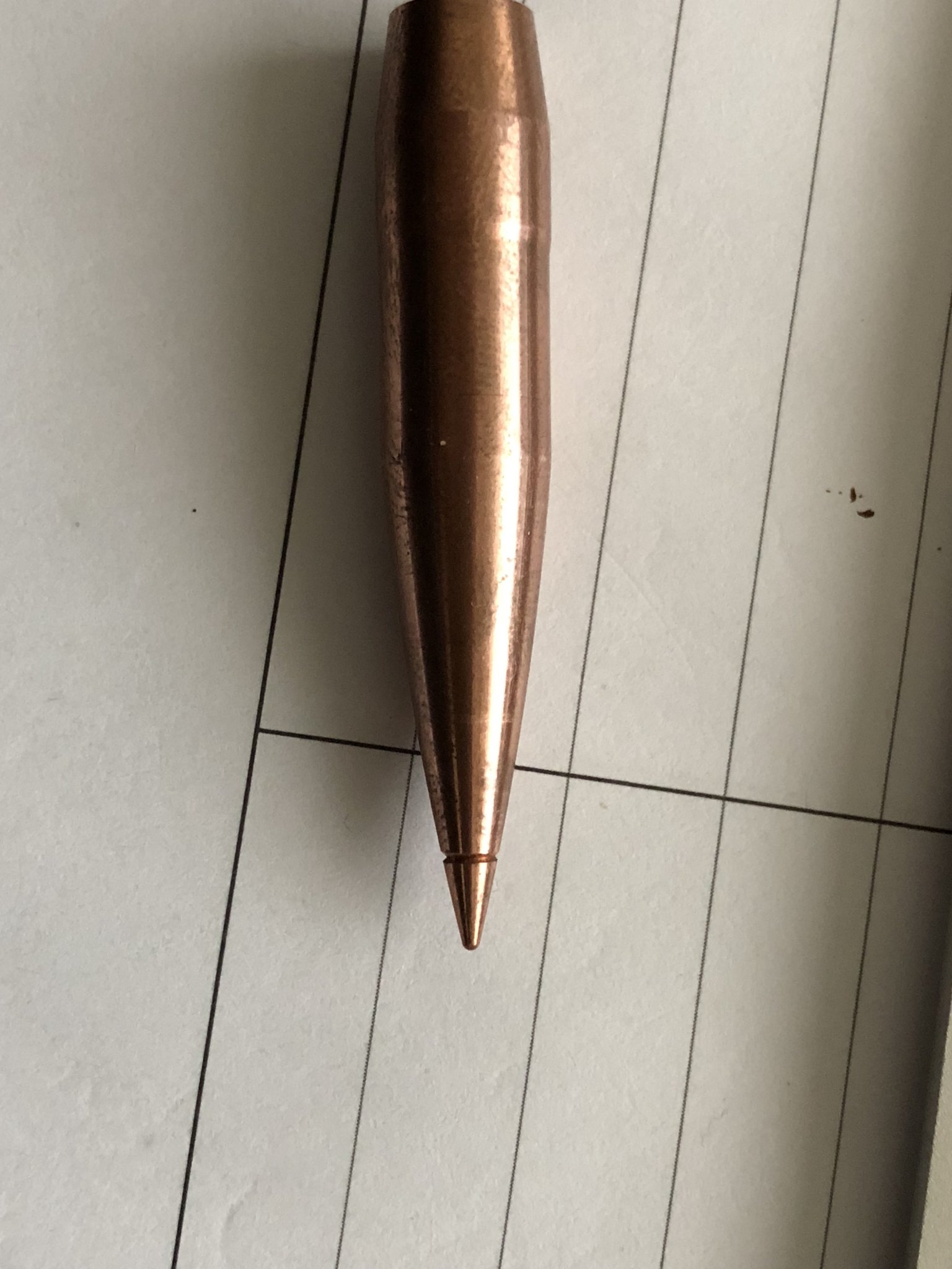

Here is the image of the tool

So it looks like the tool allows for placement of the ring in various locations, true?
I am sure Mr Tubbs done testing on best placement?

When you look at the aerodynamics viewpoint of of bullet flight. David Tubb is a genius with the annular nose ring and rebated boattail. Both in theory should have a significant difference which he is proving. Both create reduced drag by speeding up the laminar to turbulent airflow. I am curious if it reduces yaw variables as well past 600 yards. I will have to re-listen again. I know he pointed out the vertical spread difference.

To determine if the nose ring helps in the yaw aspect it would have to be tested with traditionally twist rate barrels along with the super fast twist rates David uses.
As it stands right now the yaw reduction is accredited to the "hyper-stabilization" theory with the 7 twist barrels David is using.
Warner Tool has stated that the nose ring is beneficial to the Flat Line projectiles having a better transition than the Flat Lines without the nose ring.

This nose ring concept seems to make me wonder if we were indavertantly doing the same thing in .223's with 75 ELDM's when using the wrong seating stem ( it was leaving an annular ring a couple thousandths behind the polymer nose). Hmmm....I remember thinking to myself that it was strange that I didn't see any loss in accuracy with that batch of ammo.

Right now prototypes have been built and are being evaluated before production begins. I do believe they will be sold through David Tubbs website.
