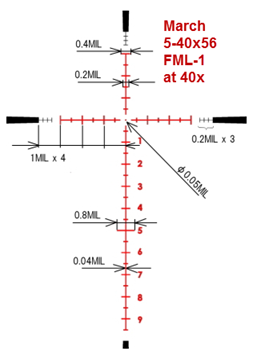

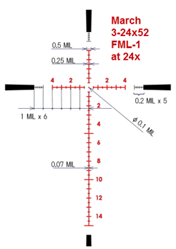

On the March scopes. The 3-24X42 and the 3-24X52 both have the FML-1 centre dot as .05 mil. I believe this to be incorrect, that’s the FML-1 in the 5-40X56. The FML-1 in the lower power scopes has a centre dot of .1 mil.
Scotch is correct. Also, not sure how easy it is to rearrange but it would be nice if they were in alphabetical order by company name.
Reactions: SageRatSafaris

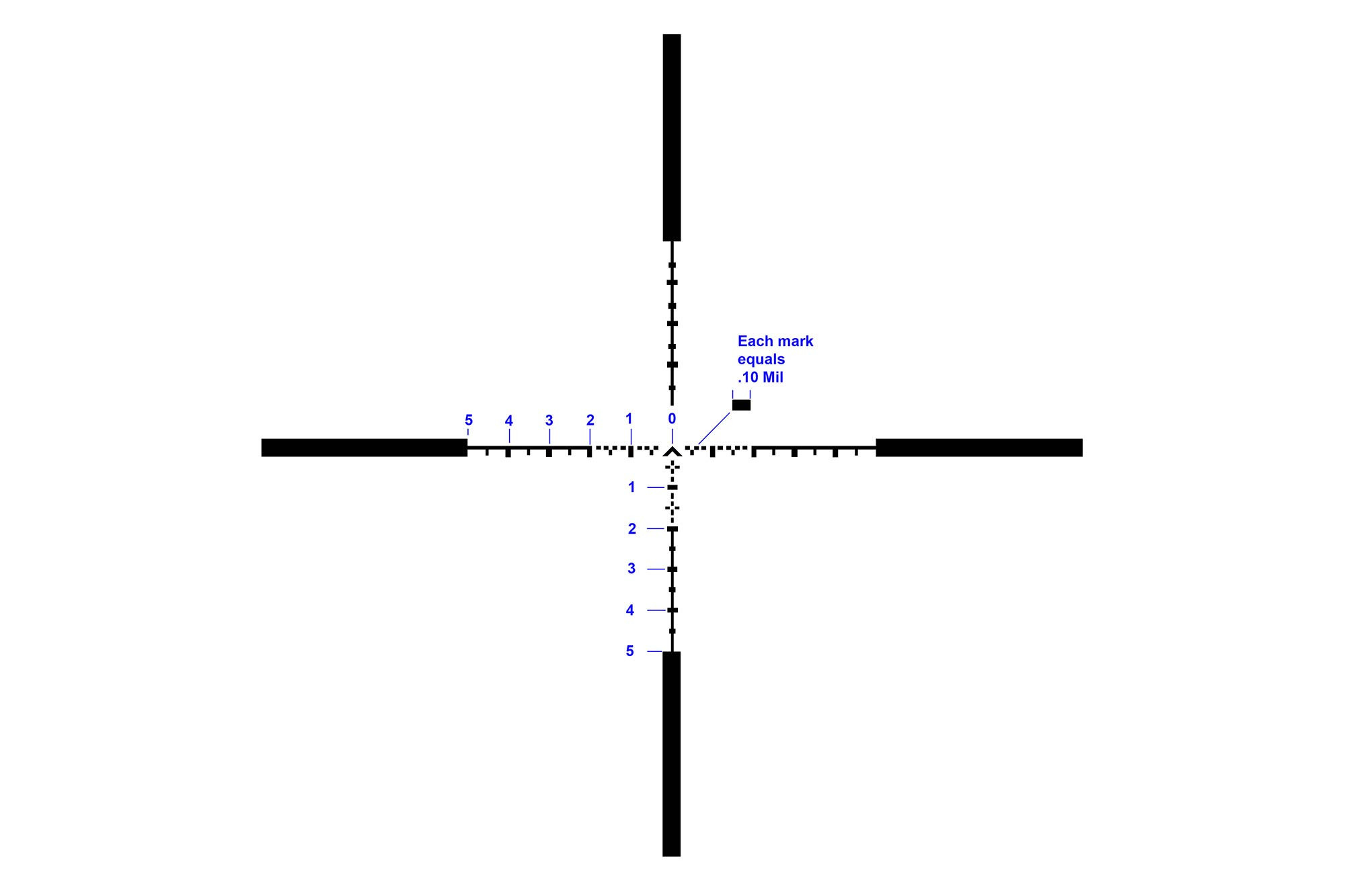

new Bushnell Deploy MRAD tree reticle:

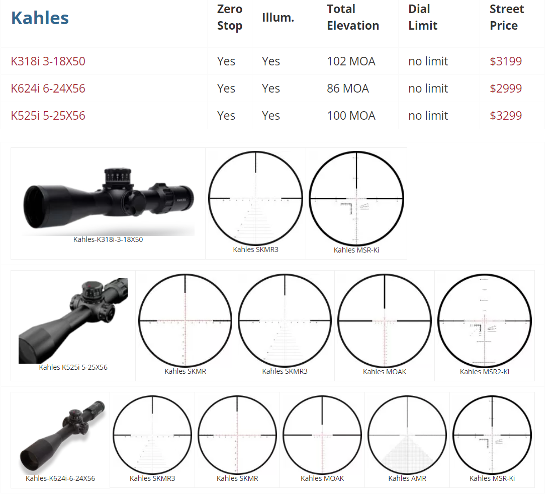

Sample screenshot of the list looks like:
