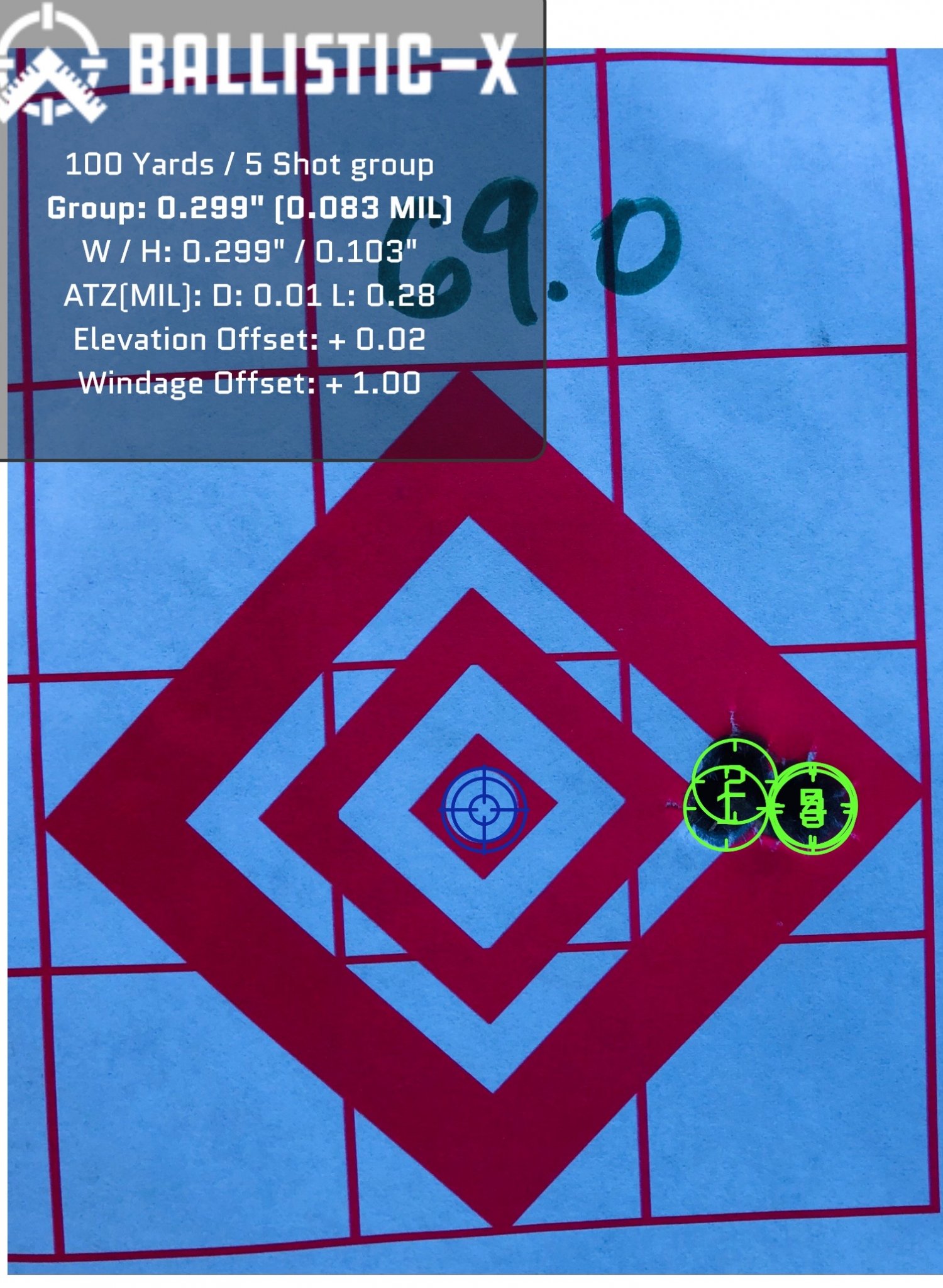

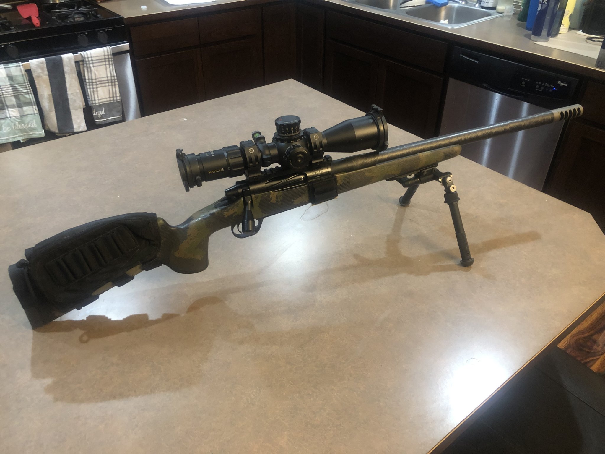

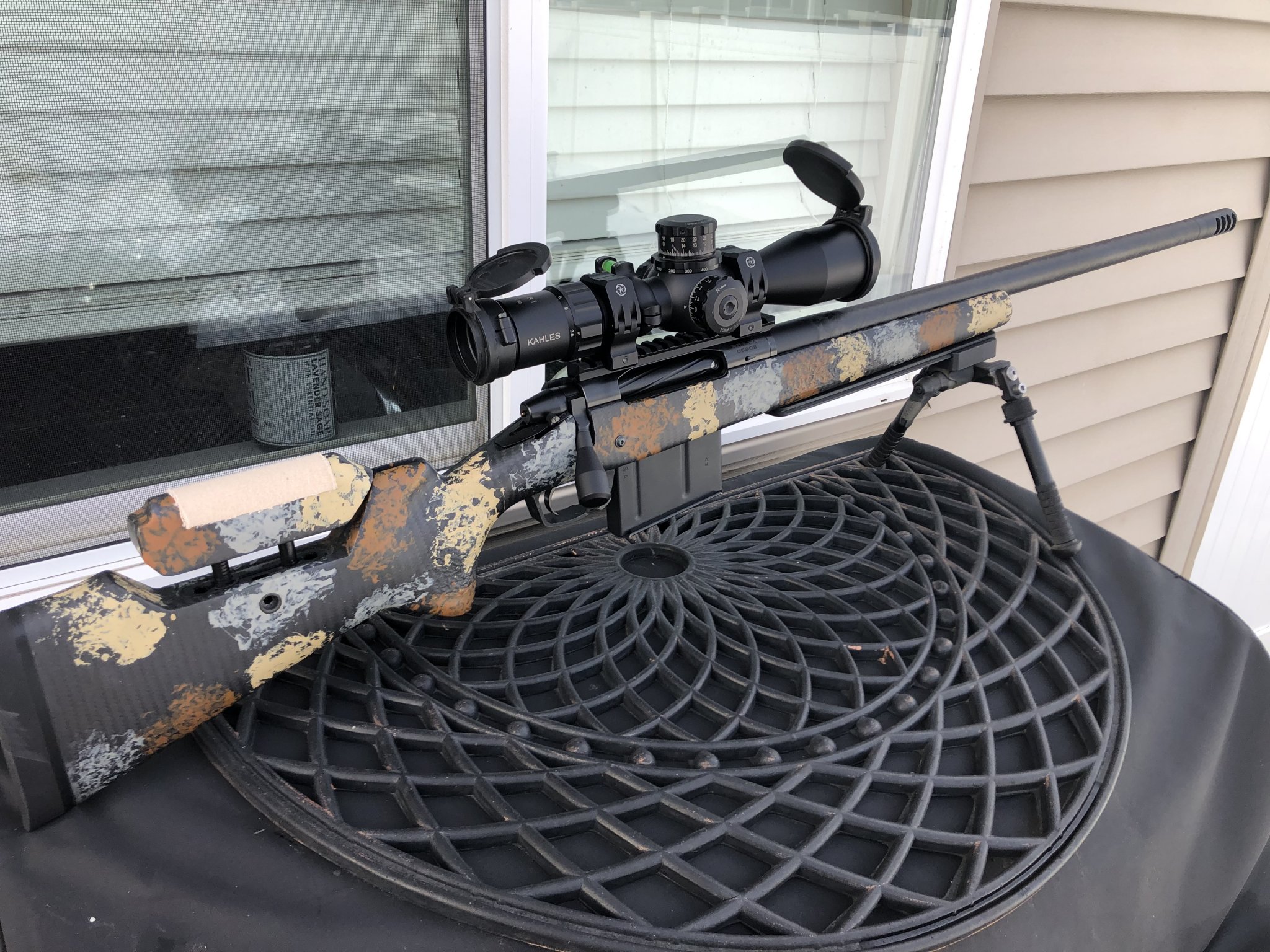

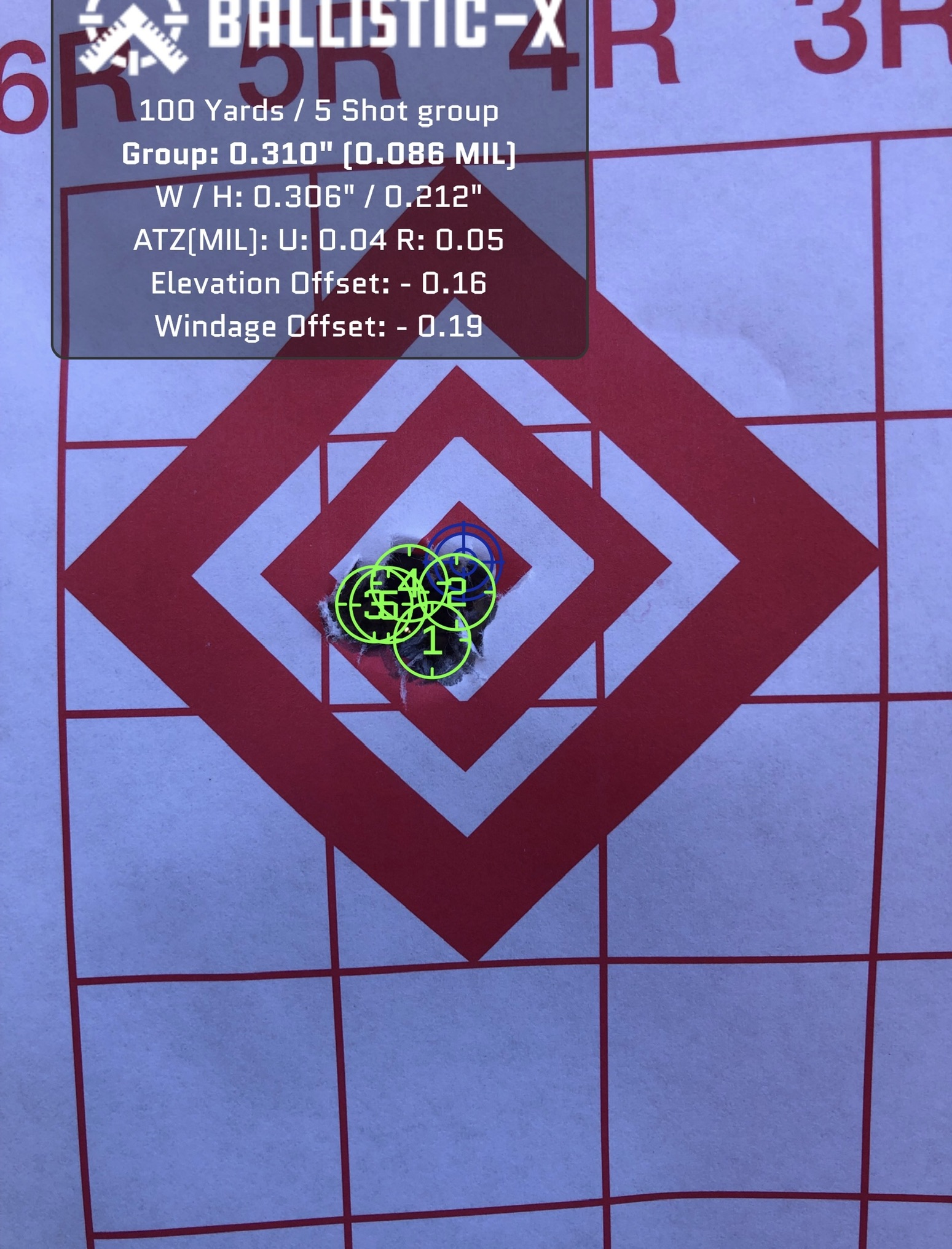

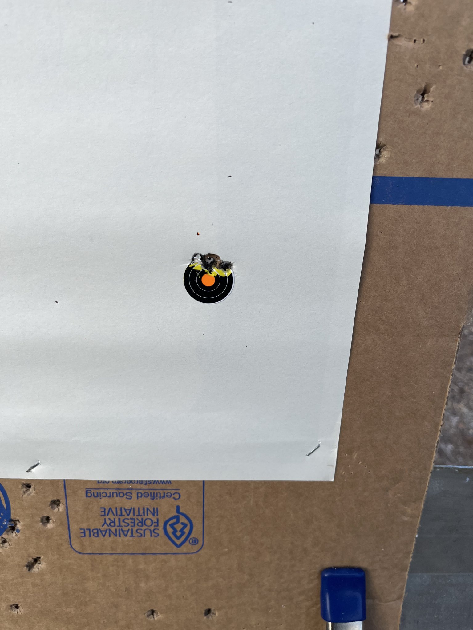

I have 3 rifles built on Origins with proof Prefits. Here’s a couple groups they laid down during lord development. Ones a 20” 308 running 185gn Juggerbauts and 44 gns Varget. The other is a 24” 7RM running 180 hybrids and 69gns of 4831SC
They shoot plus a the number of features and ou get with the Origin (ie Prefits and Caliber swaps via bolt heads) puts it heads and shoulders above and MPA build. I do like their Chasis though.
Grab a Viper or SAC Barrel Vise and a Zermatt Orgin Action wrench or one of SAC’s modular action wrenches and you’re gtg

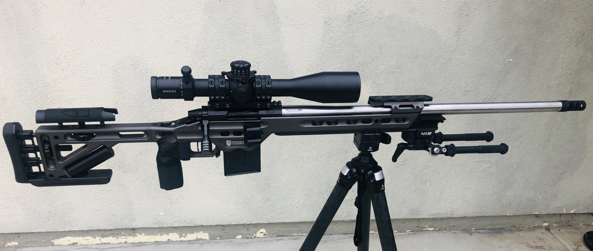

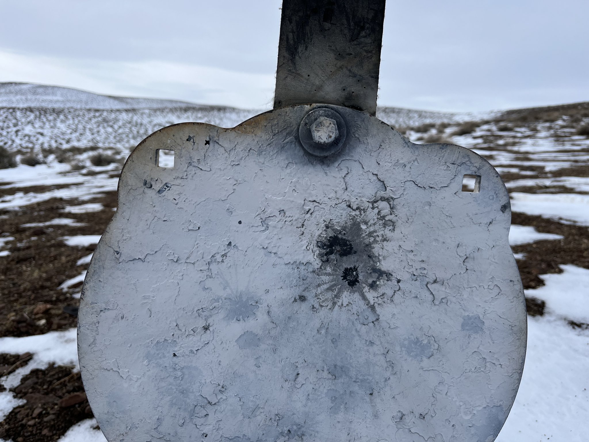

Honestly the MPA is way better. If you go that route I would pick up an impact action and bartlein barrel. The matrix pro chassis is the best chassis on the market in my opinion. MPA customer service is second to none. When I placed my order I called in to order over the phone. I spoke to the owner directly and he talked to me for over an hour to make sure I was completely satisfied with the options I selected.
As far as the gun goes, I have printed several .15” groups at 100. My hand loading is probably considered advanced, but still shooting .4 even with what I would consider rushed loads just using a powder dropper and not weighing to the kernel.

You’re not gonna see a difference accuracy wise. My Impact / Bartlien shot amazing. I currently have 3 rifles built
On Origins with Proof barrels and they hammer .2’s all day long.

.This is a $2499 ARC Nucleus shooting factory 140g ELDM's rounds 36 through 40...shot a match the next day and took 10th outta 18 shooters with no verified dopes, using shooter for dopes, first match after a 2 year break and zeroed one stage...my old ass just dont bend like that anymore LOL...needless to say I wont be reloading anymore.

Factory Hornady stuff shoots great. Just slow. It’s all a shoot through my 6.5CM. I was pretty surprised in the high SD’s and ES in the stuff I shot but it shot great none the less.
I don't even own a chrony anymore so I'm not 100% sure on velocity but dopes line up perfectly with 2720 plugged into shooter...this was a few weeks after the match at 425yds and I swear this is 3 rounds...this gun shoots and is not real picky. It shoots the factory Norma 143g Golden Target just about as good as the ELDM ammo.
