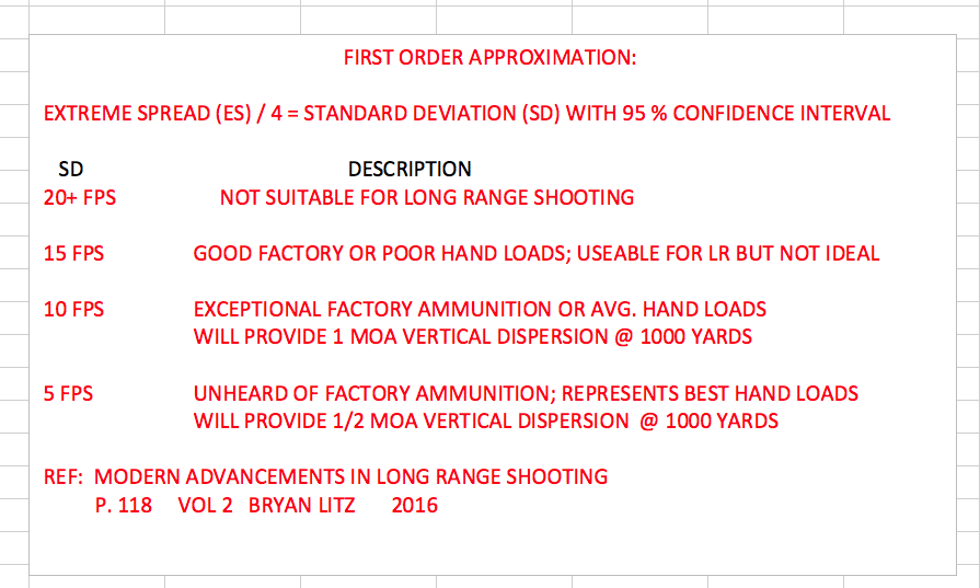

You will benefit from knowing the muzzle velocity of your ammunition and perhaps more importantly the variation in muzzle velocity shot-to-shot.
