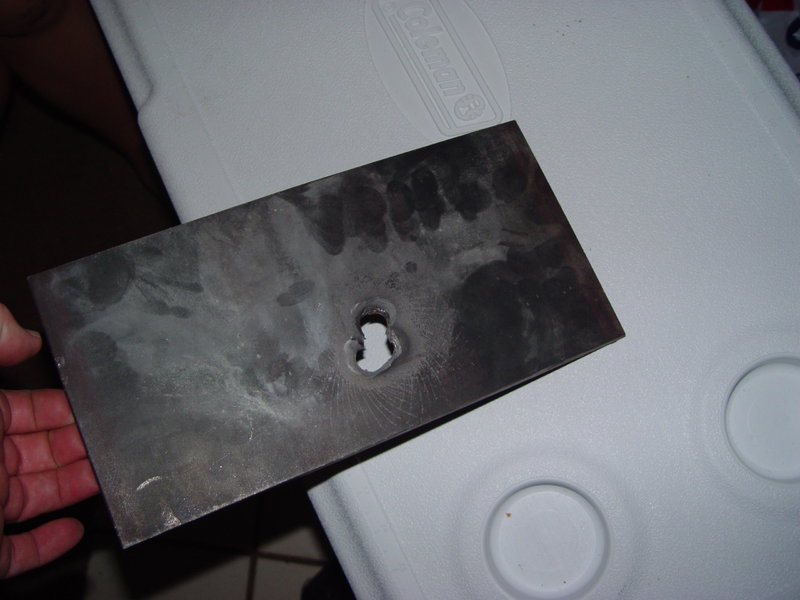

Pulled 690 AP sized on 5/8 A36 steel plate. 3 shot group at 300 yards. Beautiful sunny no wind day.

Have any of you had any experience resizing API, APIT or tracers? I've been reluctant to do so for fear of detonation. Is it safe to do? What chemical compounds are used in the manufacture of API and tracers. Are they sensitive to pressure?
