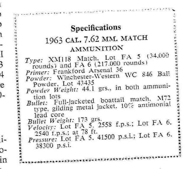

In the 60s the Army passed out annual handbooks showing the latest approved "Match" alterations and standards. This practice ended in 1968 when the Army stopped supporting the National Matches due to the JFK, RFK, and Martin Luther king assassinations.
There are no Army-wide National Match standards for the M16 or 5.56mm ammunition, nor for M9, M11, or M17 pistols and 9mm ammunition. Those are now set by the Civilian Marksmanship Program in their annual rule books for the National Matches. You can shoot these at Camp Perry:
A civilian manufacturer or marketer can advertise whatever he wants as "Match-grade," like Young Manufacturing's "National Match AR Bolt Carrier."
