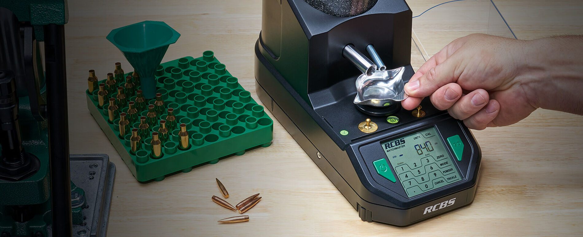

Matchmaster Powder Dispenser | Save $100
Team RCBS & Bushnell
    Hide - The RCBS Matchmaster Powder Dispenser is $100 off now through the end of July.
    If you don't have an account with us be sure to sign up for Emails and the site will prompt you for an additional savings. Itt won't stack on top of the $100 off on the Matchmaster, but will work on anything else you happen to add to your cart. Message us on here if you have any questions about that.
    We hope these will ship next week.

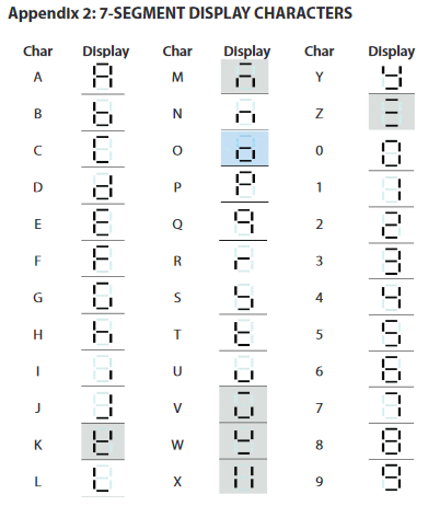

    I have one, I also confirmed accuracy with an independent scale, and I'm generally very happy with the product. I'm particularly happy as RCBS provides a very generous discount to anyone with a DD214 with an honorable discharge.
    There are, however, three minor points that make me wonder who the fuck designed this thing:
    1. The display requires a frakin table to translate displayed characters (well, some characters) into letters. This one really bugs the shit out of me....how added cost would it take for a display and driver to run a full character display that doesn't require a cheat sheet. Without referring to this table, I defy anybody to correctly read....for example....S, Z, K, Z, etc.
    2. My recommendation is to never use the little tube they give you to attach to the powder emptying port.....The first time it falls off (which is most likely the first time you use it LOL) will convince you to just hold the unit over a bowl or measuring cup to empty the powder reservoir.
    3. Who thought that the proper flow for entering a numeral for the powder used should be...enter the numeral...then press powder. In any GUI development that I was associated with, the proper flow would be to select the variable to be set (powder) and then the value for it (e.g. 1). Just silly, IMO.
    Now, I will say again....these are minor points. Annoying if you are an anal, complaining asshole like me....but I do wonder wtf did the design reviews on this thing?
