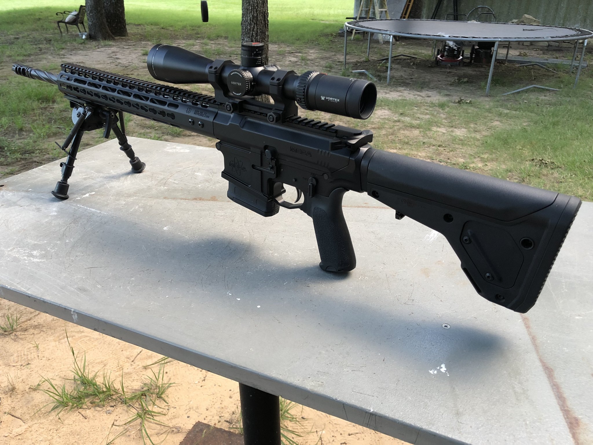

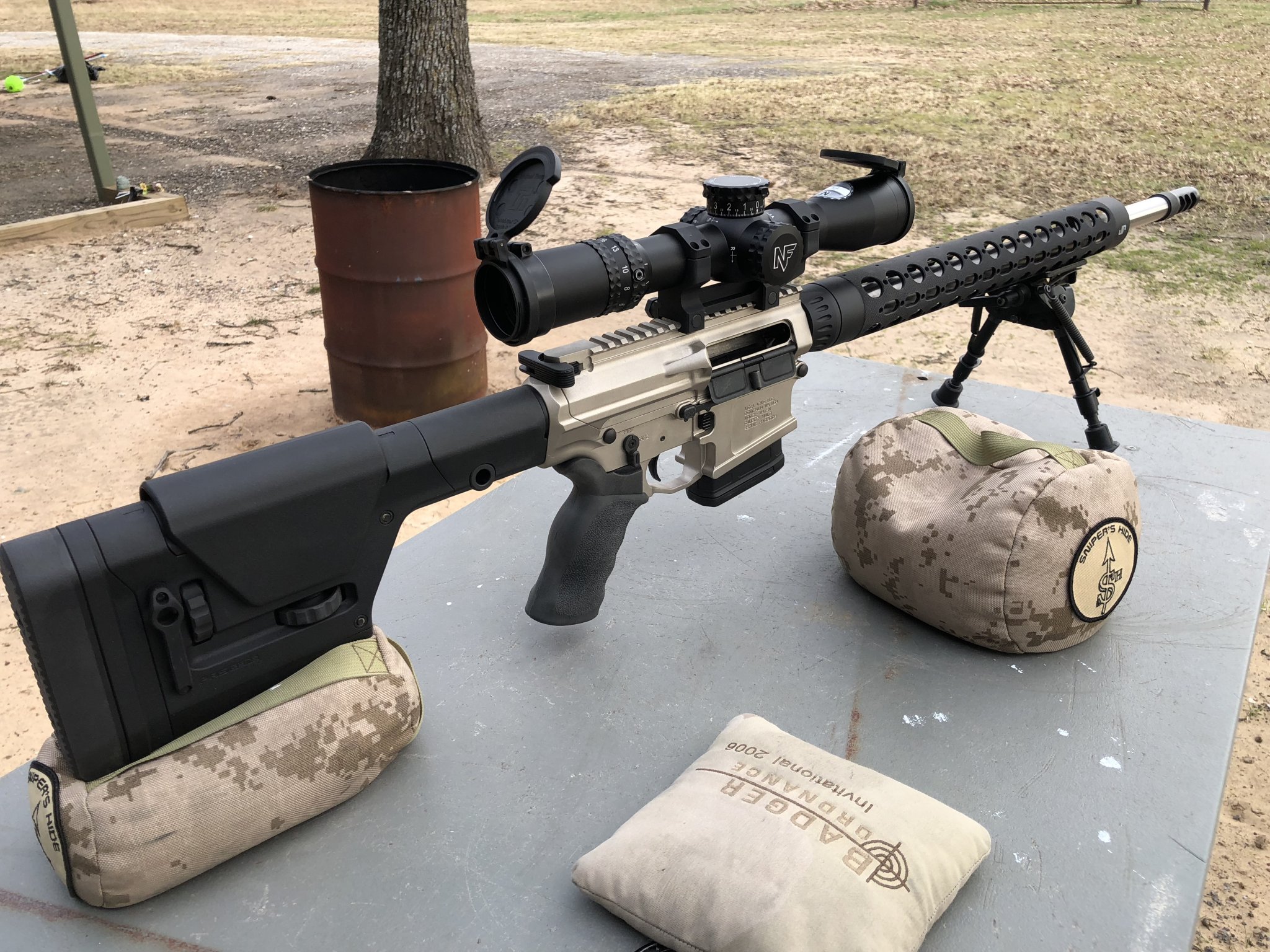

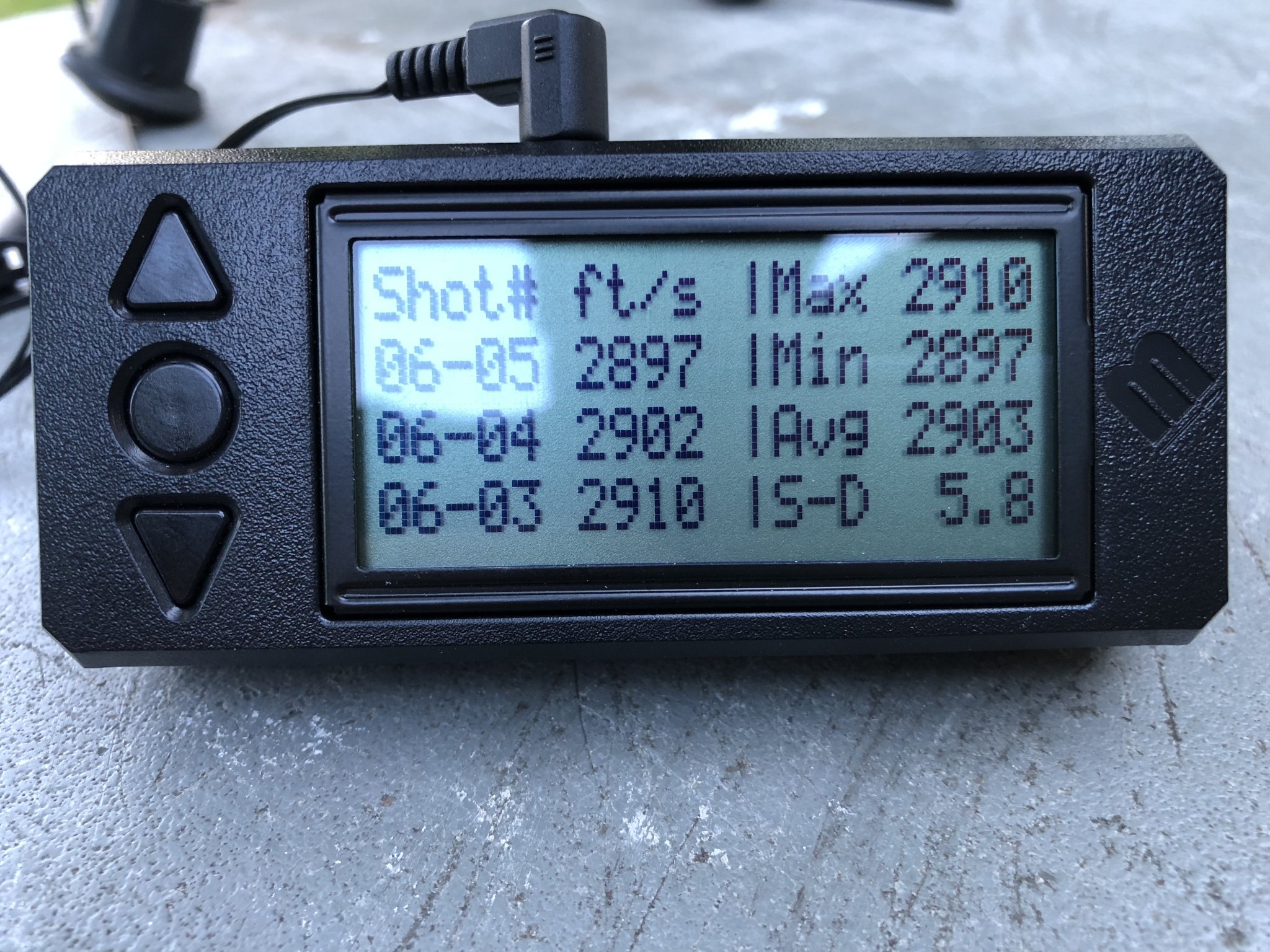

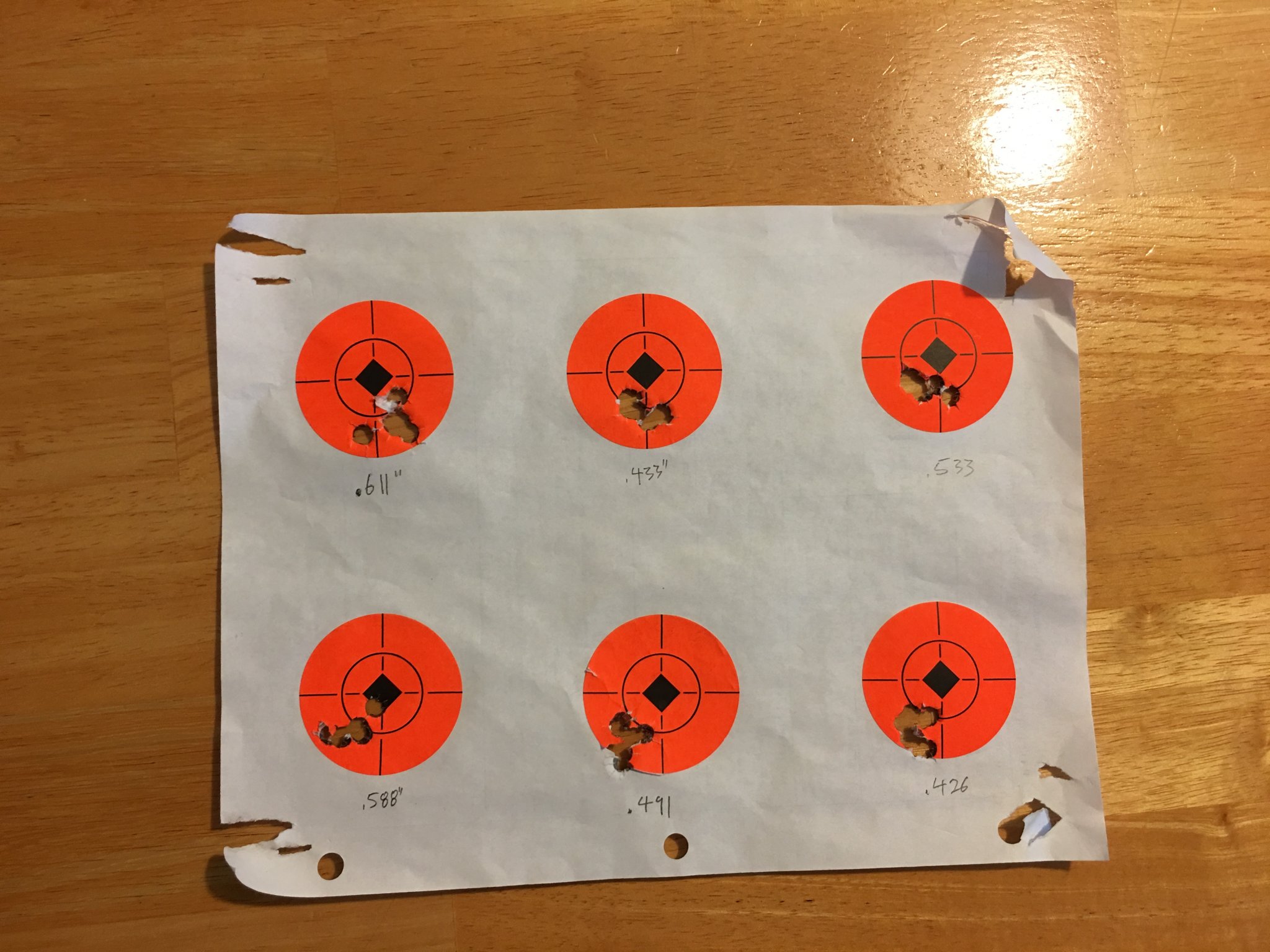

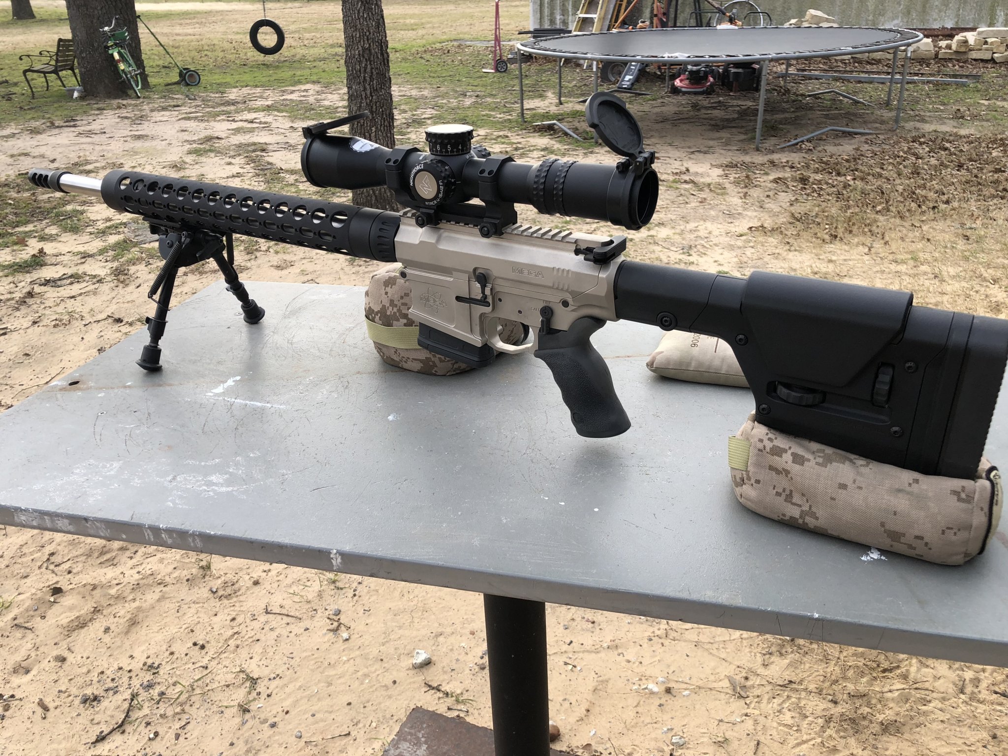

It’s very easy to just go grab JP and bartlien but buy once cry once reaches a point of diminishing returns. Any time I put a rifle together I try to find the edge of that line. I just finished a Maten 6.5 and couldn’t be happier after having it out once.

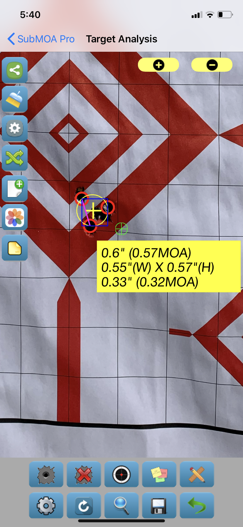

First time out with a couple of random 142 smk loads. (that’s 5 rounds I just didn’t mark the two inside the group edges)
Ballistic Advantage heavy profile premium series was on sale for $160 so I had no choice here but to try it.
Toolcraft small firing pin BGG was about $160 I think, I can’t remember. Either way it was way cheaper than JP or other premiums. The standard firing pin version was even cheaper.
Both barrel and bcg came from Arm or Ally...ridic good prices.
RRA 2stage and JP reduced pwr spring was $110 (I did have to do work on this to get some creep out and get it perfect but it was simple, a few minutes with a very fine file. The one on my Valkyrie was perfect out of the box).
Yes when you try to find the edge of buy once cry once you do have to be prepared to troubleshoot. I’m a tinkerer so I don’t mind that. But I probably saved $600-$700 over just phoning in bartlein/JP/gesielle.
Those are great brands and I have no doubt they will shoot tiny holes. But I have always found it incredibly satisfying to put together 1/2 moa rifles for much less than what is typically spent.

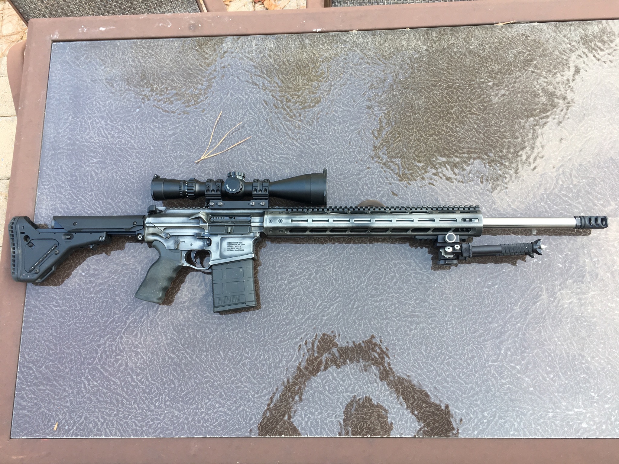

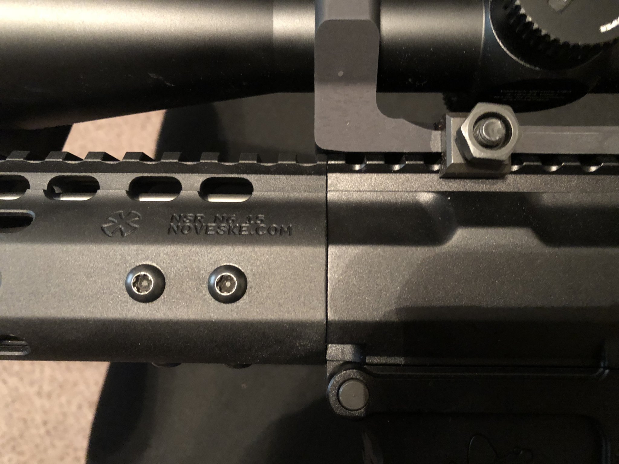

This is my Mega Maten 6 Creedmoor.
I’m using the following parts.
Spiral fluted 7.5 twist Bartlein by Craddock Precision, Superlative Arms adjustable gas block, VG6 Epsilon brake, 15” Noveske handguard, JP, FMOS carrier and high pressure bolt, Magpul Gen 2 UBR, H3 carbine buffer, Sprinco red buffer spring and Geissele SSA-E.
I originally intended this to be a budget build but may have gone over a little. I did find most on sale and got the barrel here on the Hide, slightly used.

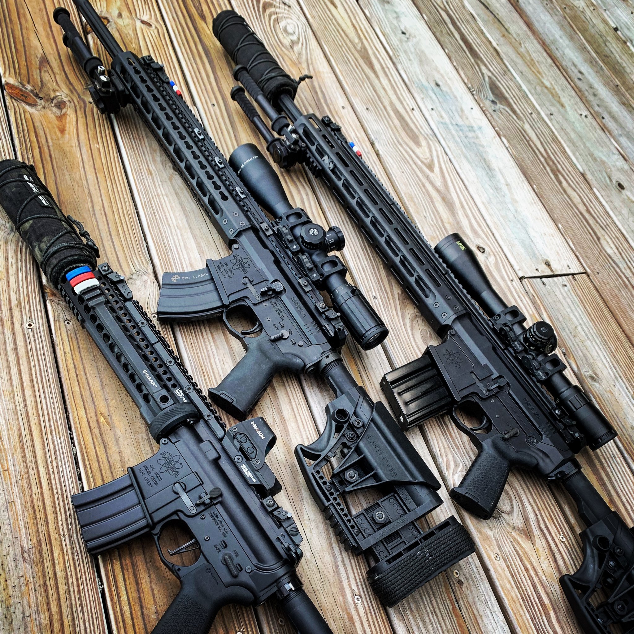

This 6.5 is from Keystone Accuracy and has a 17.25 JP Rapid Configuration handguard, SA gas block, JP LMOS with high pressure bolt, H2 Silent Captured Spring, PRS stock, Geissele SSA-E and an Area 419 Hellfire brake.
Love me some Mega Maten.
