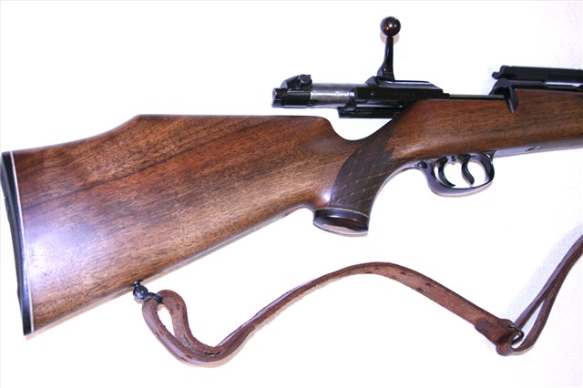

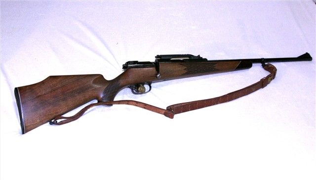

pix708086845.jpgpix746377764.jpgAnyone ever made a sniper out of a Mauser model 66. I have a chance to buy one in 30-06. I was wondering if anyone has a knowledge base on this older rifle. Thinking about buying it and taking it to the shop and seeing how it ticks. This gun comes in three flavors small bolt (223), M bolt (30-06), L bolt (375) and everything else that fits between. In short this gun can change barrels on the fly. Kind of expensive rifle in its day. Anyone know if AI makes a stock for it? There web sight is down at the moment.
Thanks
Rich L
