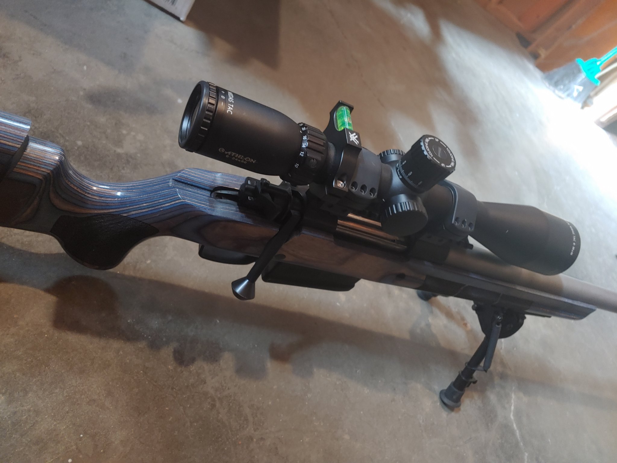

I ended up going the Boyds route. I pillar bedded the rear action screw with the steel pillar tube from an old military stock I had laying around. I opened up the barrel channel with dowels and sandpaper (huge pain in the butt) and then bedded the action to it with marine JB-Weld (marine-tex was too hard to find around here)
Its currently wearing a Shilen barrel and is chambered in 7mm RM and it shoots pretty damn well. I will eventually snag a PTG bottom metal and have it inletted to allow me to run AI pattern mags.
Heres a photo of the original mock-up with the new stock, before I did all the work.

Boyds varmint adjustable cheeck. Have to open barrel channel up on bigger barrels. 5 shot group at 100 yards shoot this rifle at 1000 alot and shoots lights out with stock. I found it to be the best and cheapest route for mauser 98
