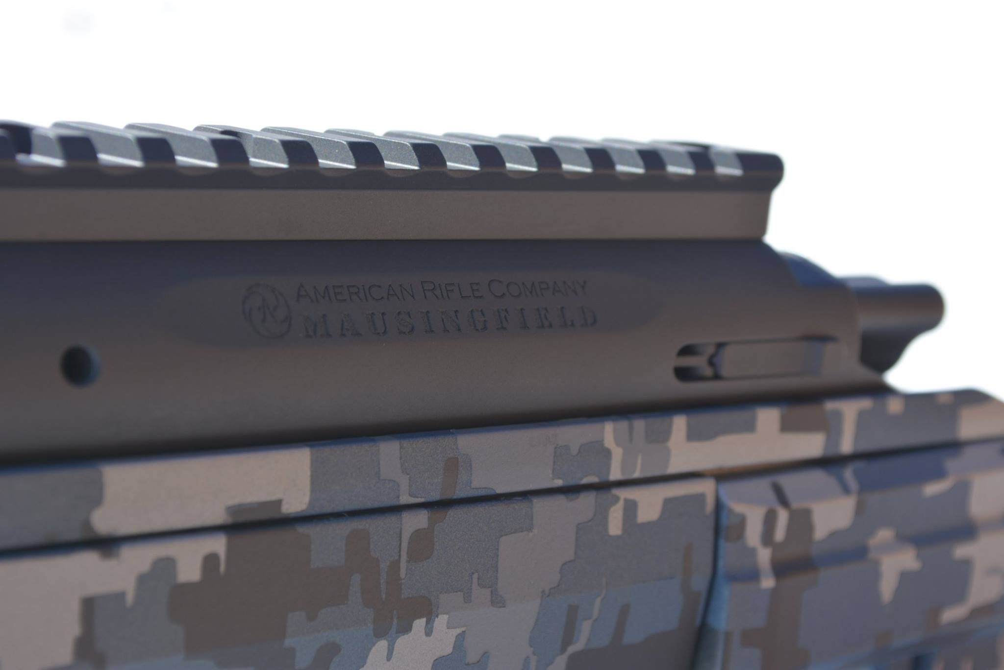

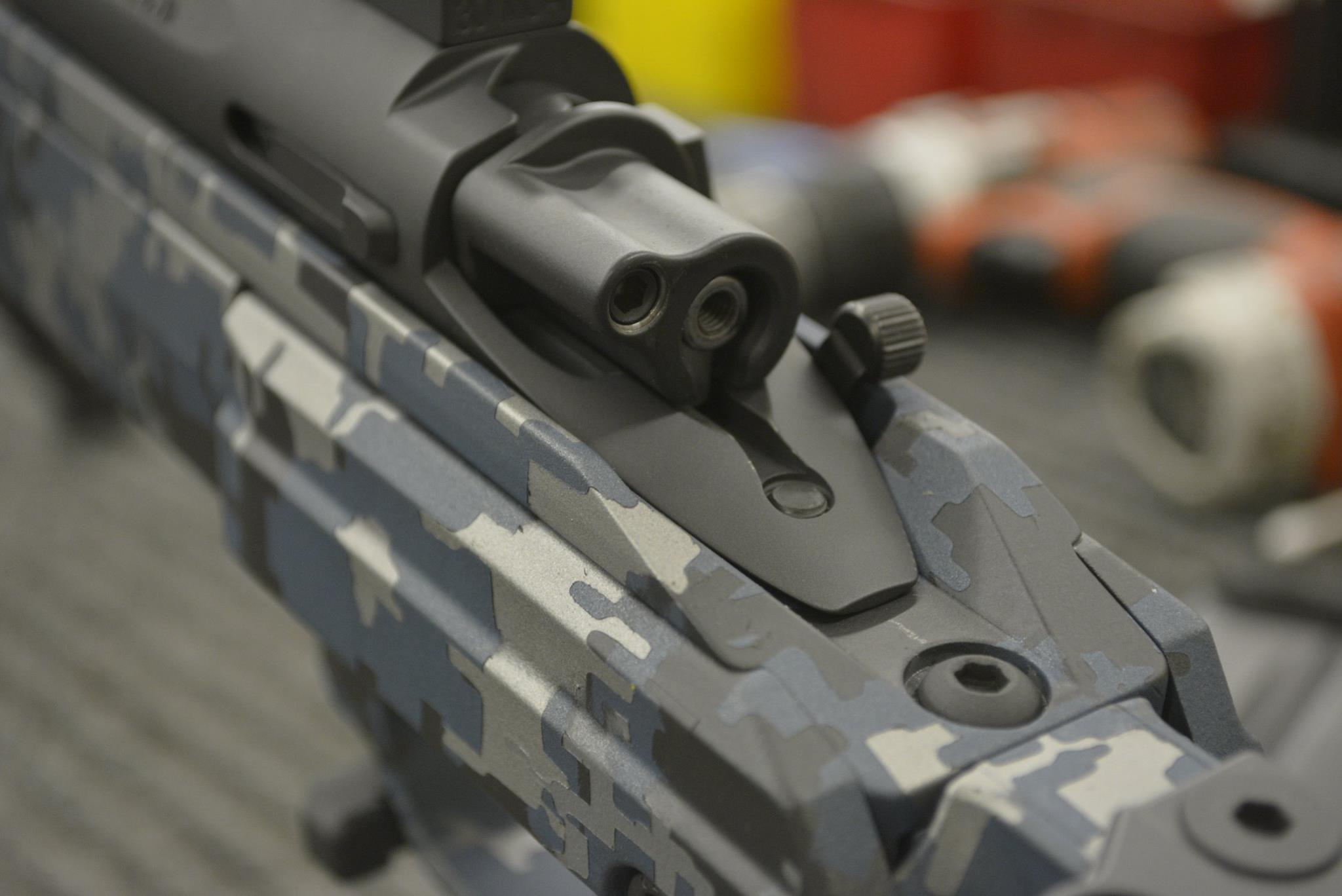

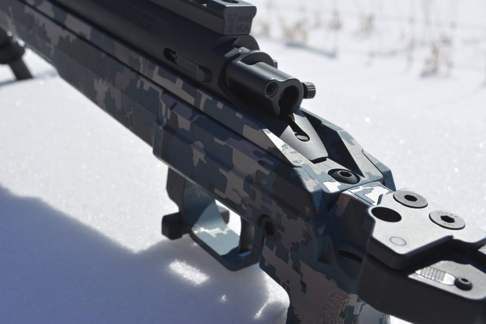

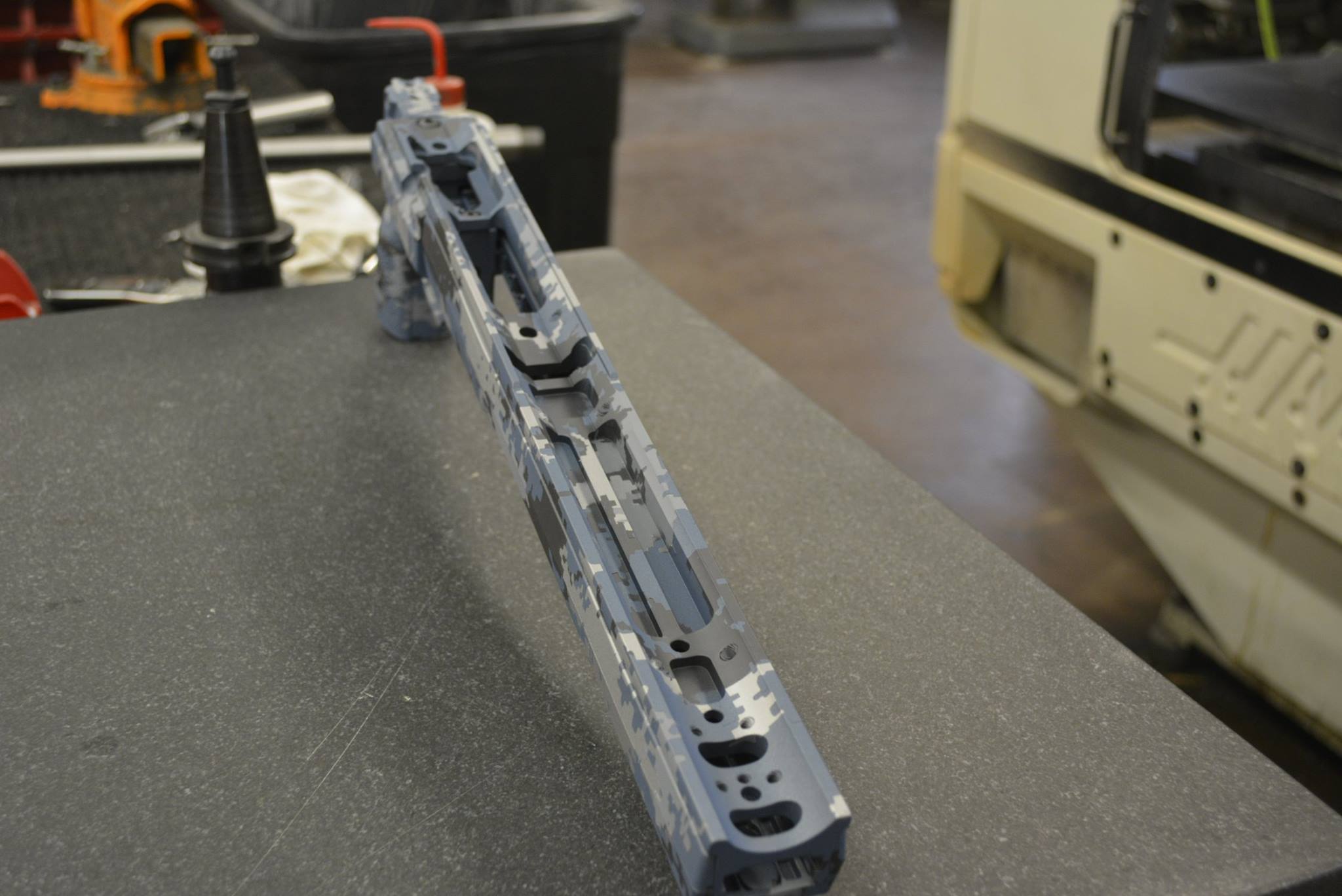

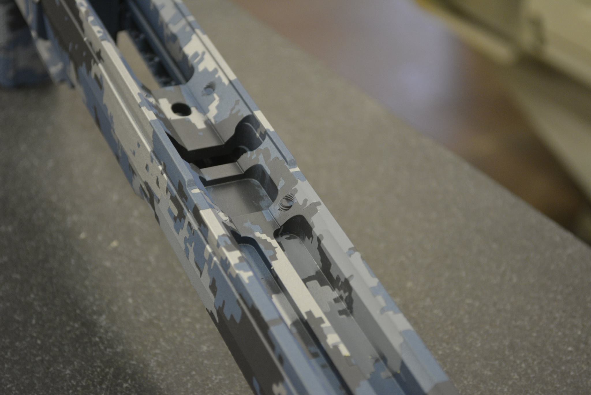

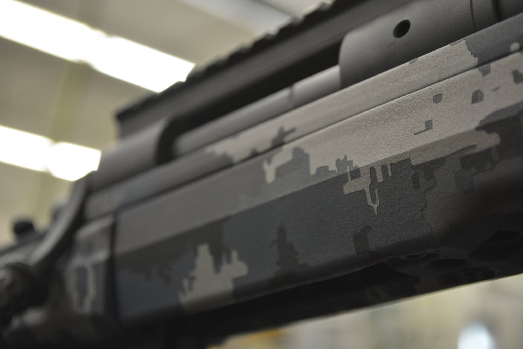

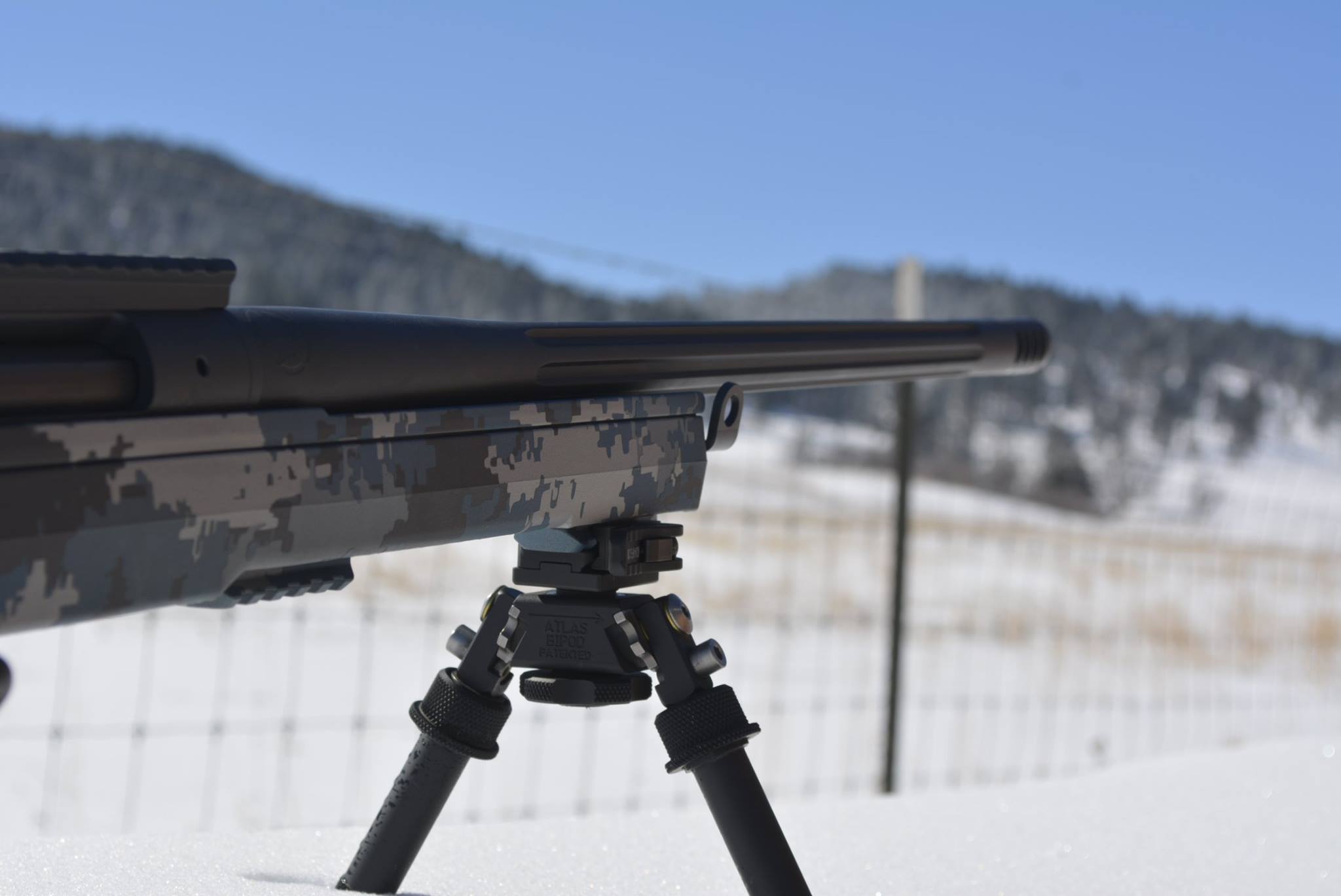

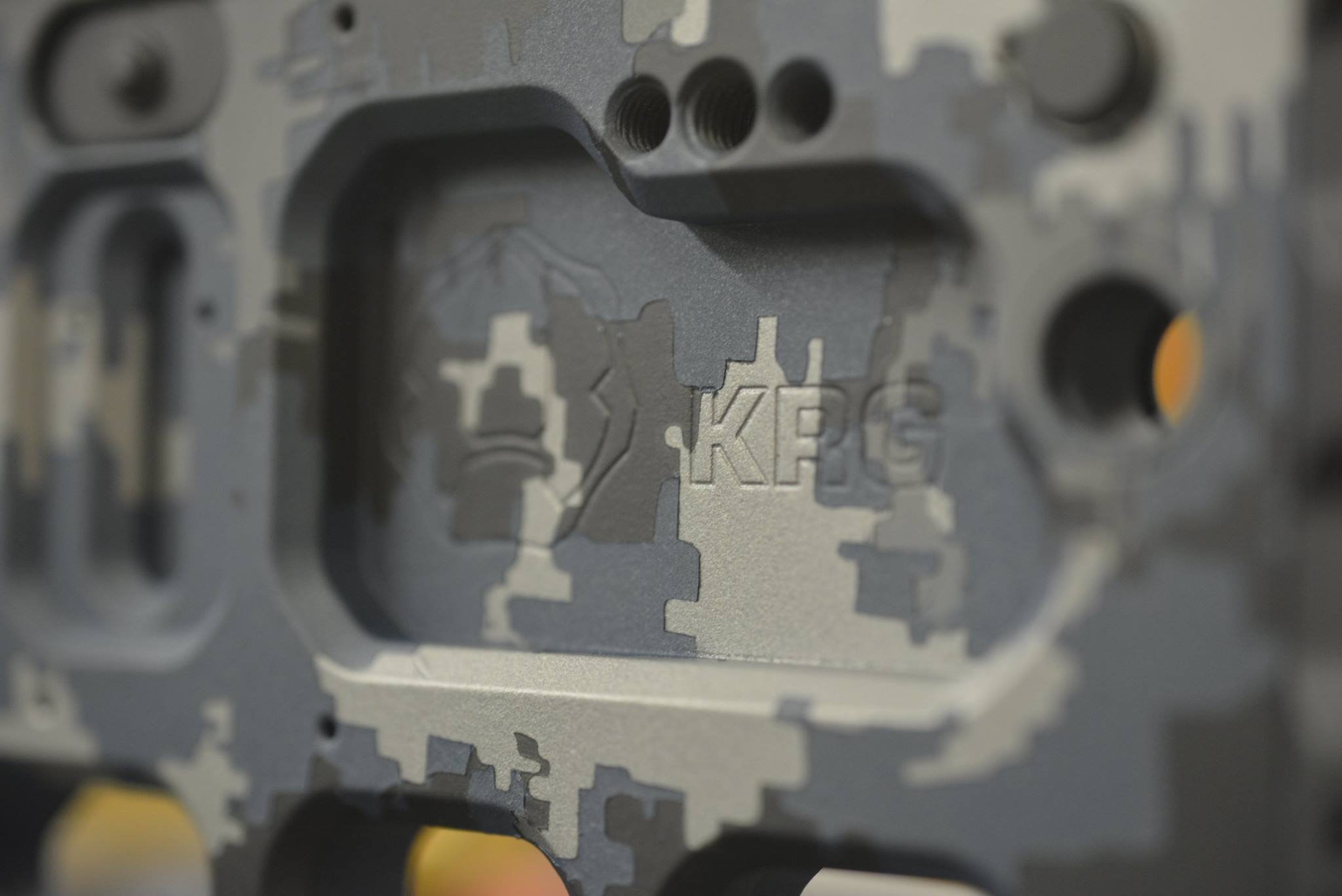

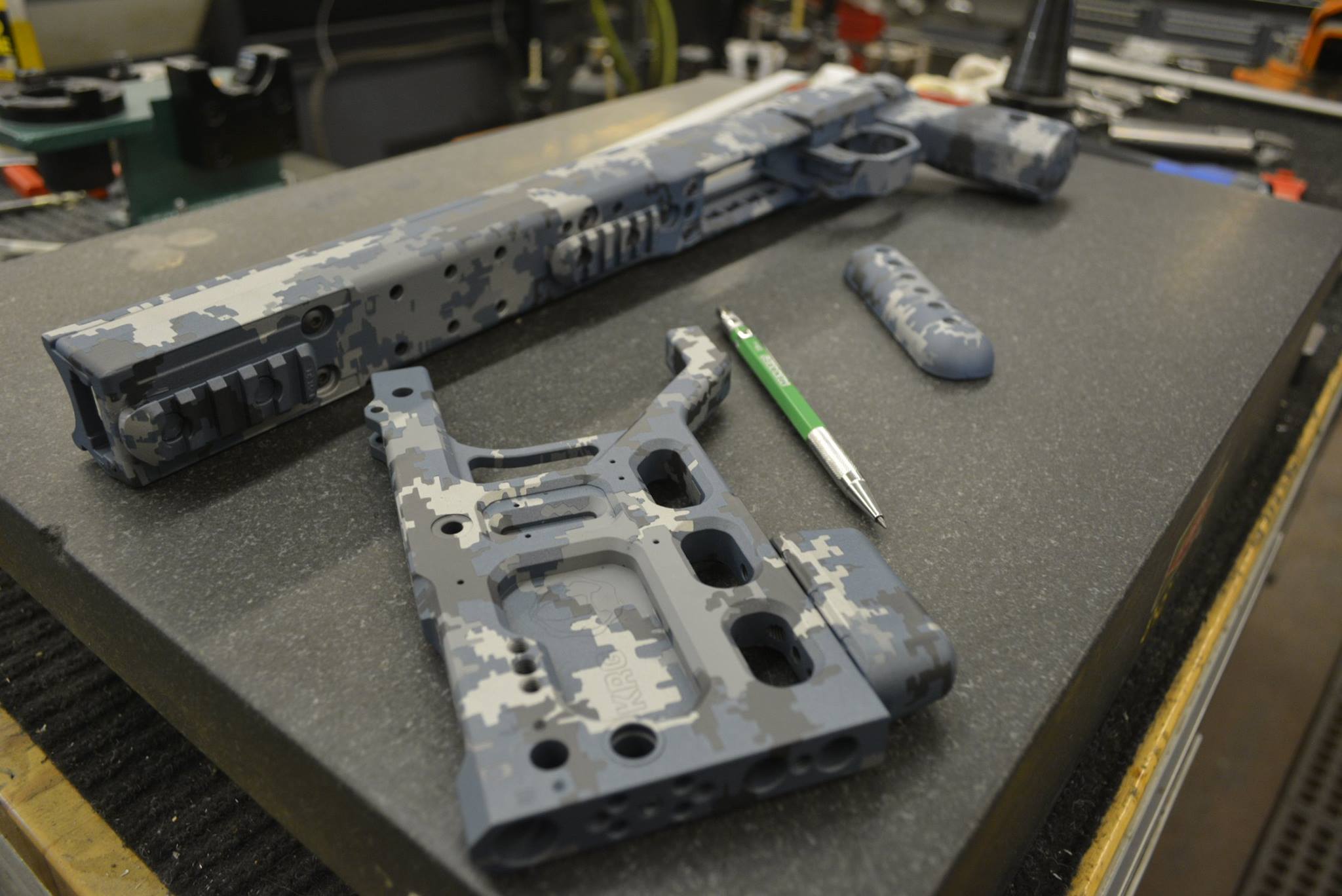

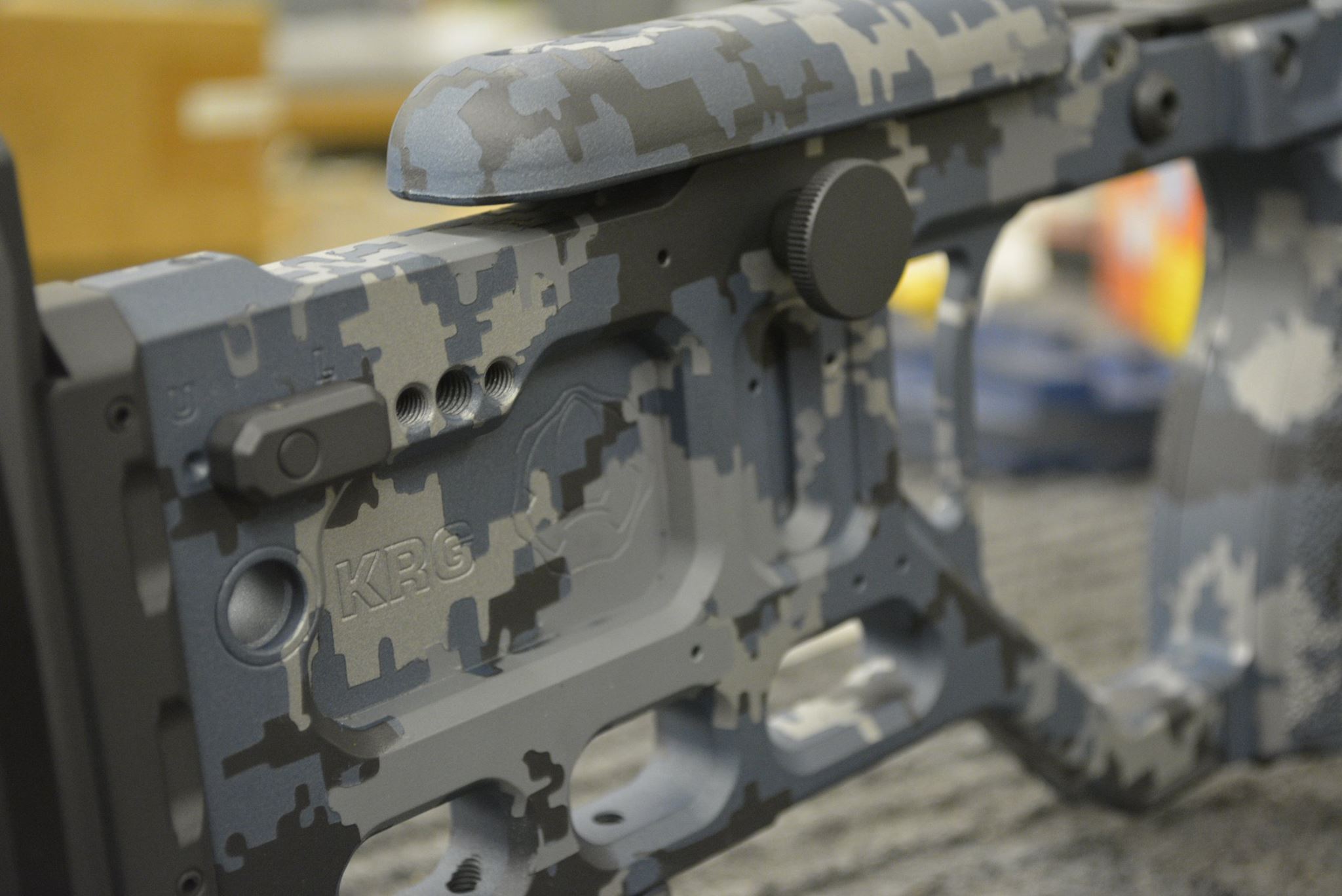

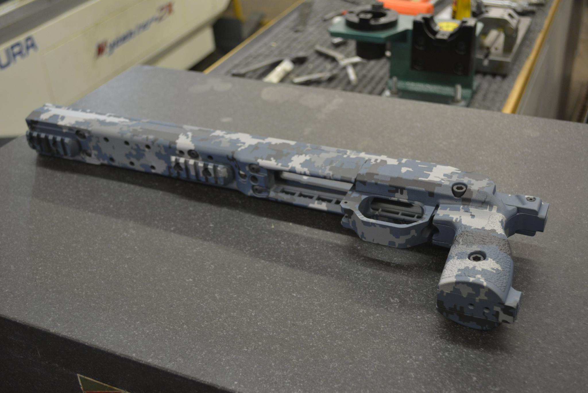

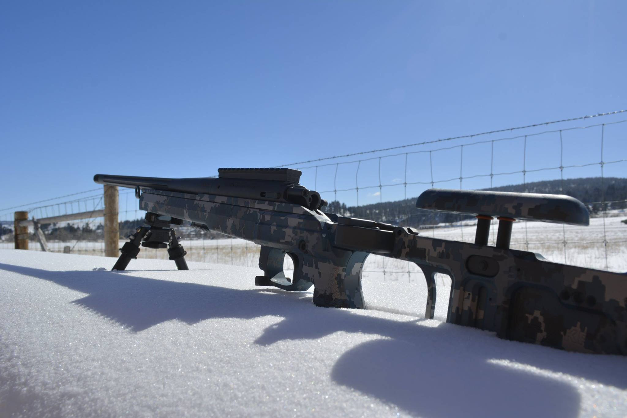

I have a MF in a W3 and one in a X-Ray. I also have a Archimedes in an X-Ray and don't have any issues.
The only trigger I have run into problems with is the Tubb trigger. There would need to be a fair amount of inletting for that to fit. All the other standard triggers work great from TT, Jewell, Timney, and all the rest of the standard R700 foot print.
The one's we've done have all worked out very well. KRG makes a nice piece.
This one shown belongs to a HillBilly living under an apple tree somewhere in Washington. I'm pretty sure he's humped at least one of his cousins. :)
