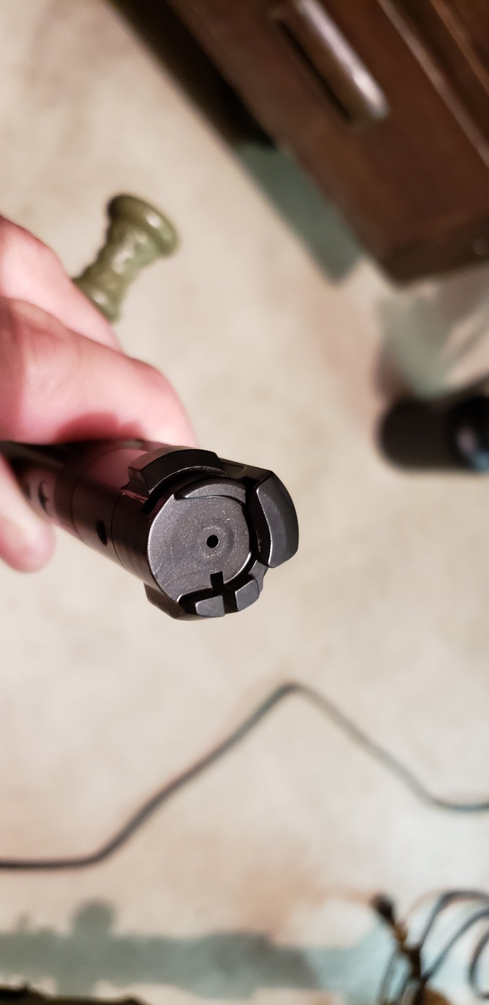

Hoping someone can help me out here. I have a 400ish serial number M5 action with DLC and the bolt always seems to get stuck right at the top of the bolt lift when the rear cam starts to engage the bolt handle. It requires a decent smack upwards to finish taking the bolt out of battery. I have tried 4 different kinds of brass, light loads, oversized the brass slightly, lubed everything, playing with head space in and out +-.002 and nothing seems to make it open any easier. Rifle has had about 700 rounds through it now and at least 1k dry fire cycles. Has anyone else had this issue or have an idea where to start? I have reached out to ARC but thought I would try here too.
Thanks for your help
