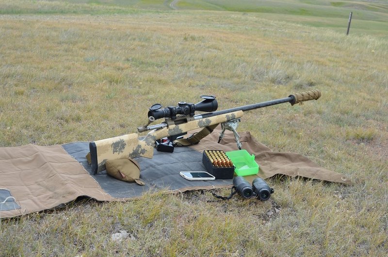

    The rifle:
    American Rifle Co. M5 Short action w/.525” (magnum) bolt face
    Proof Research 28” 1:8” twist 6.5mm SAUM, 5/8-24 muzzle threads
    Chamber is the .296” neck 0.081” freebore flavor from Jon Addis’ shop at Area 419
    Trigger Tech Trigger
    KRG X-ray chassis
    ARC M10 30mm Low rings
    March 3-24x52mm, FML-1 reticle
    Vortex 30mm level
    Harris BRMS 6-9 swivel bipod
    SRT Arms Shadow XL Ti .30 cal suppressor (sometimes)
    Weighs in at ~12.7lb without the can (plus a pound with it)

    And a picture with the new Manners EH1. I work at a place that deals with composites testing... I'm going to see if I can scrounge up some scrap carbon fiber and lay up a cheek riser.

    Hey there, sorry I missed this one. I do have a few updates:
    1. I had the 6.5 SAUM barrel taken off and modified for use with a Barloc. Just pushed the shoulder forward .585" so the Barloc can fit in. The rifle is now a switch-barrel setup with this barrel, a #4 contour Brux 6.5 creed @ 21", and a 16" 1:8 twist .308 (for subs and tracers and other tomfoolery).
    2. I did some target shooting this summer, and shot the rifle in a smaller local match and did pretty well, placed 3rd overall (25-30 shooters). Right after this match I chambered up the 6.5 Creedmoor barrel and kind of put the SAUM on the shelf. I am now in the "final" lot of bullets, so it should be the same lot all the way until I run out of 140's.
    3. I did notice that my groups were opening up before I pulled the SAUM barrel and started playing with the creedmoor. So today I got a wild hair, swapped back over to the SAUM, and loaded up 5x each, all @ 2.860" COAL. (2.835" to the lands now).
    60.6gr H1000 (original load), .770" group
    61.0gr H1000 .420" group
    61.3gr H1000 .570" group
    So tonight I'm going to load up 85 of the 61.0gr load and maybe get out tomorrow after class to nail down zero and velocity, get Hornady 4DOF updated, and bang some steel and maybe prairie dogs.
    4. I've switched over from Trasol to Hornady 4DOF. On that note, IMO if you're shooting a bullet in their 4dof library, you really might want to use their app. I especially like the zero-angle feature vs. zero distance. I've had a lot of success zeroing at 1800ft then shooting at 2700 and 5500 ft and the app "covering" it very well (read: spot-on). When I shot my 6.5 creedmoor at the Vortex Extreme this summer I zeroed in Nebraska at 1800ft, then went straight to 5500-6000ft in Wyoming without checking zero and was nailing things (1st round hits out to 1210yd). Kept the same zero and came back to the Black Hills in SD and have been tracking. Almost all my misses are left or right side of the target (wind speed errors). Anyway, I digress. Suffice to say I'm very happy with the app, and it's FREE.
    Anyway I'll report back in next time I shoot the SAUM (hopefully tomorrow). I need to double check, but I'm pretty sure I'm at or very near the 1000 round mark with this barrel now.
