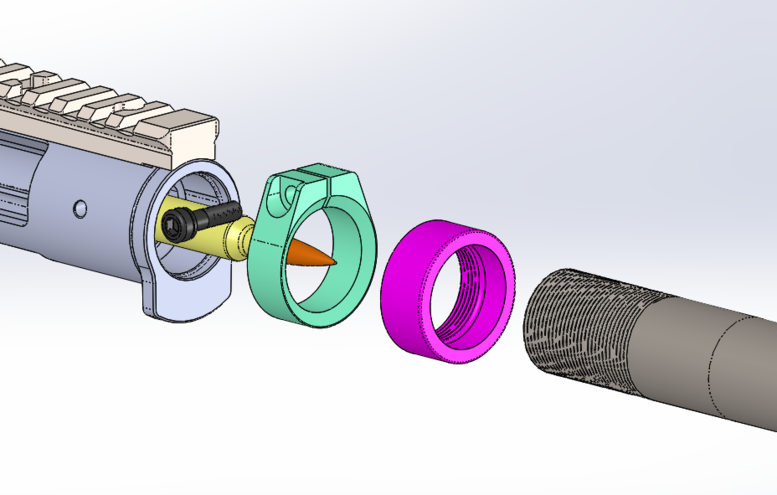

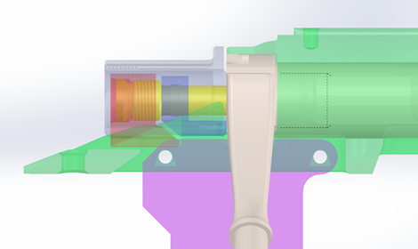

All,
Chad from LRI made me aware of this post. After reading it, I can understand the desire for a barrel that is easily removed and replaced. I also think that I need to answer some questions about the use of the Switch Lug with a Mausingfield action. It is true that modifying a Mausingfield action in any way essentially voids the warranty. This policy exists for at least the two following reasons. First, it encourages the customer to contact me before doing anything to the action. The Mausingfield has been revised more than once because of good customer feedback. Secondly, the receiver of a Mausingfield is rather hard and difficult to machine. This is especially true for those who are not manufacturing experts.
That said, I do not recommend modifying a Mausingfield for use with the Switch Lug. Drilling holes parallel to the length of a Mausingfield receiver would require that the entire action assembly be tested for safety, and I have little or no confidence that it would pass if such modifications were made to the receiver. Holes drilled into the face of the receiver will undoubtedly result in stress concentrations that could potentially lead to fractures. I realize that many receivers have been drilled in order to pin recoil lugs but Mausingfield receivers were not among them. I would not recommend doing this to any receiver unless appropriate tests have first been conducted.

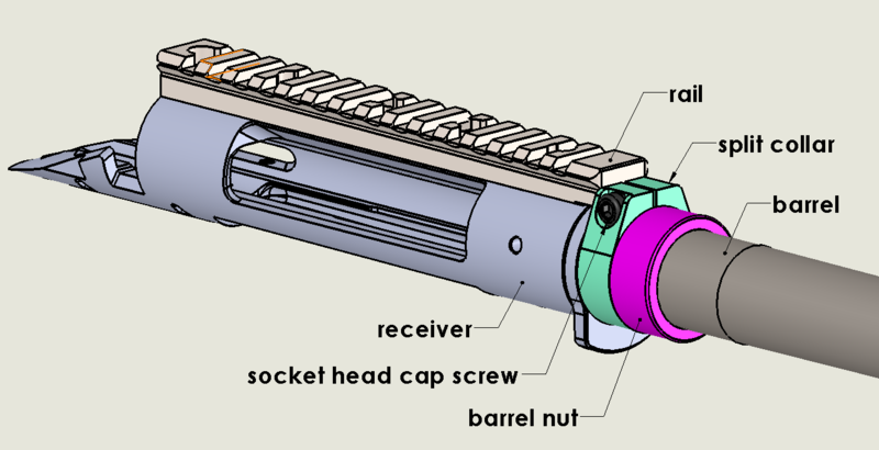

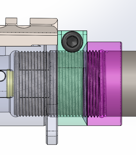

Now, in the spirit of competition and innovation, I can offer what I think is a properly designed barrel thread locking devise. Have a look at the pictures below.
The devise consists of a split collar and a nut. Encircling the bore (hole) of the split collar is a shallow conical seat against which a conical, spherical, toroidal, or otherwise axi-symmetrical form of the nut will come to bear. The screw of the split collar can then be tightened and thus effectively pre-load the barrel thread thereby immobilizing the receiver and the barrel with respect to one another. The advantage of such an arrangement over the Switch Lug is that it does not require one to drill holes into the face of a receiver. Additionally, it significantly pre-loads the barrel thread because as the split collar's screw is tightened, the collapsing action of the split collar's cone forces the barrel and the receiver in opposing directions with tremendous mechanical advantage. Threads are meant to be pre-loaded for multiple reasons, the least of which, in this particular application, is not the preservation of the positional relationship between barrel and receiver/scope.
Assembly is easy. Simply screw the nut onto the barrel thread as far as possible ensuring that the conical (or more generally, axi-symmetrical) seat of the nut is facing the receiver. Slip the split collar over the barrel thread so that the cone (countersink) is facing the nut. Screw the barrel into the receiver until it comes to stop against a go+ gage. Ensuring the the screw of the split collar is loose, turn the nut back towards the receiver so as to firmly sandwich the split collar between the receiver and the nut. Doing so should cause the split collar to open by a small amount. Finally, tighten the screw of the split collar to pre-load the barrel-receiver joint thus completing the assembly process.
I will have the first parts in hand within the next few days at which point I will post a video of the assembly and dis-assembly process. After that, we'll head to the range and see if we can shoot some tiny little groups. All parts have been designed to work with Savage pre-fit barrels having a 1.063-20 UN 2A thread approximately 1.500" in length (standard savage small shank.) I have also designed variants for barrels having shoulders.
Ted

All,
Ted
Hahaha, we have something like that coming as well. We've been refining it and added a couple twists but it's the same functionality.
Justin
Ted,
That is pretty cool! What would be the advantage of this system over a standard Savage barrel nut. It looks like for disassembley the collar and nut would come off with the barrel or fall free from the action. Would a person be able to remove or install a barrel with the receiver still in the stock?
What are your thoughts on simply screwing a shouldered barrel into a mausingfield and torquing it to 40 ft/lbs?
Silas
Ted doesn't make it a habit of frequenting The Hide so maybe I can help on this one. Advantage might be a bit aggressive. From a terminal performance perspective I don't think one outshines the other. We spoke on this topic almost 2 years ago now and the consensus then was more about convenience. That's really where this assembly starts to out pace the others. Go gauge and a single allen key; That's all a guy needs.
Personally, I think its pretty Soviet in appearance. That's my opinion. I feel guns have grown ever more distant from the elegance the makers once worked so hard to deliver. Today's vibe strikes me more as like a scene from Call of Duty.
Well, I like the ARC barrel nut / split ring.....A lot in fact.
Here is what I really like about it, the fact that I can switch barrels without a complete tear down (minus removing the trigger). I could literally do a barrel swap in the field, not that I "need" to, but that I can. I find I switch barrels a couple times a month, depending. This system facilitates barrel swaps with nothing more than a go gauge and allen key, no barrel vices, action wrenches, etc. Plus it is done correctly; tensioning the tenon threads!!
I am a materials guy by trade, specifically metals. I dont like thin wall thicknesses, especially at near thread valleys. Thin metal + cyclic life cycles = weak areas. To pin a recoil lug, is not the answer. Does it work? Yep. Will it never fail? Maybe. If it does and you are injured, are you liable? Absolutely. Your nearest cracker jack lawyer wouldn't touch that case.
In reply to Chad's "Soviet in Appearance"....is this ARC barrel nut / split ring hideous? Oooh fuck yeah!! It literally looks like a bag of burnt up assholes. Is it function over fashion? In my opinion, yes. I will absolutely try one of these, especially on my mausingfield, that I switch between WSM cases, Creedmoor, and Dasher. I am looking forward to seeing where this goes.
Could this be made to work with the current LA Mausingfield scope rail or would a shorter rail be required? Based on the CAD drawings it appears that a shorter rail flush with the front of the action would also be required.
Either way I'll take the new rail, split collar, 6 barrel nuts and that adjustable sear firing pin, just show me where to sign up.
Hold on here, what's up with this = "that adjustable sear firing pin" and what purpose does it serve???
Thanks for any info.

Couple of interesting points after reading this thread:
1. Switch barrels, though theoretically interesting, generally require more effort than anticipated
2. Ted is a machinist first, and a shooter second. He's 100% engineer and 0% bullshit. Bravo.
3. I love seeing the LRI/ARC relationship and how they work together to put together some awesome products. It is rare to see such open cooperation like this, and the results are really good. Keep it up guys. There are a lot of us (silent majority) rooting for you.
If barrel tenon pre-load is so important, then why is the current AI system so successful? Is it because the barrels headspace off the shoulder and it doesn't matter that there is only like 10 ft-lbs of torque with them being hand tight?
Or is the tenon pre-load only important on this Savage type of system where there is no shoulder?
If I understand the AI system correctly, it actually does preload the thread. Imagine an internally threaded version of the Barloc split collar, essentially a split barrel nut that can be clamped around the barrel thread. When such a nut is brought to bear against the face of the receiver and clamped, the 60 degree thread forms of the barrel, receiver, and nut cooperate to separate the barrel and the receiver. The Barloc does what the AI system does but in a different way necessitated by the design of existing receivers and barrels. The AI folks are sharp cookies. I like them. Always have.
Ted
Ted
A barrel nut version of an AI system would necessitate timed threads. AI cleverly solved that by essentially cutting an integral nut into the receiver. Thread timing is a natural consequence in this case.
