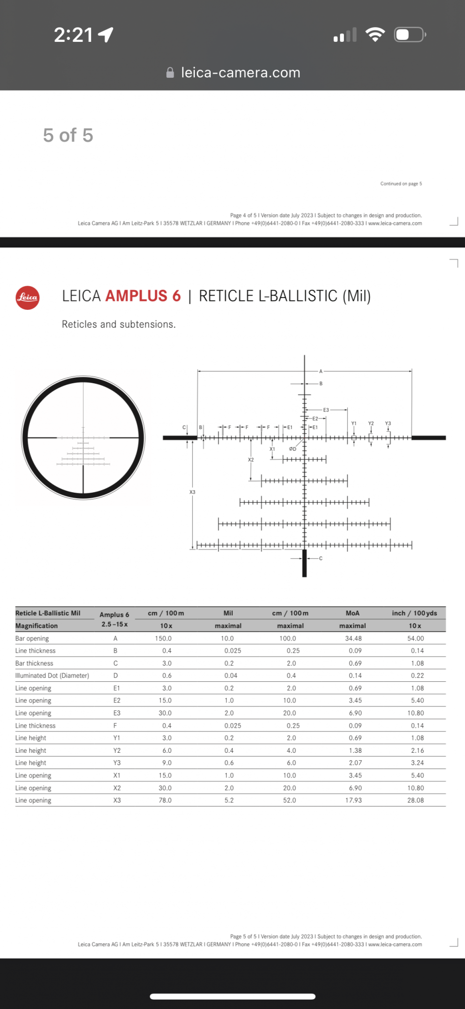

    The Leica Amplus 6 on closeout is less money, has better glass, a massive eyebox, and a better reticle for hunting.

    Guy above posted the link. The reticle isn’t entirely accurate on their site though, it shows the MOA version with only 4 bars. Here’s the mil.

    2nd focal plane on the Leica though...
