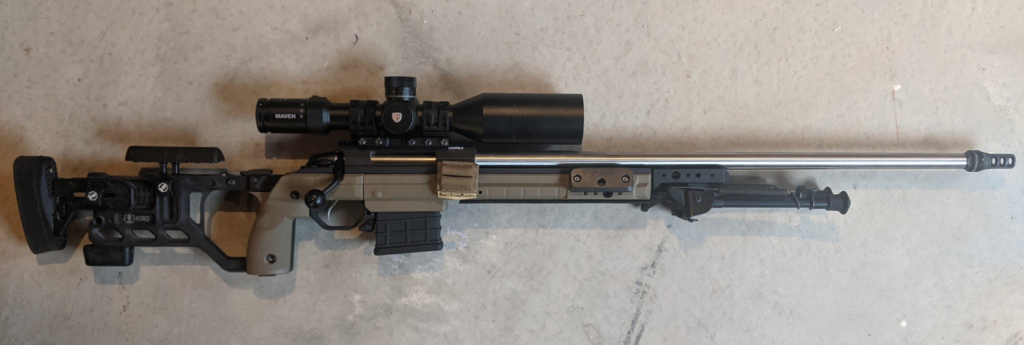

Eye relief, eye box, and sight picture - The Maven has to sit back pretty far on the rail to get a full sight picture, especially compared with my Ares ETR and Cronus. The ETR felt like it had to be as far forward as possible with the stock at full extension. Cronus somewhere in the middle. I make this out to be a bigger delta than it is. The ETR's eye relief is listed at 3.9", and the Maven's is 3". It's no ACOG. The sight picture or window, or whatever, on the Maven is Huge. Getting behind it, it fills your view, and the black ring around the outside is tiny. The Cronus feels small, almost like it has a smaller field of view, even though they're about equal. The black ring around the Cronus is very large. It feels like the scope is far away, and I guess it is farther away by about .5 inches anyways.
My biggest issue with the closer eye relief is that I have to set the scope pretty far back, and cant' take it back further without cutting my picatinny rail to accommodate it. I'll probably end up doing so. If you're on an R700 SA clone, you might not have this issue. I have a Tikka, so the receiver is pretty long, and so is the rail on top.
