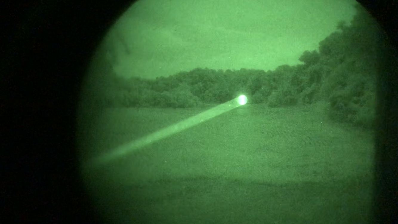

Not exactly the question you asked, but being you said "good quality clip on", here is a Luna ELIR-3 (90 mW) 810 nm version at 1,000 yards exactly. This is a measured known distance at a long range shooting range. The Luna has a much cleaner beam than most of the full power LAM's out there like the PEQ15, LA5, Dbal A2 & 3 and is much more powerful with the exception of the lA5 which if you can find a legit one will set you back a minimum of several thousand. Currently available Luna ELIR-3 are 70 mW at 850 nm and still outperform (with a cleaner beam & power) most full power LAM's. Also the ability to quickly vary the power, X & Y alignment and beam width with a "clip on" make it probably the best Laser diode based Illuminator available for $300 to $350ish.

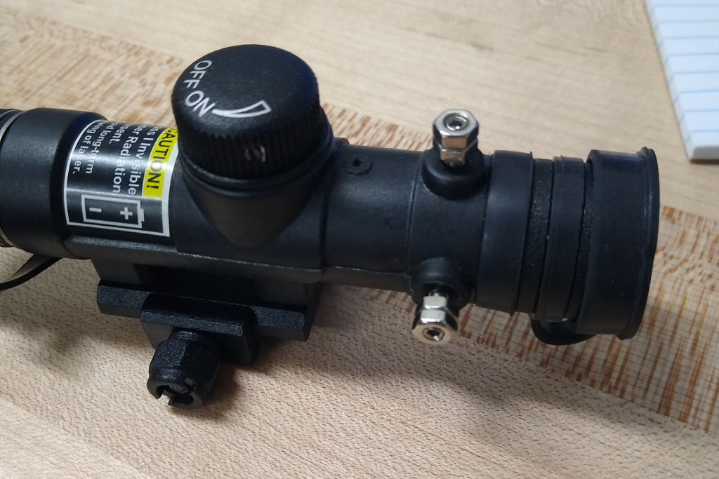

@WhereNow&How I'm barking up a similar tree as what you are speaking of. I jus finished modifying another Luna for finger adjustments

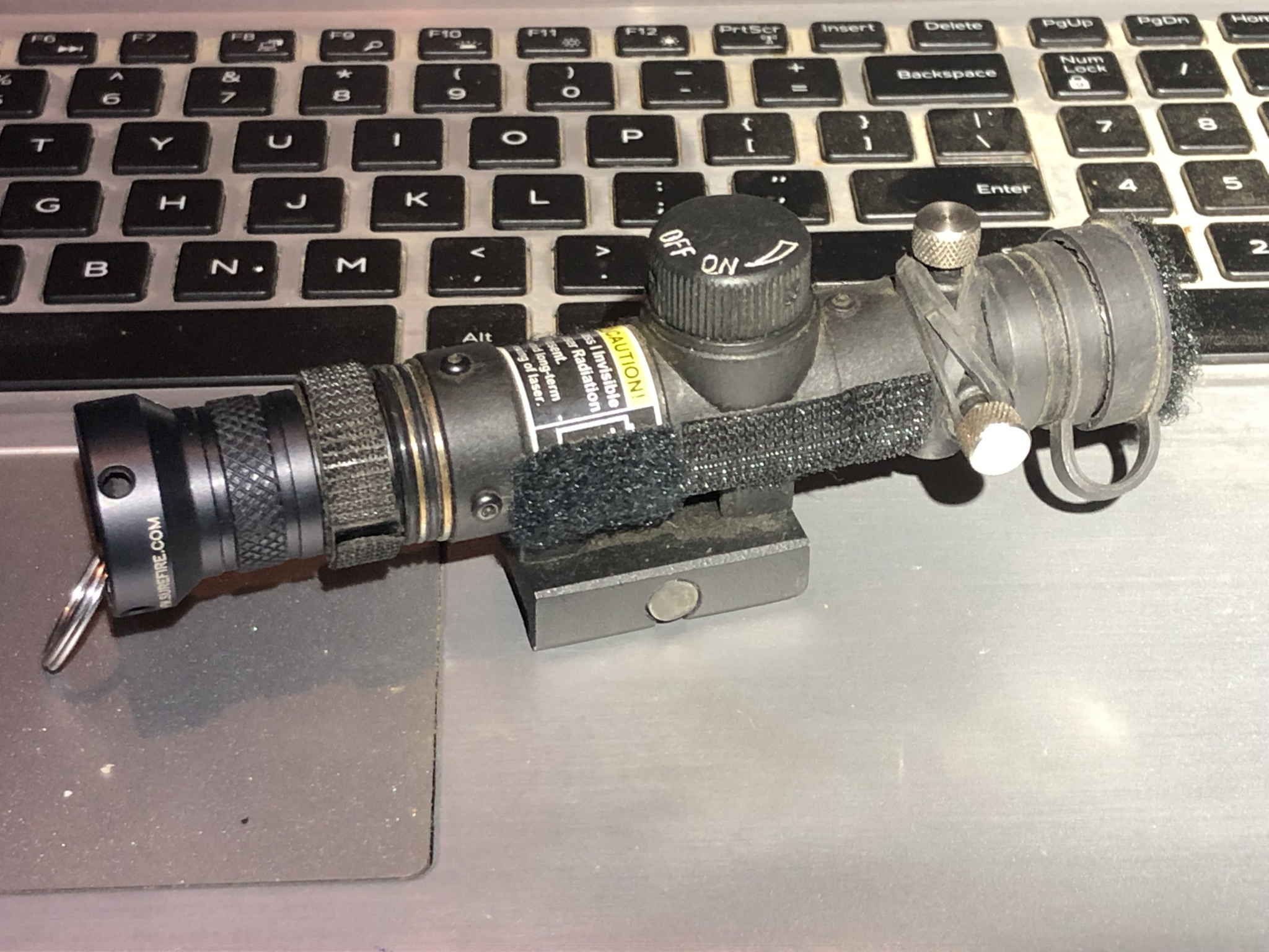

If you want to refine it down some, here are the correct Thumbscrews that work perfectly with them. I also put 2 of these tiny O Rings on each screw shaft to provide a watertight seal and some tension. I also take a small "Ranger Band" cut from bicycle inter-tube and then twist it around the Thumbscrews to provide even more positive retention under recoil.
Thumb Screws
O Rings

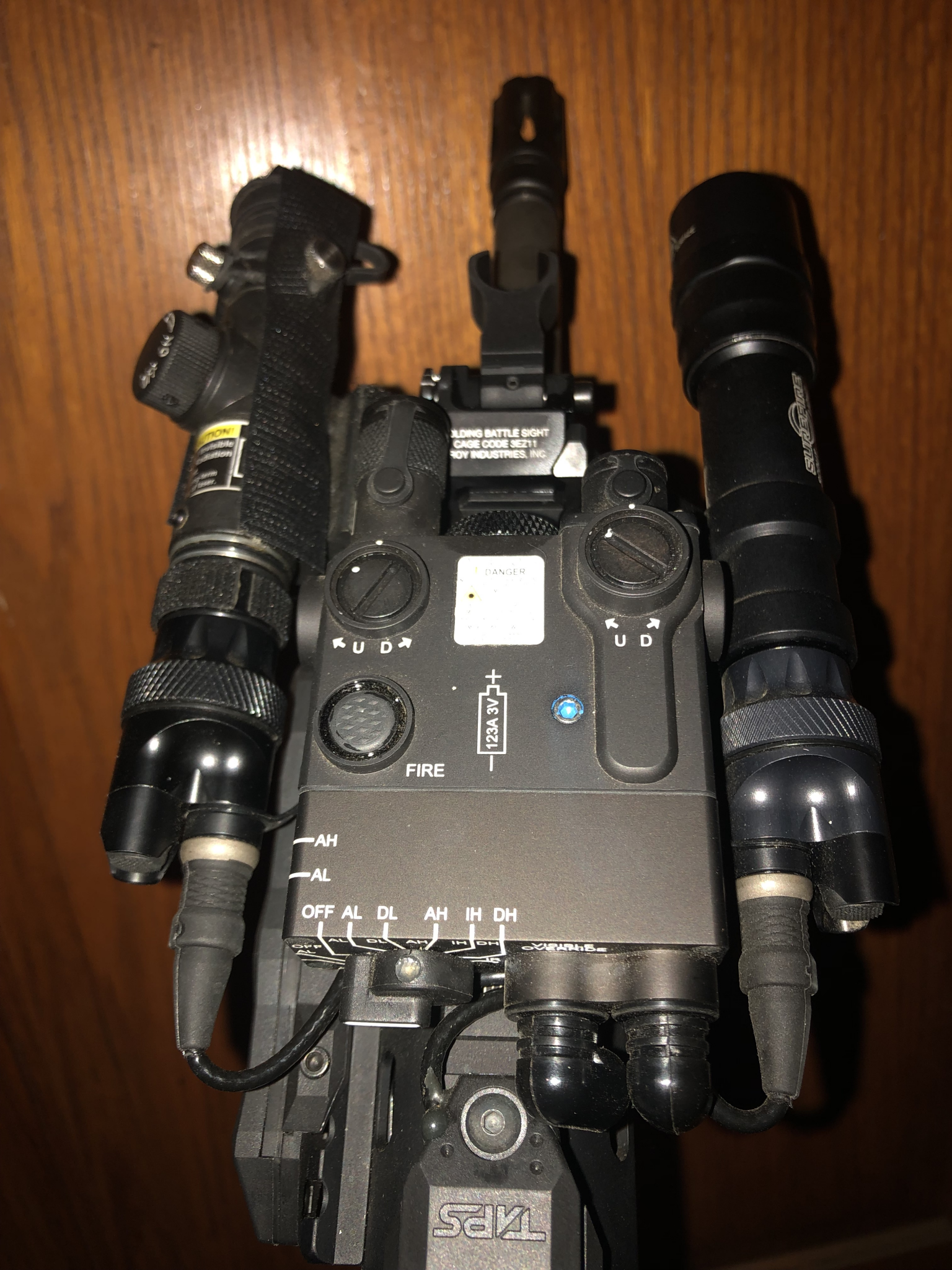

Another option for the Carbines/14 use is "marrying" a Luna ElIR-3 to a Civi Dbal A3. I have done that quite a bit and it works very well. IMHO it will outperform a MAWL in some ways that are important.
1. Dbal A3 has instant Overide to Green Vis Point & White Light
2. You can focus the intensity and width of the Illuminator much better with your IR Pointer so that you don't have wash out under
varying lighting conditions.
3. Longer run time because strong ELIR-3 Illuminator running off its own battery so Dbal A3 Battery is only running the IR Pointer.
4. You can infinitely vary the power of your Illuminator via the Luna Rheostat to suit the specific lighting conditions.
5. Ability to tune the Illuminator power to the IR Point Dot results in a very fine aiming dot for more precise shots.
6. The Luna ELIR-3 will run off RCR 123 Rechargeable Batteries fine, so every time you go out you can know for sure you are at 100% battery power on your Illuminator, which is the bigger power consumer on any LAM. Not sure if Dbals will because I haven't "sacked up enough" yet to potentially fry an expensive device like the Dbal. LOL
7. You also retain a backup Illuminator via the denutted Dbal A3 Illuminator for close quarter use if need be.
To do the "marriage" so that a single press of a pressure switch activates the Luna Illuminator and the Dbal A3 IR Pointer, requires you to get the Surefire/Luna adapter, Surefire Tail Switch and Unity Taps Sync or Taps Pro or the upcoming Unity Hot Button. All in, it costs around $1,750 ish to do the setup, but it will smoke a MAWL in performance and will sit right up there with a LA 5B.
