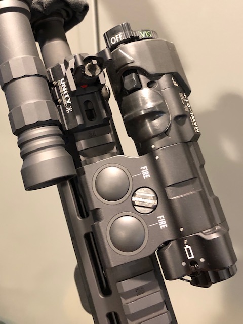

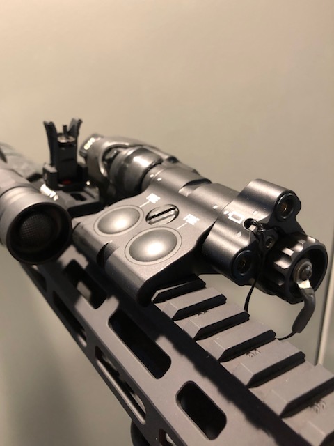

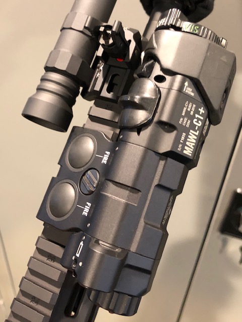

Take a look at the Unity Tactical Fusion Micro Hub 2.0 and accessories. It will definitely clean up some of your issues and concerns.
Sucks but it seems like every time a new piece of kit gets added its a total cluster and reconfigure of just about everything. I hate cables simply because they will fail and I hate having to move all over the rail to activate things. The MAWL changed that in big way for me. My white light sits on the RH side UP along my front sight mounted off the Micro Hub with a more reliable and robust SF click switch for thumb activation. Everything is simply activated by my support thumb. White light, laser and IR light.
Everything mounted on a 9.5" Geissele rail.
Quick and not the best pics but hopefully these help some. Dont forget you have a BUIS in the vis laser as well for CQB and low light. In bright sun light I have no issues seeing the vis laser at 50 feet and in.

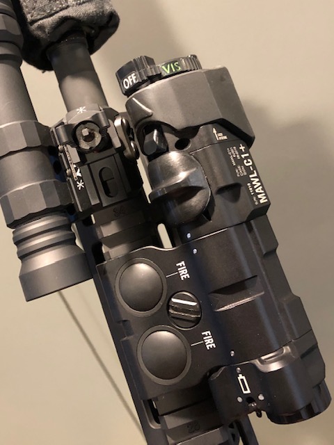

Back in March I got to borrow some gear for a Nightfighter class, including a MAWL. I ended up experiencing the same issue with having to move the MAWL back an additional slot due to the KAC front sight cross bolt would interfere with Off/VIS/IR bezel. This in turn moved my pressure pad back further. In this photo you see the wire strung tight, but I ended up swapping it around with the wire coming out on the muzzle end. This made the pad move back a few rail sections, creating a larger gap between the MAWL switches and the white light activation. Not sure I am 100% about that, but I have some time before I have the money for the MAWL/RNVG set up.

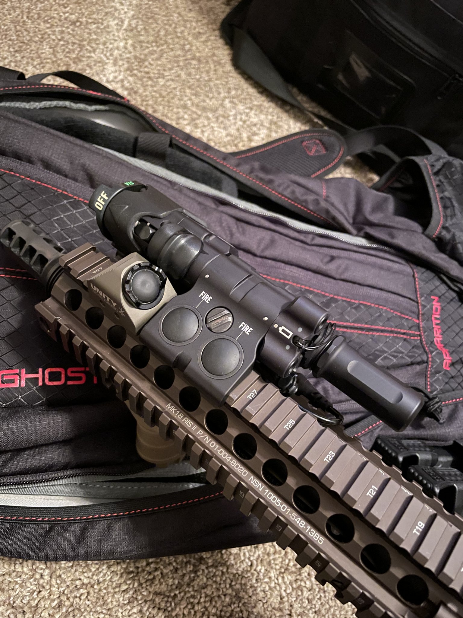

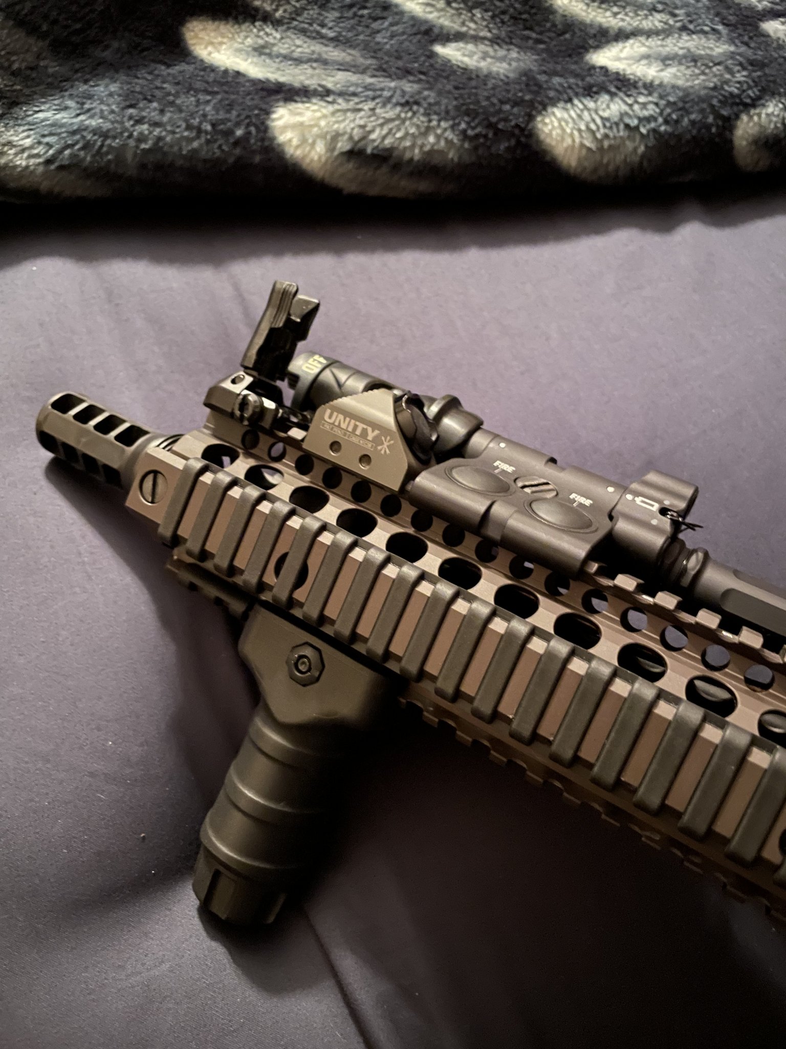

Here is mine. The Kac full front sight is to wide. The Magpul Pro works the best or the KAC micro.
I took them off.
I have also run the cloud Defensive stuff and the Unity is the best IMO.

I am going back to the knights front sight. The Magpul Pros work fine.
