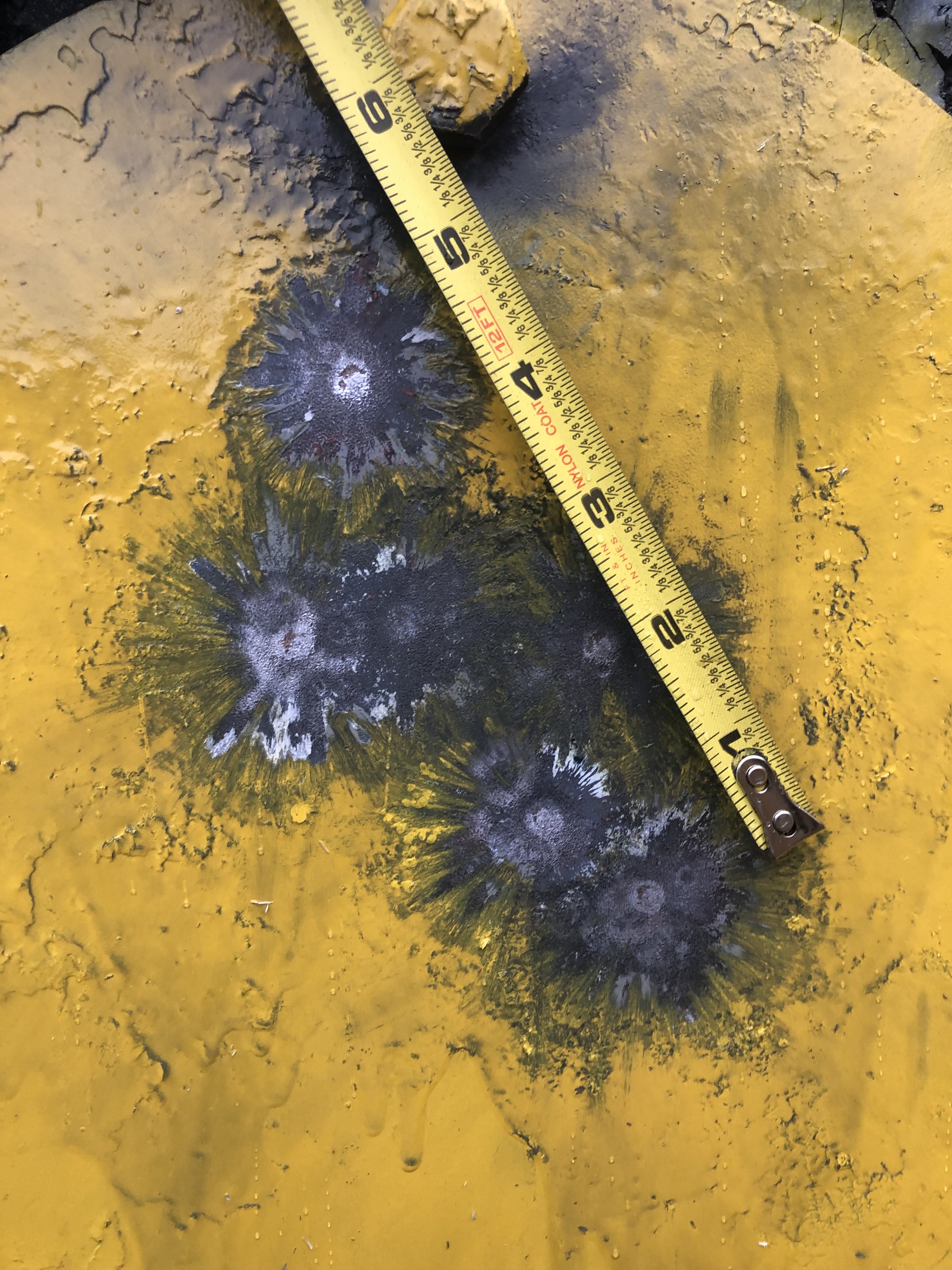

When I had access to more land I used to shoot almost every day and try to get a hit on a reduced IPSC head at 550. Past 600 my first round hit prob went way down.
Now I mostly have targets from 410-460yd.
Around 2022 I took one shot every day at a 6” circle at those distances, which granted is closer to 1.5 moa. But rain or shine etc, my longest streak was 17 days in a row. That was with a 6.5x47.
After the CK stuff I decided to start again but this time with my 300nm. Today was day 10. Got off to a rough start but am getting more confidence with this rifle. After a few more days I’ll try to keep it in the IPSC A zone on the head. Current streak is 5 hits in a row.
Miss hit hit hit miss hit hit hit hit hit
This is the last 4
Edit to add: equip is AXSR, TT, 338Ultra

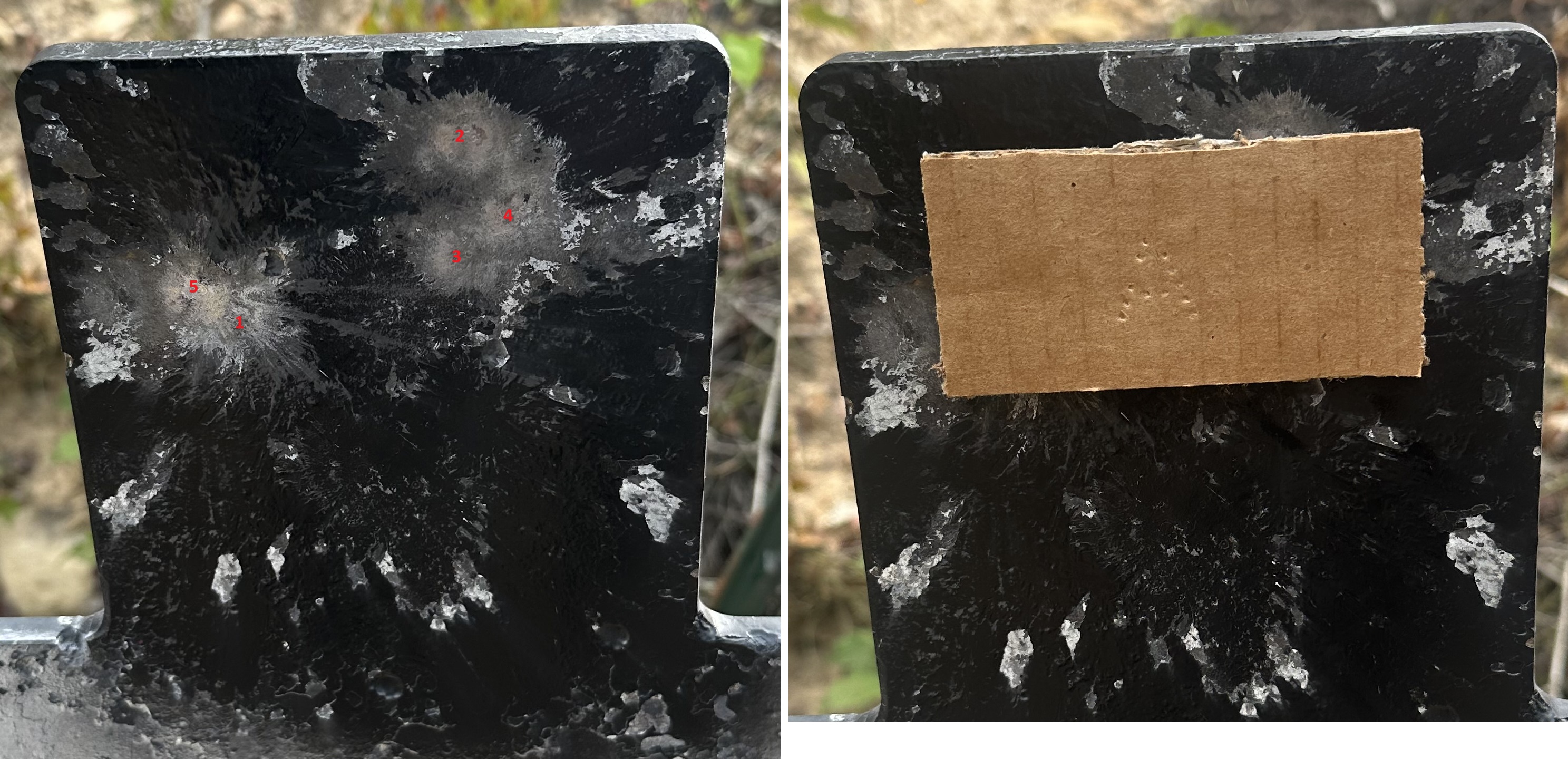

update to prev post just because i'm bored right now... last 5 shots, all in the ipsc A zone which is 1 7/8" x 3 7/8" so at the distance I'm shooting, just barely under 1/2 MOA vertically and just barely under 1 MOA horizontally.
Only shooting 1 round per day, different times of day, different light/mirage/wind conditions. Also, mix of prone and shooting off bed cover on a truck, just a bipod and rear bag. My goal is just practicing making adjustments for conditions so I'm putting all rounds on same target, and I'm spending at least 5 min observing conditions before shooting. So far my vertical adjustments for conditions have been 0 - .25 mil and wind has been .1 - .4
I'm doing a little better than I expected right now and will still be happy if i make it to ten days in a row inside 1.5 MOA. Driving around the country shooting at different locations would be way more fun and challenging. Maybe I'll try that in the spring.
Still, this would be way easier with my 6dasher and on a flat range.

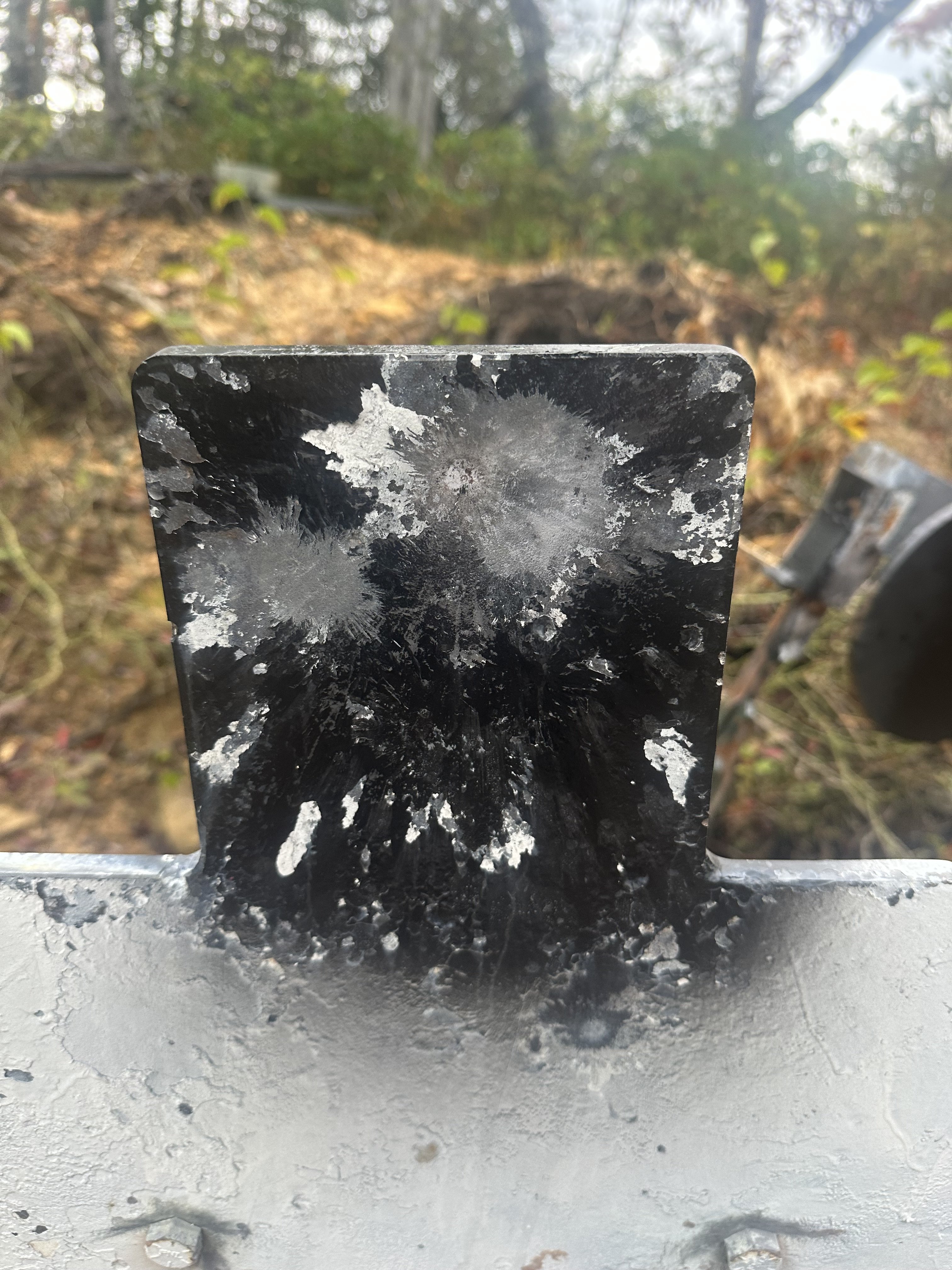

Another day, another a zone (attached). Early morning dark and rainy.
edit again:
streak ended at 7, 6 of which were in A-zone. Garmin showed the round almost 70fps below mean and it landed 1/2" into the neck. oh well.

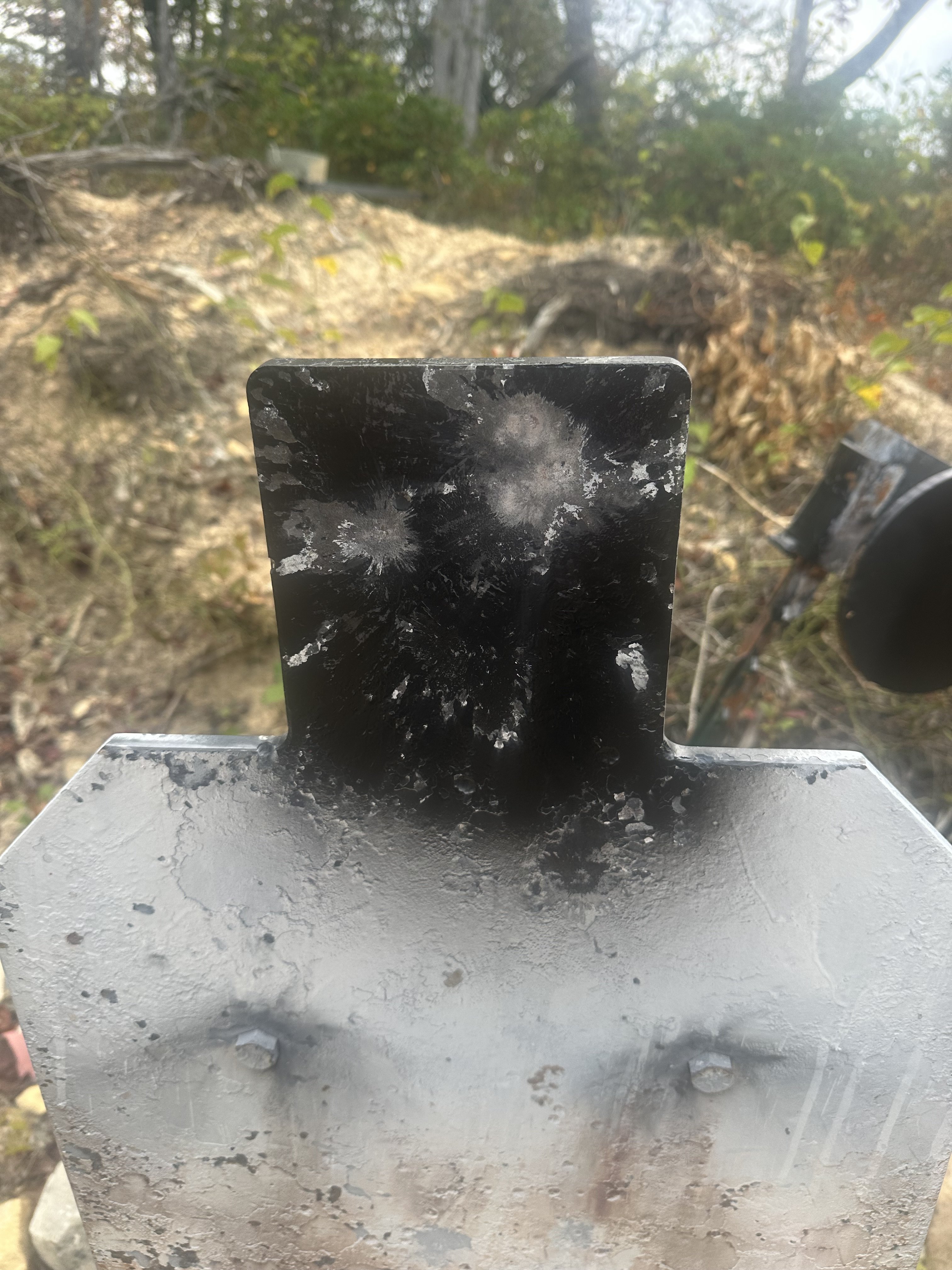

fwiw, i'm on day 21 of my experiment. AXSR 300nm @ 410+ yards, 1 shot per day across a holler one ridgetop to another, different times, positions etc. only 2 days rain. None of the misses were from prone or when raining.
17 hits, 4 misses - 81% hit rate
11 of the hits are inside IPSC A zone (1 7/8" tall by 3 7/8" wide box in upper half of the 6"x6" head).
IOW 11 of 21 shots are in a .5 x 1 MOA rectangle. The remaining 6 hits are in 1.5 MOA square.
1 miss was just low and due to ammo (at least, i assume as the garmin read the fps about 5 STD below mean.)
1 miss was just left missed wind call.
2 miss were just high, i attributed one to light and the other to wind moving up the face of the mountain toward the target, but just a guess
I will say, I think i'd have more hits shooting my 6dasher or 6.5x47. 300nm seems a lot less forgiving.

I shoot a lot of Rimfire, so normal environmental effects on Centerfire results at 300 and under seem almost irrelevant, outside of BR/F class. The shooting position is an absolutely critical part of this discussion. Add in a competitive time limitation and those 2 things completely overshadow any other impact on results. Apples to apples is important. Without time pressure and in a position chosen by the shooter 1 MOA is not unreasonable. This group was shot with a T3x in 6.5CM using S&B 142gr HPBT off the bench using a 1-8x Cabelas cheapie at 400 yds using an old wobbly free bipod. 6 shots by my 13 yr old. Less than 100 CF trigger pulls in his life at this point.
Reactions: JBoomhauer
