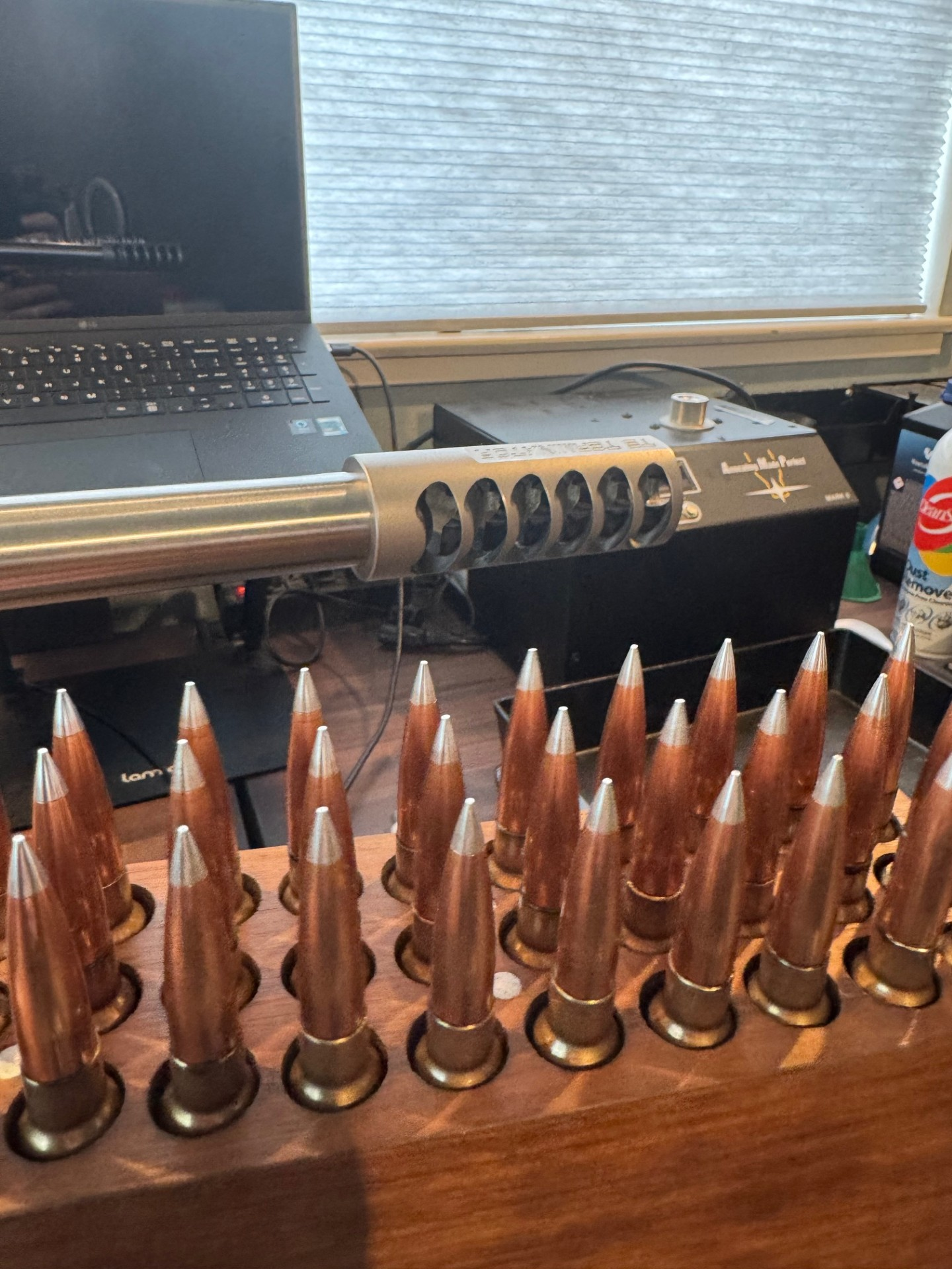

    I am using a Hornady product for the first time with my 37XC...
    When are you headed to the range to try this out?
    Tuesday.
    These are just the second group of 30 down the barrel, and they're also all virgin brass. It's somewhat of a guess of a load of N570 with the A-Tips. Definitely a random seating depth. I'm hoping that I'm close enough to a decent load that I can make one more trip to the range to tune in the seating depth a bit before the 8th - that's when I'm heading out to the hills for some ELR fun and I wouldn't mind lobbing a few a long way down range.
    Stainless steel brake + ultrasonic cleaner + Bore Tech Case Clean :)
    (y)(y)(y)
    My first two suppressors arrived last month.
    I picked up an ultrasonic cleaner to clean them.
    My brakes have simply been getting some Q-tips dipped in BoreTech carbon remover then hitting them with a nylon brush.
    I may pop 'em off and put then in the ultrasonic now.
