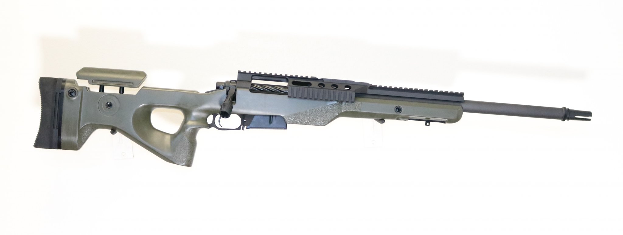

This was the most recent (and hopefully last) group of SENTINEL rifles spec'd for the MIRS a couple of years ago. These all had hardened and ground steel dowel pins going through the mount and into the top of the receivers which insured that the mounting screws would never take the shear loads from recoil.
Beautiful work, as always. (y)
