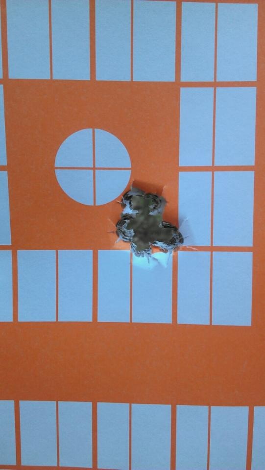

100yd 8 round group out of a .338 AI lapua my gunsmith friend shot yesterday through a McGowan SS bbl. This rifle was not chambered by McGowan BTW. I've been pleased with my McGowan bbl as well, sub MOA.
