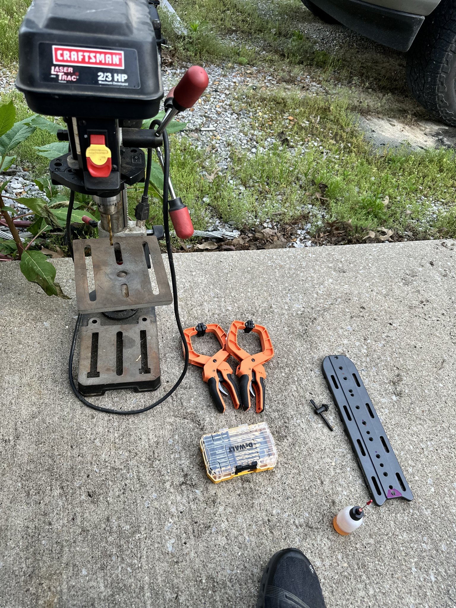

    @McLeod_Precision Stabilator Pro. It is designed to work on Chassis like MPA and others with Mlok slots in the bottom. I took one and Home Machined with drill press for it to work on the Manners Stocks that utilize the Factory Manners Weighted ARCA Rail with the 3 - 1/4-20 screws. This rail is mostly found on the TCS, PRS1 & PRS2. I also believe it is an option on most others like the T4 & Team stocks. I'll show you pictures below, but I am no machines and my work is CRUDE!! Kevin is going to feel the waters and see if there is enough interest for him to add this to the lineup and make it a factory option. If you're interested let them know. I am going to continue to work with them on a couple of Manners mounting options for their different bolt patterns. 419 rail and Manners rails. Hopefully it could be made in 1 piece instead of 2 different ones.
    I ran mine for my first match this weekend and it was great. I never had an issue where it was to big, wide or in the way. It works amazingly well. My front support bag of choice is an Armageddon Gear Schmedium and the support of the 2 is rock solid. I will have more practice in with it, but I am 100% ready to have Kevin go for it with the hole pattern needed.

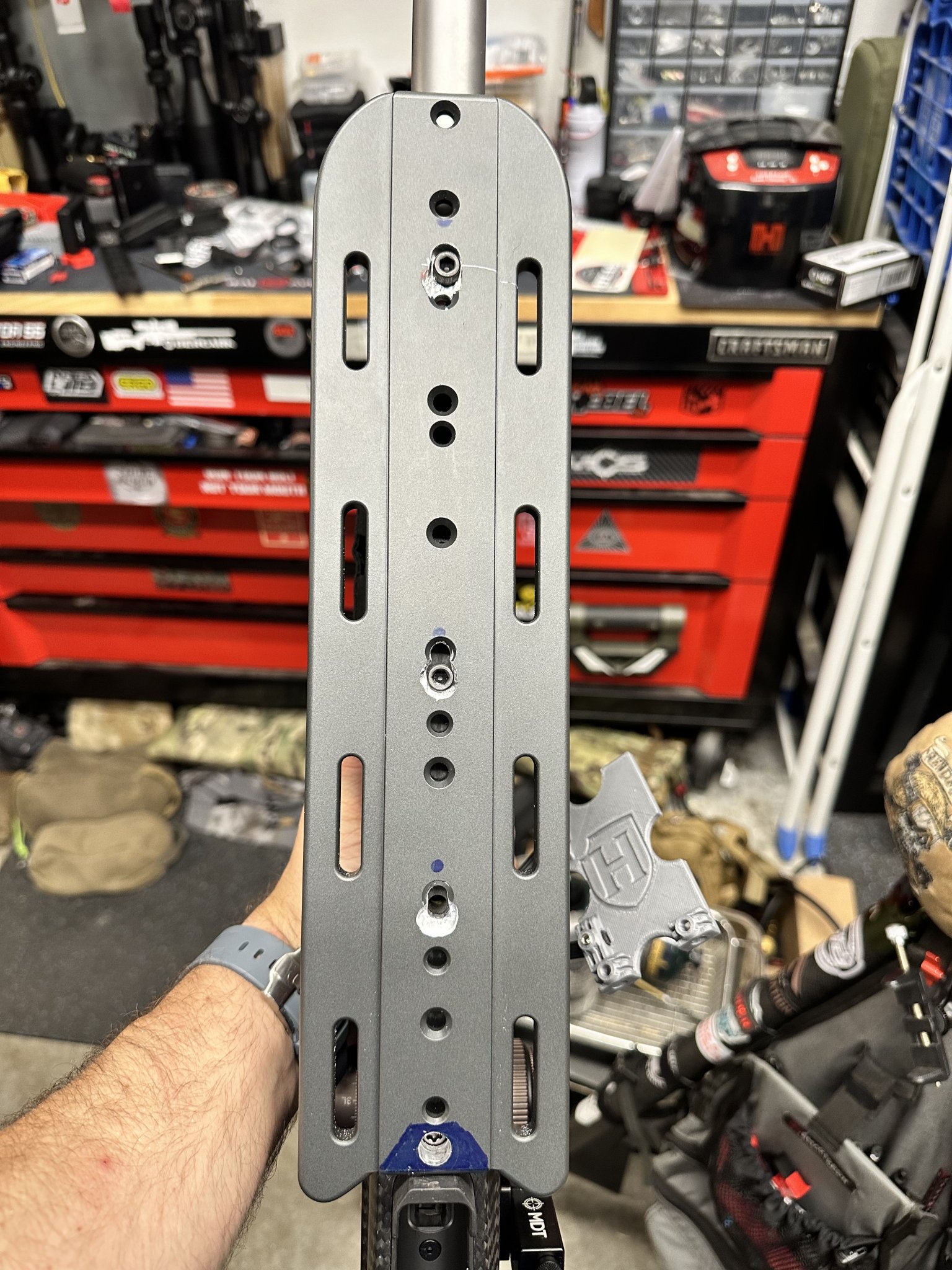

    After lots of emails and 1 phone call with Kevin I believe we have the holes and mounting setup ready for a PRS1 & PRS2 with factory Manners Weighted rail ready to be swapped to a Stabilator Pro attached with the 3- 1/4x20 cap screws.

    @Defender32 verified correct fitment on PRS1 and TCS. I am machining these now. Cerakote tomorrow.
    If you do not have your order in yet, please do it now and if you want black, please specify in the NOTES when you checkout. I will need an accurate count. Black is not my normal color, so this is going to be a special run.

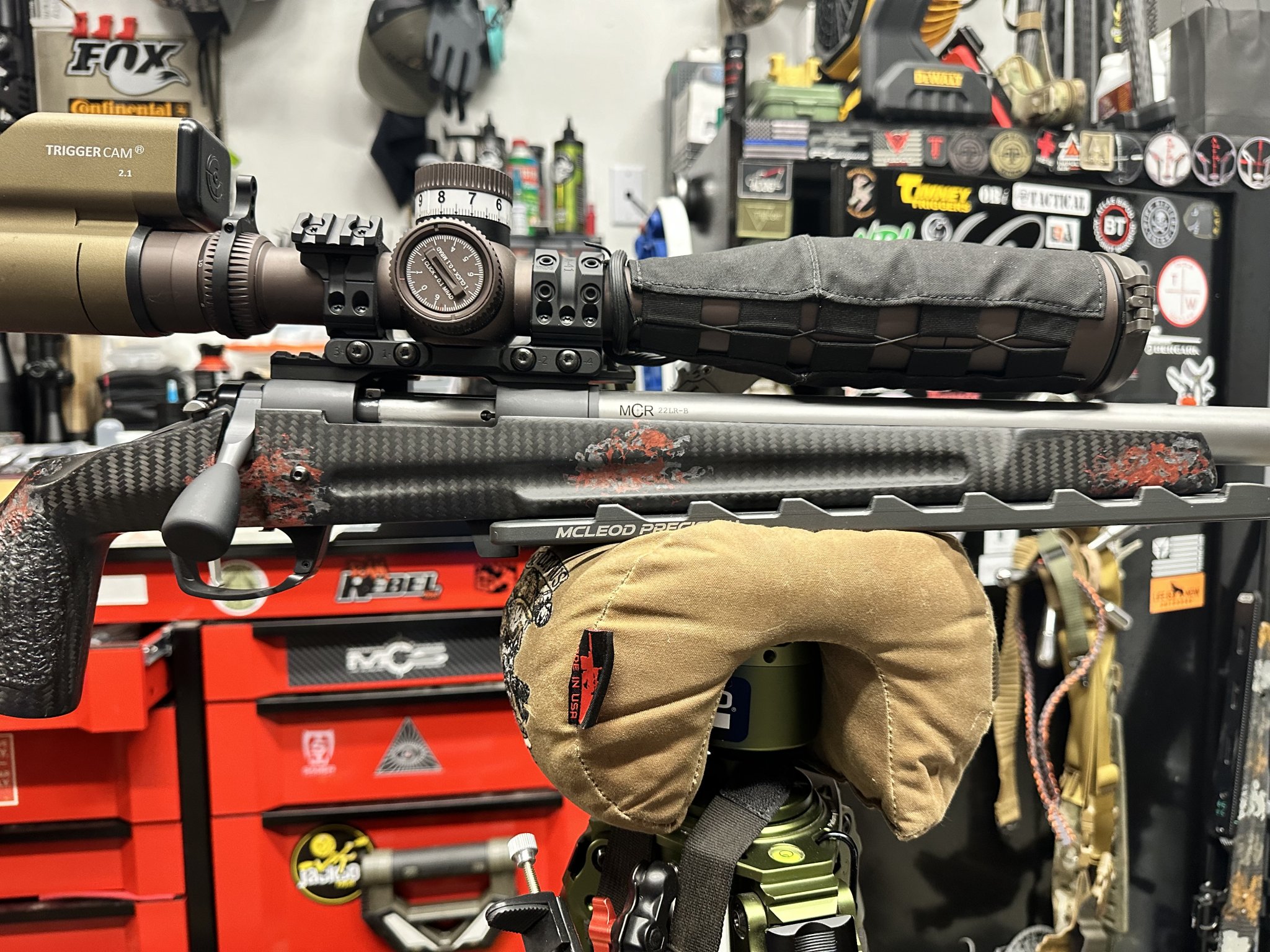

    Below you will see the video of the Manners Stabilator Pro V3 from @McLeod_Precision . This is in the raw. I received it on Friday 5/17 and ran it for 2 matches Saturday & Sunday on the Manners TCS. it is 100% Flawless and I can't wait for you guys that have ordered to have it in your hands and on your rigs.
    The fitment is FLAWLESS. Kevin took a great product and adapted it over for us Manners Guys. If you want one go order it and if you want it black pay for the optional upgrade and put that in the notes of your order. Just know it's going to ship 2-3 weeks after order. He sprays color in batches to save on wasted product.

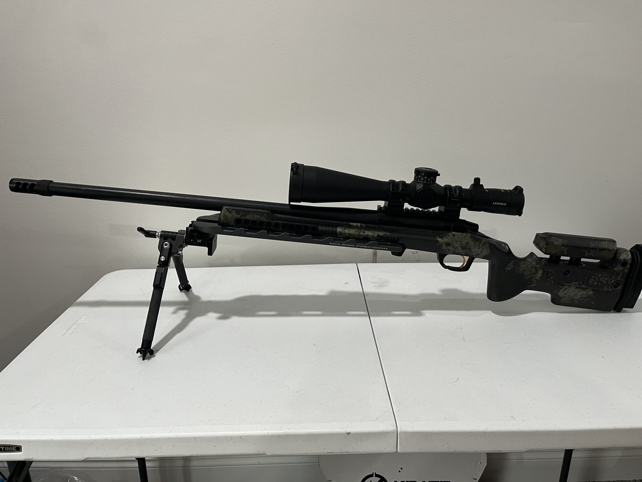

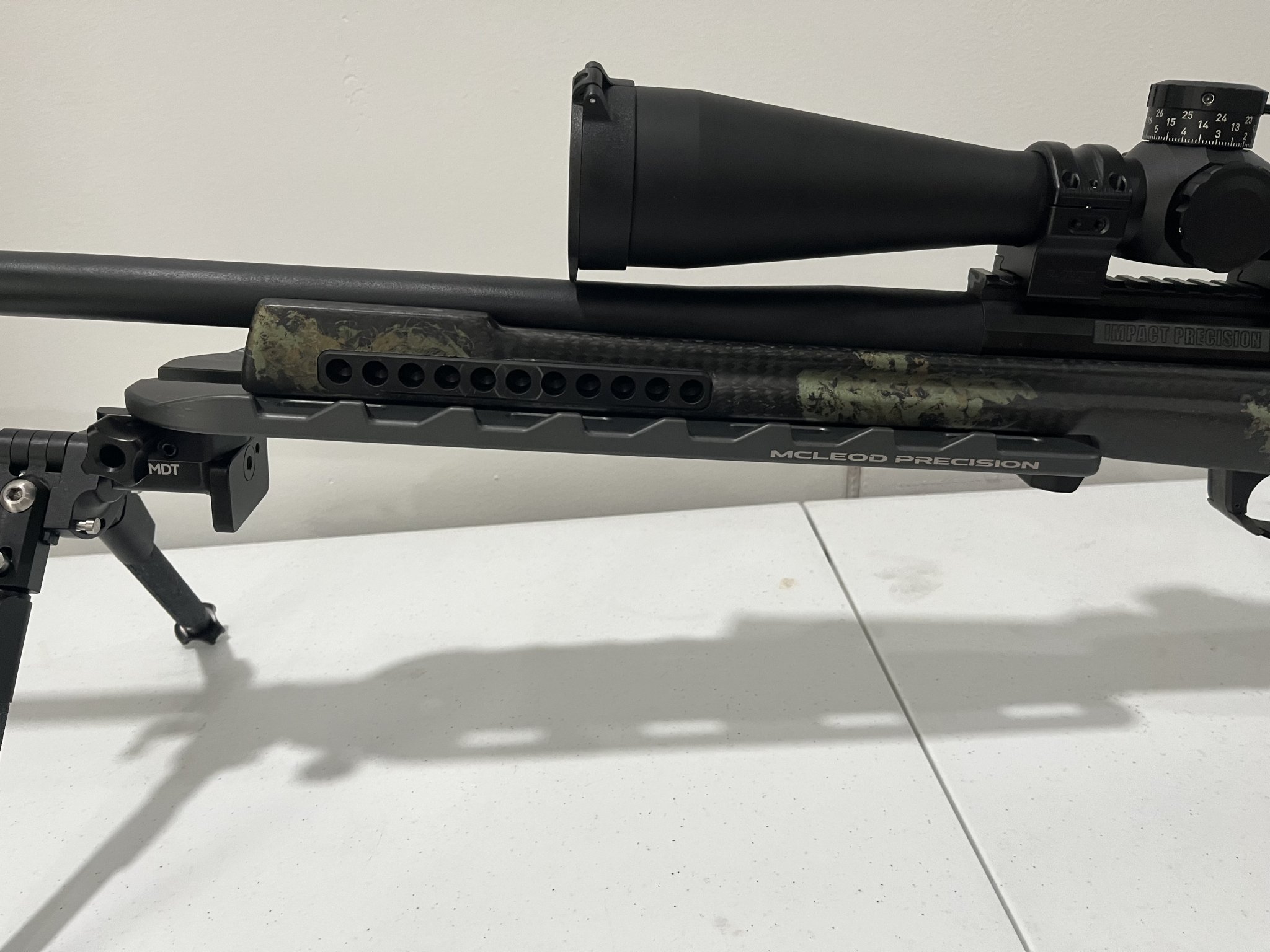

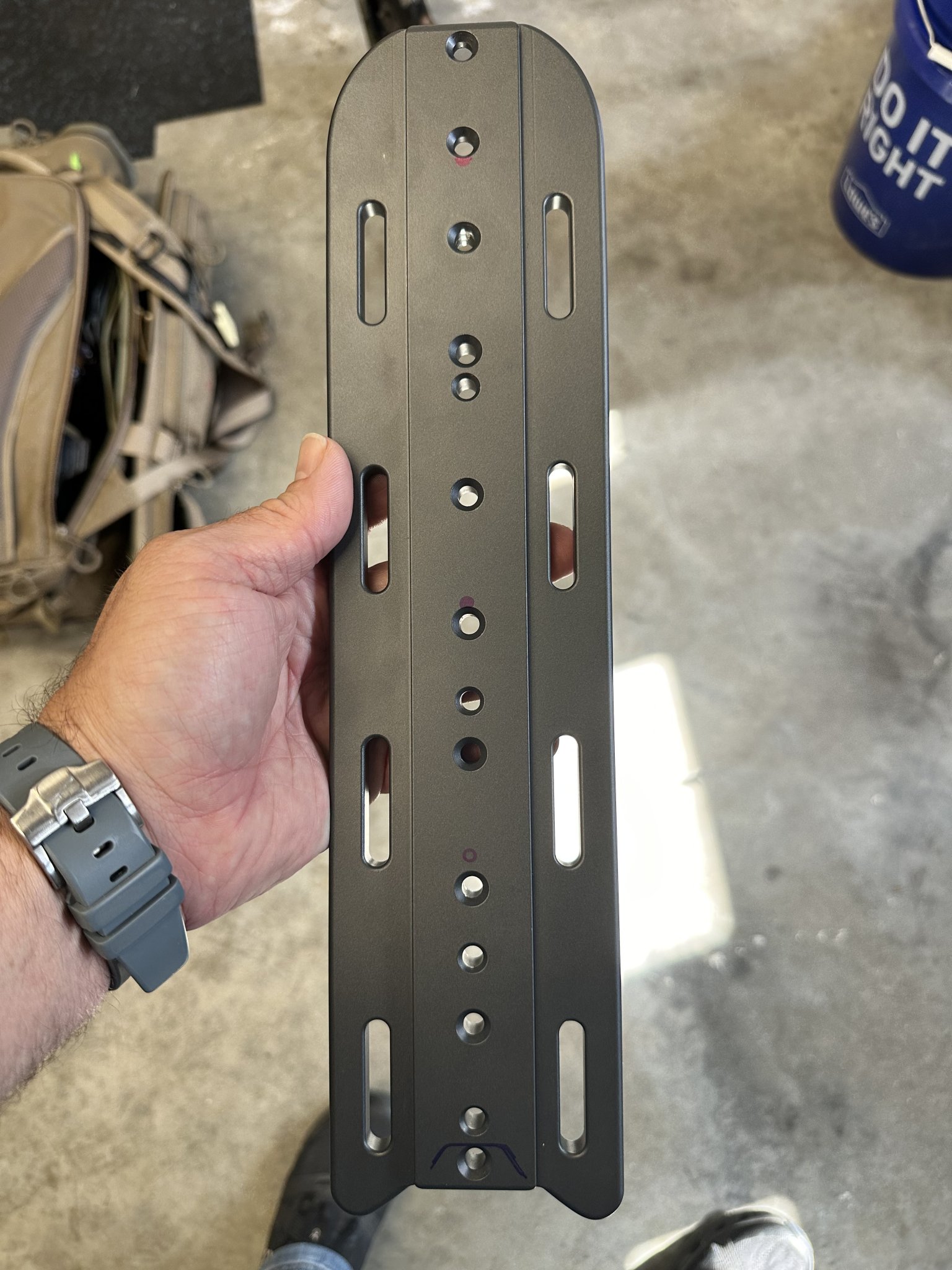

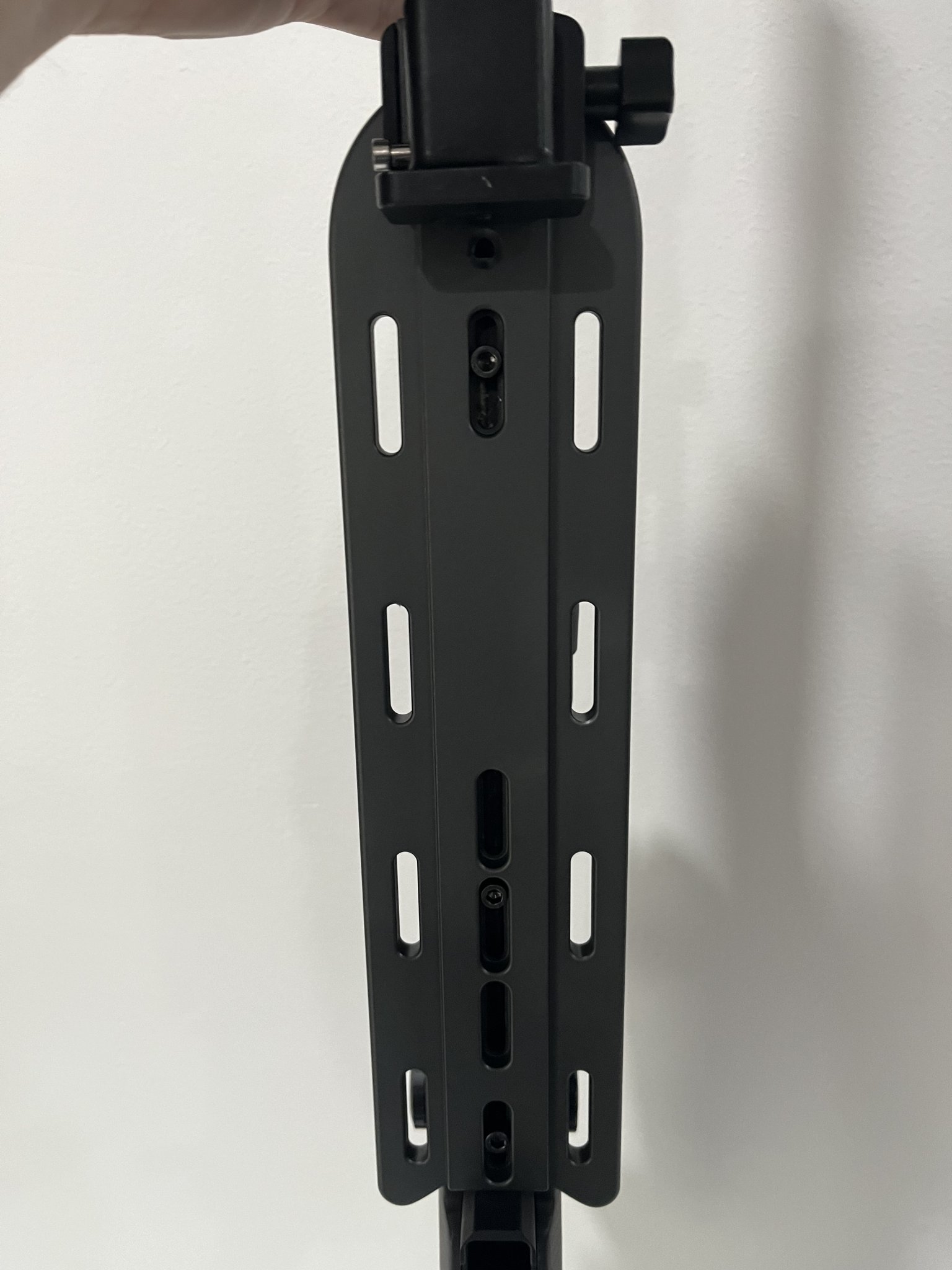

    Received my Manners TCS Stabilator Pro yesterday. Here are my thoughts
    1. Packaged well and arrived quickly. You feel the quality when you open it.
    2. Dark gray color is just plain sexy to me
    3. Fit and finish are great. It really keeps the rifle forend from “rolling” on a bag. I plan to run it in a match this weekend and will provide an update once I do.
    I would 100% buy again

    I 100% agree with you on how it rides a barricade and bag.
    When you put the Gray on a matt finished stock it's amazing. The Black on a Gloss Finished stock I believe is going to be awesome as well.
    I wanted to have Kevin leave one of mine in the raw aluminum!!

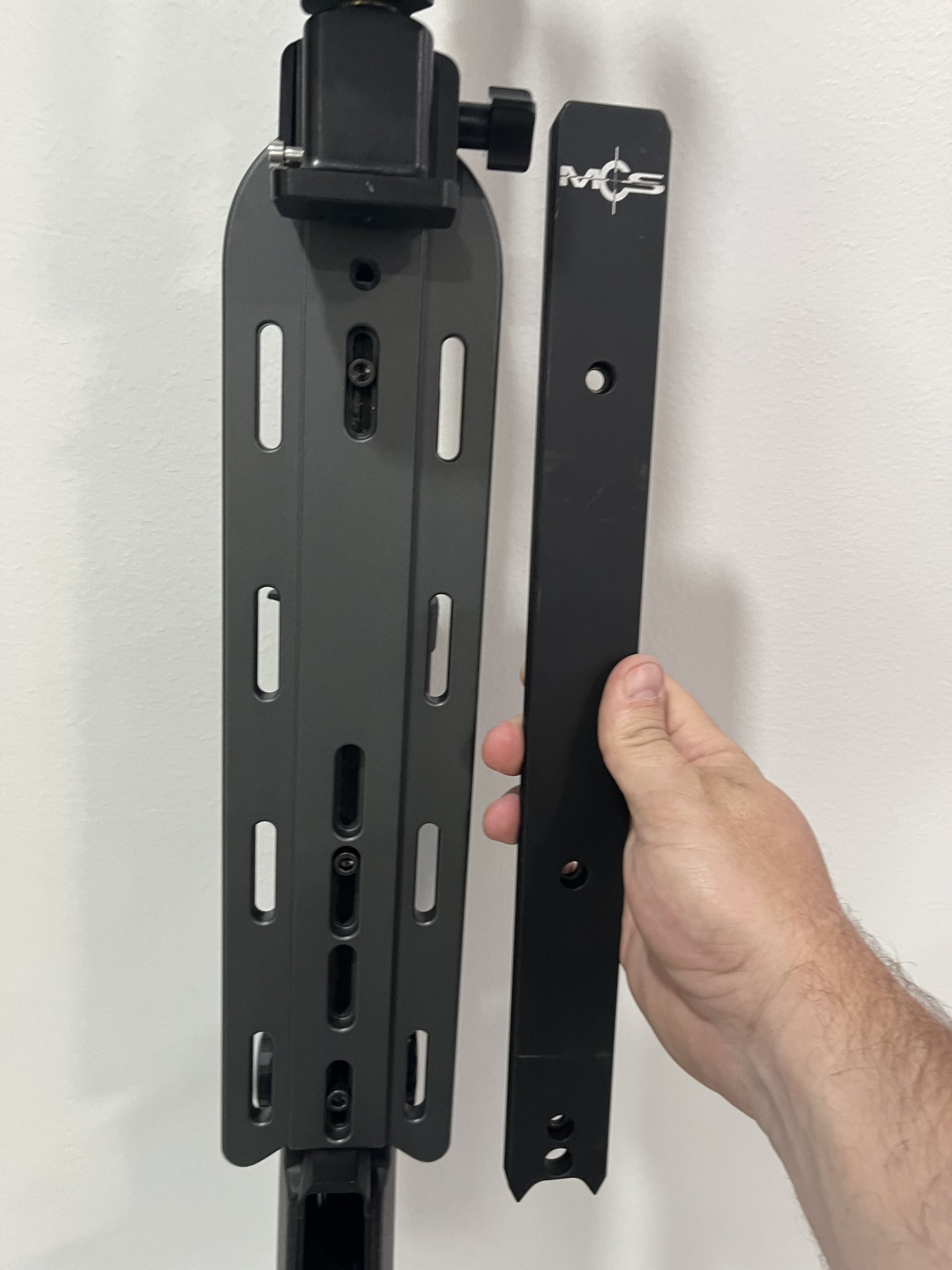

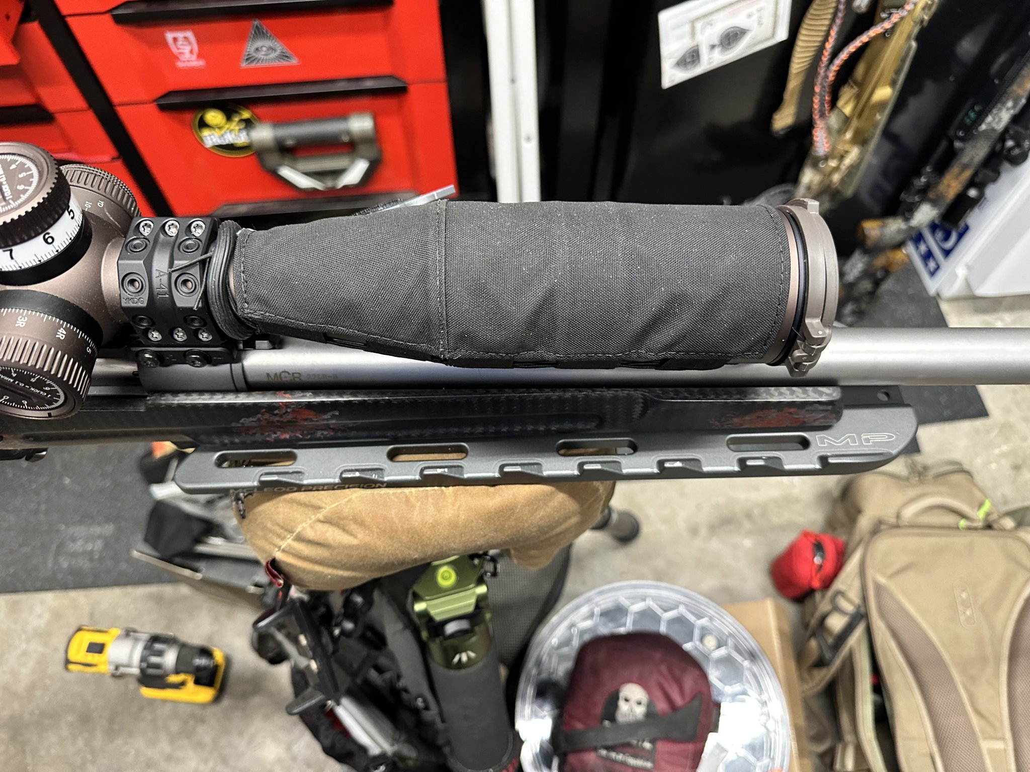

    Here is a comparison between the Manners Arca and the Stabilator for those who are wondering. If possible, I'd like to see the Stabilator wrap the mag well at the end like the Manners does and have a little bigger hole for my front action screw. I had to install the barreled action before I added the rail but its no big deal.

    Try putting a small gap between the Stabilator and the magwell. You might get a harmonic if they touch. Maybe not. Give it a try. Easy to test since the slots are there making it easy to shift it.

    I was thinking I wanted that as well when I was working with Kevin on the design. All that’s required is to loosen the 3 screws and slide it forward. I actually left mine in the forward most position to leave the action screw exposed. This also gains a little more forward weight and more plate as I use the GrayOps CNC Barricade/ Bag Stop.
