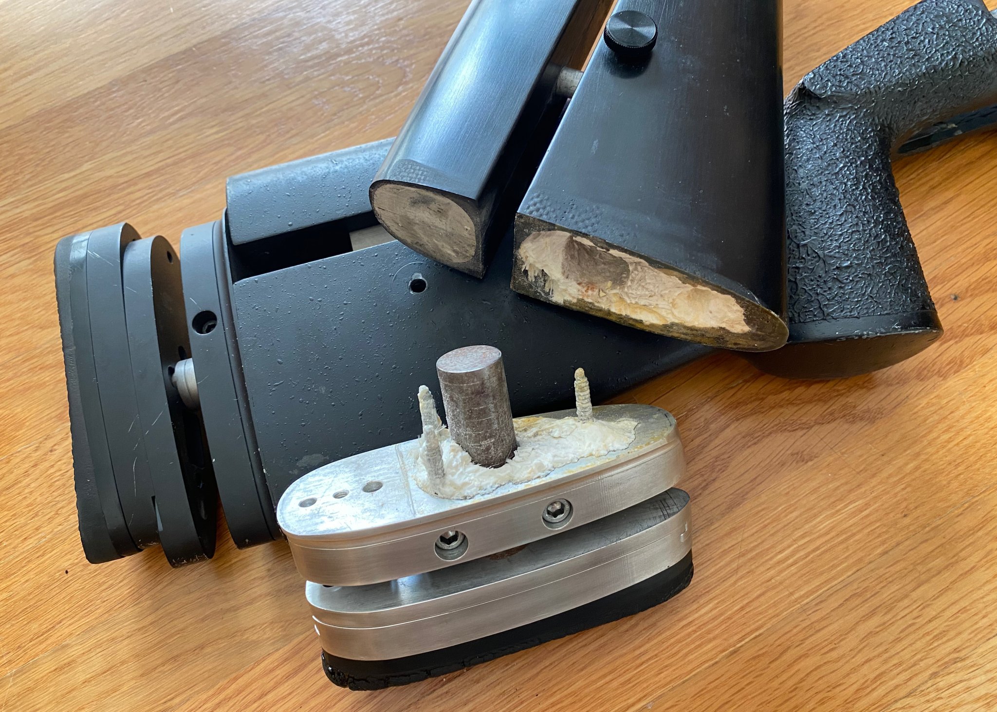

Any recommendations for a shop that can professionally and reliably (as in not take my stock, money and not have no updates or response to status queries for months on end) fix the target butt system that has fallen out of my McMillan fiberglass stock, as well as do some minor patch work on the gel coat (seal the exposed end of the cheek piece, patch up some areas of the stock where the fiberglass cloth is starting to show)?

Not trying to start a flame war on any company or shop here. I got this Baker Special stock with the broken off target butt system second hand, so don’t know who did the original install work. Just know that I need it professionally attached back on. That and the gel coat patch work requires a knowledgeable and reliable hand working with fiberglass stocks. So just looking for someone that can professionally do that paid work, plus general stocksmith tasks such as removing bedding from the barrel channel, installing a new pad on the butt system, and installing a 10” Anschutz UIT rail (if I can find one, since these are apparently limited production items too now).

Think its a pretty easy fix order some pro bed 2000 from Score-high. Get your self back to a flat surface in the mounting area with epoxy. Buy some thread inserts and machine screws that fit the adjustable butt pad. Then drill new holes for the inserts and glue them in. The pro bed will come with release agent so with some masking tape you shouldn't need much more than normal hand tools, drill bits and a drill gun. Mc master will have everything you need.
