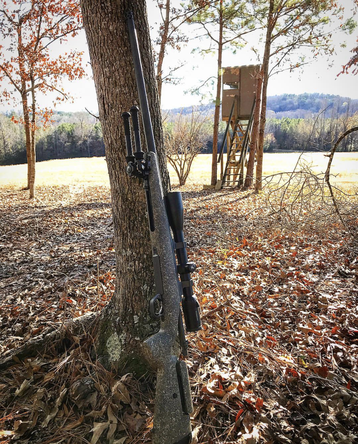

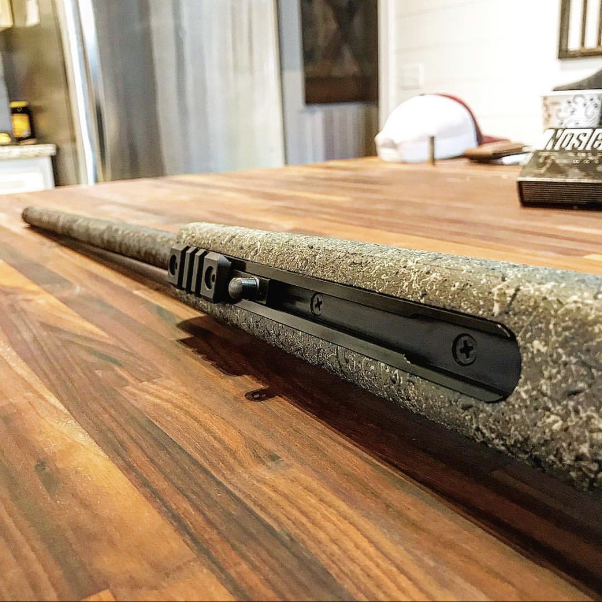

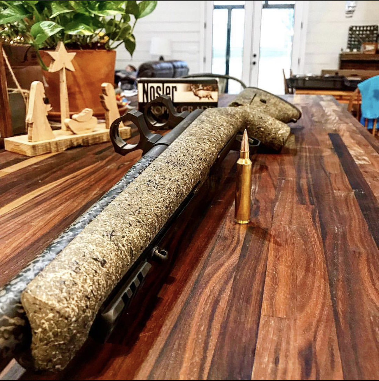

Here are some photos of a LR hunting rig I helped spec out for a coworker (Backwater Custom Rifles is the gunsmith). We ordered a bare carbon (edge fill) Game Warden with the adj. cheek and an Anschutz rail. The adj. cheek piece is absolutely necessary to get a proper cheek weld. I believe we mounted a 56mm Swaro, and it definitely need to come up a bit for a good sight picture off the bench. I'm 6'1 with big hands and I have plenty of room in the grip. The palm swell is noticeable, but not overly big.
The edge fill balances well with a Proof cf barrel, and the front rail helps balance the weight of the hardware in the rear.
I hope this helps in your decision. The game warden is a fantastic stock for a LR hunting rig.

Thanks much for the info and pictures. I'm a bit confused though. When I talked to Josh at McMillan yesterday, he said that you couldn't get an adjustable cheek riser with edge fill as "it wouldn't support it". Wonder if they used to do it and they quit or I just miss understood.

Let me clarify. This was not a true edge fill. When you place an order you also tell them the caliber. McMillan has what they call an edge magnum blend which will not be as light as a full edge fill. This rifle was a 28 Nosler, and required the modified fill...which I guess can support the adj. hardware.

Ok, that makes sense....too many options make it confusing but does make sense :)
