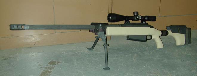

Trying to gain some knowledge behind the McMillan 50 BMG. Looking to clear up service dates and designations as well as standard equipment or components on them.
When did it change from the M88 to MK15 MOD 0 and what changes took place? Seem like Fisher brakes are the standard but also see another brake, Think its NEAR Manufacturing? KAC NV bridge on most as well.
I've seen both stocks shown below, but the adjustable comb is far more popular. Is the other correct?

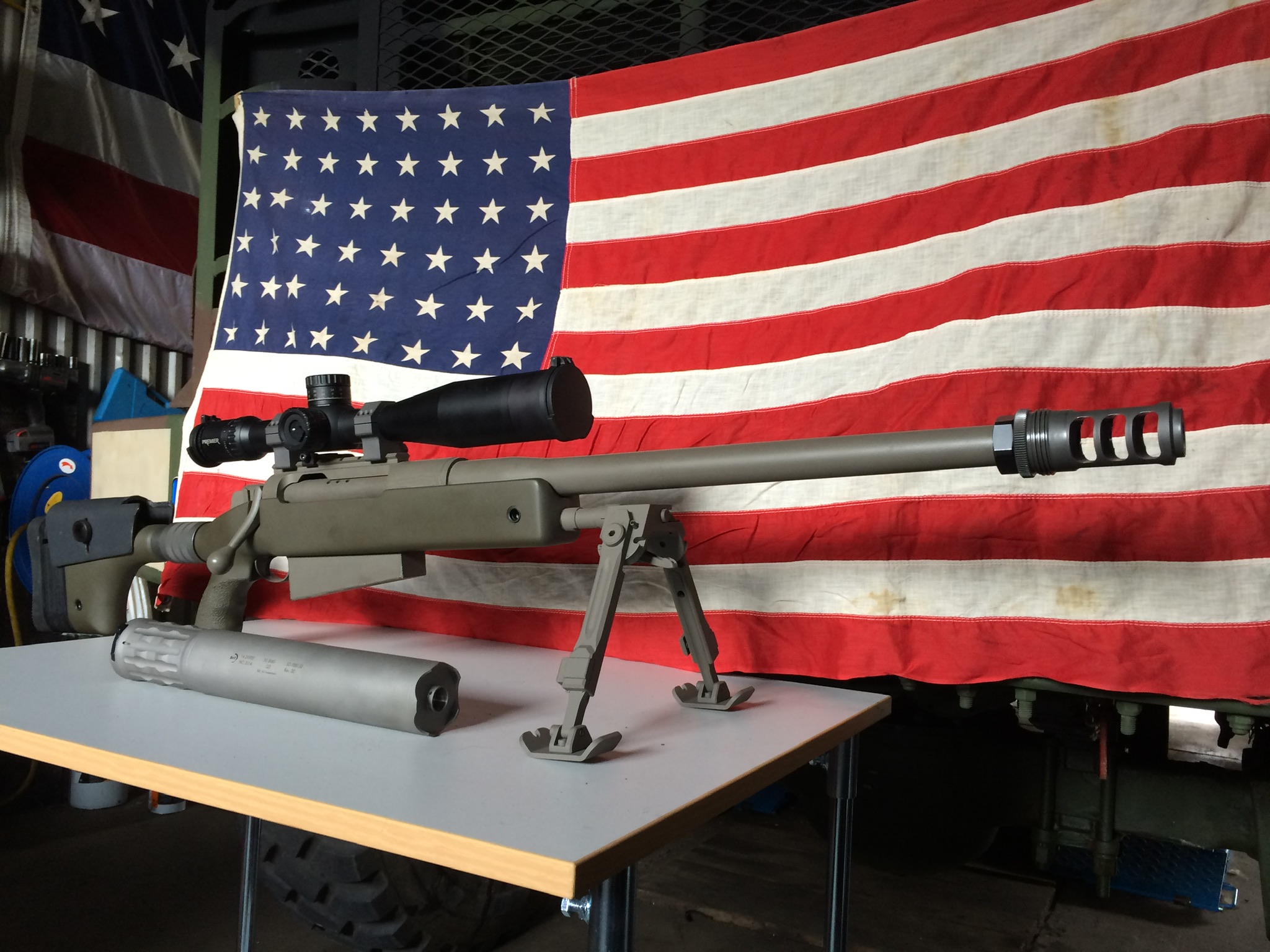

@Random Guy has the history laid out, so I'll just post pics of mine. First up is my Mk15 Mod 0 kit. The Mod 0 has a few variations, the earliest ones didn't have an adjustable cheekpiece and didn't have the nightvision mount. My kit came later, it has an adjustable cheekpiece and a Crane made nightvision mount. The Crane made nightvision mounts were pretty bad, so eventually they had Knight’s Armament make some for the Mod 0's (I also have a spare KAC mount that I keep with this kit). These used the original M88 receivers:
The Mod 0's were then rebuilt into the Mod 1 rifles. The receivers are just about impossible to wear out, so original M88 receivers are now Mod 1's. Crane has also ordered more receivers, the newer ones are marked slightly differently. There's also a few variations of the Cadex chassis, modifications/improvements have been ongoing.
My rifle is built on a real overrun M88 receiver, only 4 of these receivers are known to exist outside the military. Three have been built into Mod 1's, one is going to be built into a Mod 0. This is also the most current chassis revision. This Mod 1 is as legit as you can get without enlisting:

that is a nice Mod1 setup. I am working on version now. What muzzle device and bipod did you see in service? I got the name of a Candian muzzle device at one time. I have ordered up some TAC 50s, but now I am wondering if they understand I need TAC50s without a top rail. Everything .50 cal moves at a snails pace with manufacturers.

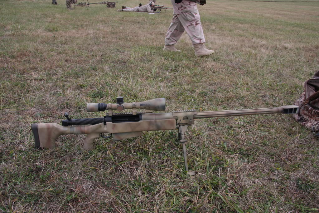

Here is a photo of your mk15-0 in theater. u can see it here with an older stock -
