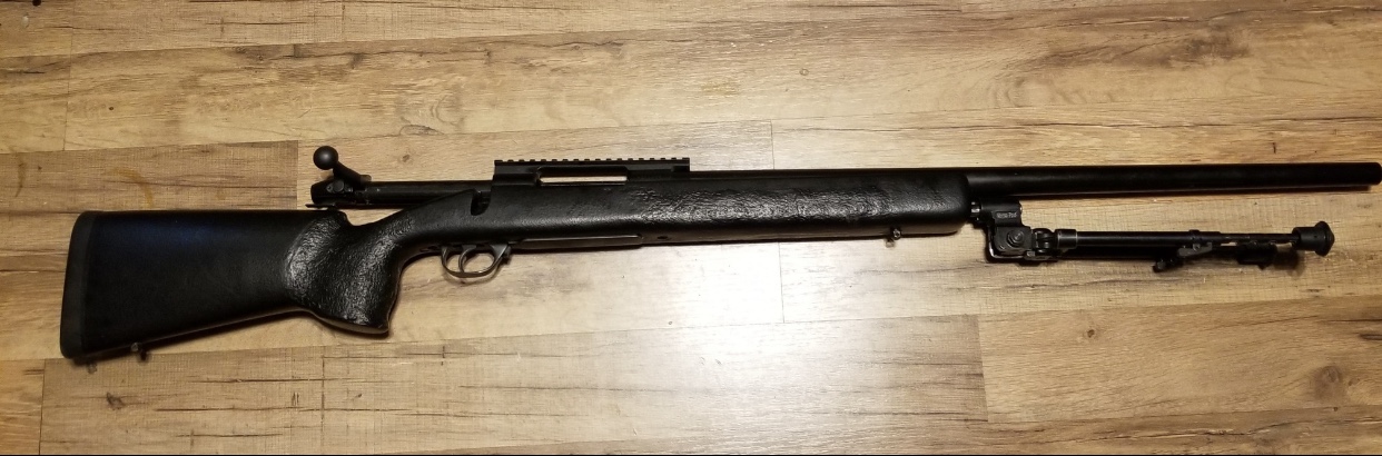

New member here. Sorry if this is the wrong place to ask this, but I came across this rifle that from my research looks like it could be a McMillan m86, but the guy that has it says it’s a Weatherby MK V action chambered in 300 weatherby. Has G McMillan & Co Phoenix Arizona stamped on the barrel and supposedly was built for a navy contract. Was curious if anyone has some insight on this.
