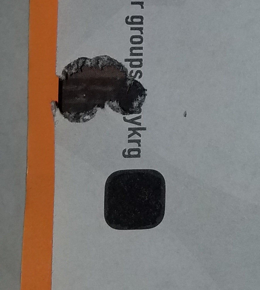

My rifle isn't glasses bed. My McMillan just has aluminum pillars and torqued in. And I get this kind of groups. Shoot it unbedded if it's to your standards leave it. If not try bedding
