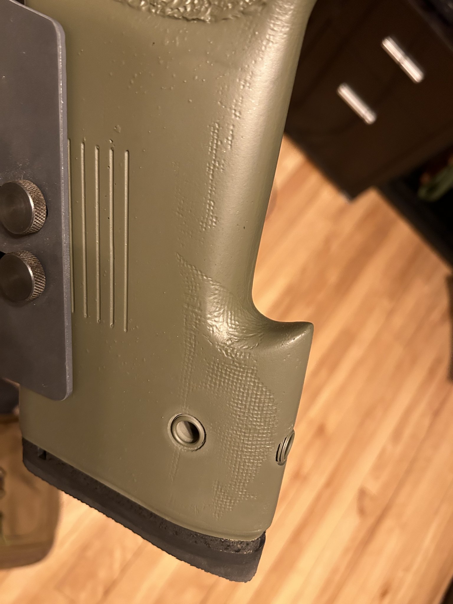

Hey there Hide,
So I recently impulse-purchased a McMillan A4 from their Ready-to-Ship section, knowing full well that I wasn't suuuper convinced by the transition paintjob it came in - but it had all the features I wanted in the inlet I wanted, so I figured what's the harm.
Once it showed up, my suspicion was confirmed and I didn't waste any time dropping it off with my local cerakote shop to give it a classic green makeover.

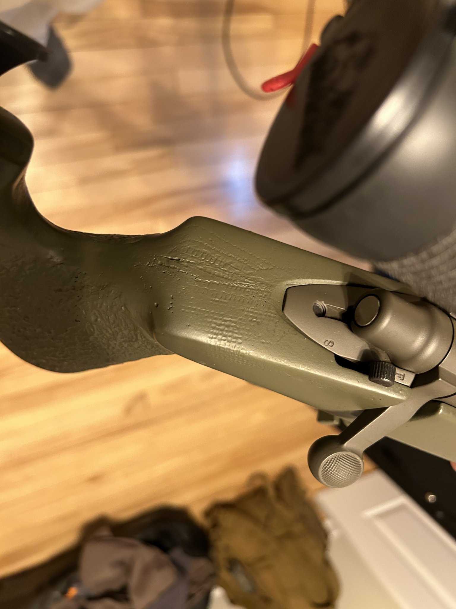

When I picked the stock back up, I noticed some pretty egregious surface blemishes that I hadn't noticed when the stock first showed up (see pictures).
My question for you:
Is there some sort of incompatibility between the Cerakote process and McMillan fibreglass stocks that I wasn't aware of and I did this to myself, or was there a QC issue with the stock that I didn't see when I received it?
If I don't want to ship it back to McMillan to fix, how would you recommend going about fixing the blemishes, if at all?

Honestly the fact you didn’t notice before you sent it off makes me strongly lean on your cerakote guy. I’ve owned a lot of McMillan stocks, and am fully aware of their mold lines, exposed fiberglass, etc.
That looks excessive, and I doubt it QC’d out like that. Sure, stuff gets missed, etc. but 3 things make me think sandblasting:
1. The flush cups are drilled pretty much last. They always have clean edges (with occasional minor chipping). The smoothing over of the stock material near the flush cups is indicative of sandblasting.
2. The texturing transition is usually sharp. Especially the web texture looks blurred and almost flattened at the transition line.
3. The bubbles you see are common in all fiberglass laid items. McMillan fills them in pretty religiously. Sandblasting would impact these heavily since it’s a different material so more prone to impact than the homogenous material around it.

To me that doesn't look like that was done with an abrasive. If done properly, any voids that are filled wouldn't exhibit breakout like that.
Not knowing what gel coat or resin system they use, my hunch is that they turned up the oven to cure the Cerakote too high for the stock. Then you get the gel coat exhibiting excessive shrinkage which shows the fabric weave.

Hard to tell in the pic but it almost looks like it shows evidence of sand blasting?
Abrasive blast would also give the same results as shown above! Good call.
In fact now that you brought it up, that might be my new #1 guess and pushing the sander to #2.

Oh geez, another sub-standard painter strikes again.
That stock has had the ever living hell blasted out of it. The blasting media will remove the gel coat and/or resin down to the fiberglass or carbon fiber fibers. It's repairable, can be restored, but you need to kick the guy that did this in the dick. If he did this to the stock and gave it back to you like this, there's not a chance that he knows how to repair 'em.
I've repaired several hundred stocks now that have had various stages of damage. Done several that were FAAAAAR worse than yours.
I can restore it, and i'll enjoy restoring it. If you want references, call Tom at Manners stocks, he'll confirm that i'm very capable. Terry tagged me, he's familiar with my work.

I could do a much nicer job than the OP got if was totally blindfolded and only used my left hand.
That stock got sand or soda blasted for sure.
The spacer on the butt gets blended by MacMillan. It doesn't get a valley blasted at the transition between the spacer and the butt pad.
I hope like hell you didn't pay much for that kind of work.
This should be a lesson for everyone that saving a few bucks isn't saving shit.
