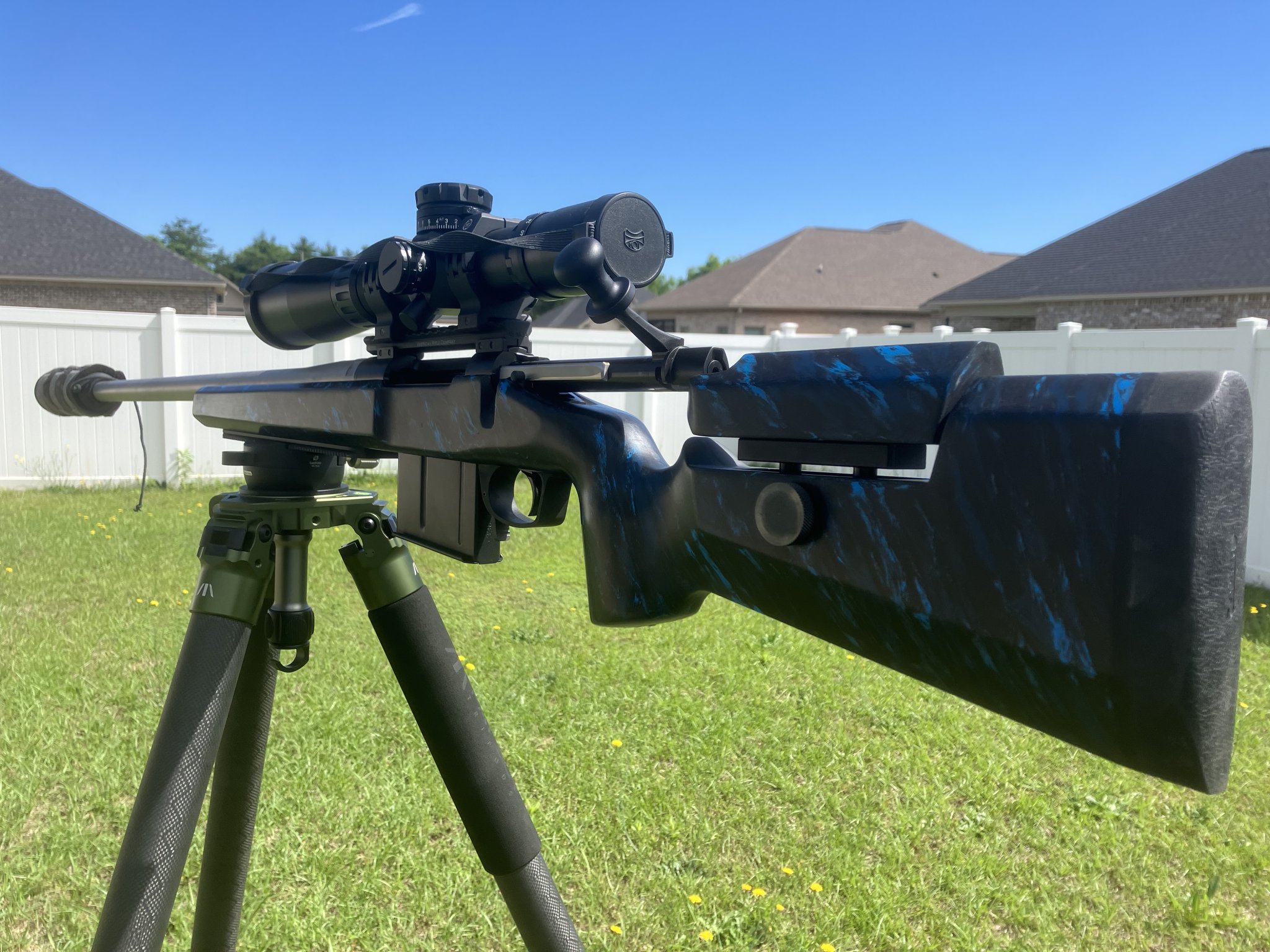

It looks like it can be ordered with an adjustable spacer system as an option.The T2a does not have an adjustable LOP. It does have KMW cheek riser.
