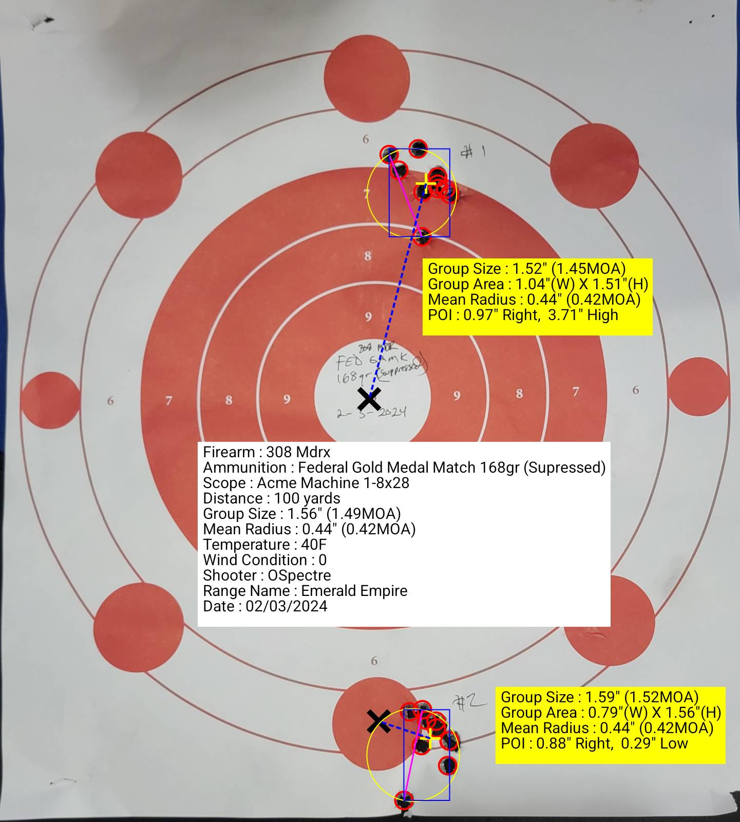

168gr Fed Gmmk 1.4moa average (10 shot groups) with a flyer in each.Elevation adjustment after the first group. 9 hole average is 1.15moa.

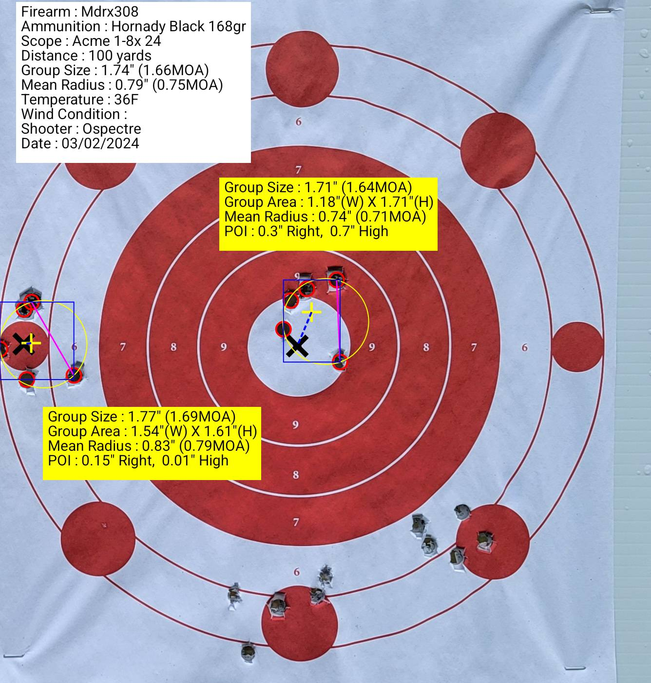

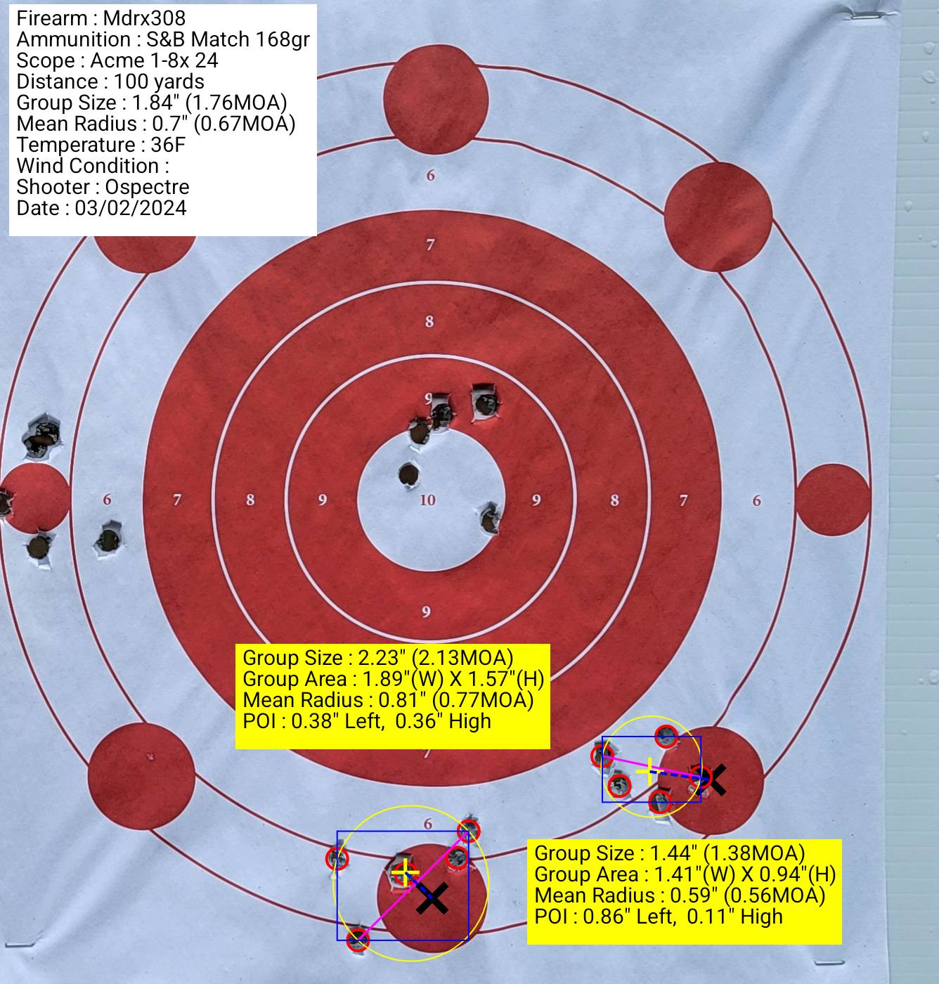

168gr S&B Match 1.7 moa 5 shot average
I didn't take my time on the first 5 (2.2moa) and was kinda tired...but took my time at my last 5 (1.3moa).
Much happier with these results. I think I'll keep it.
