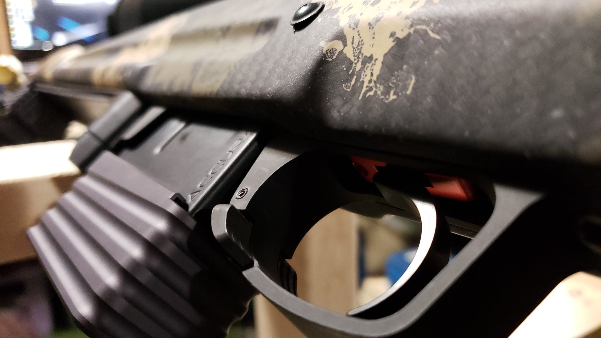

I have a couple MDT 12rd AICS mags and was thinking about adding the Area 419 +4 extension to one of them to try out. The +4 extension is designed to work with 5 and 10rd mags, but curious if anyone has tried the +4 on the 12rd mags and ran into any issues.
Thanks for confirming. I'll give one a try and see how it goes.
The 419 extensions are awesome. Run flawlessly and very well machined.

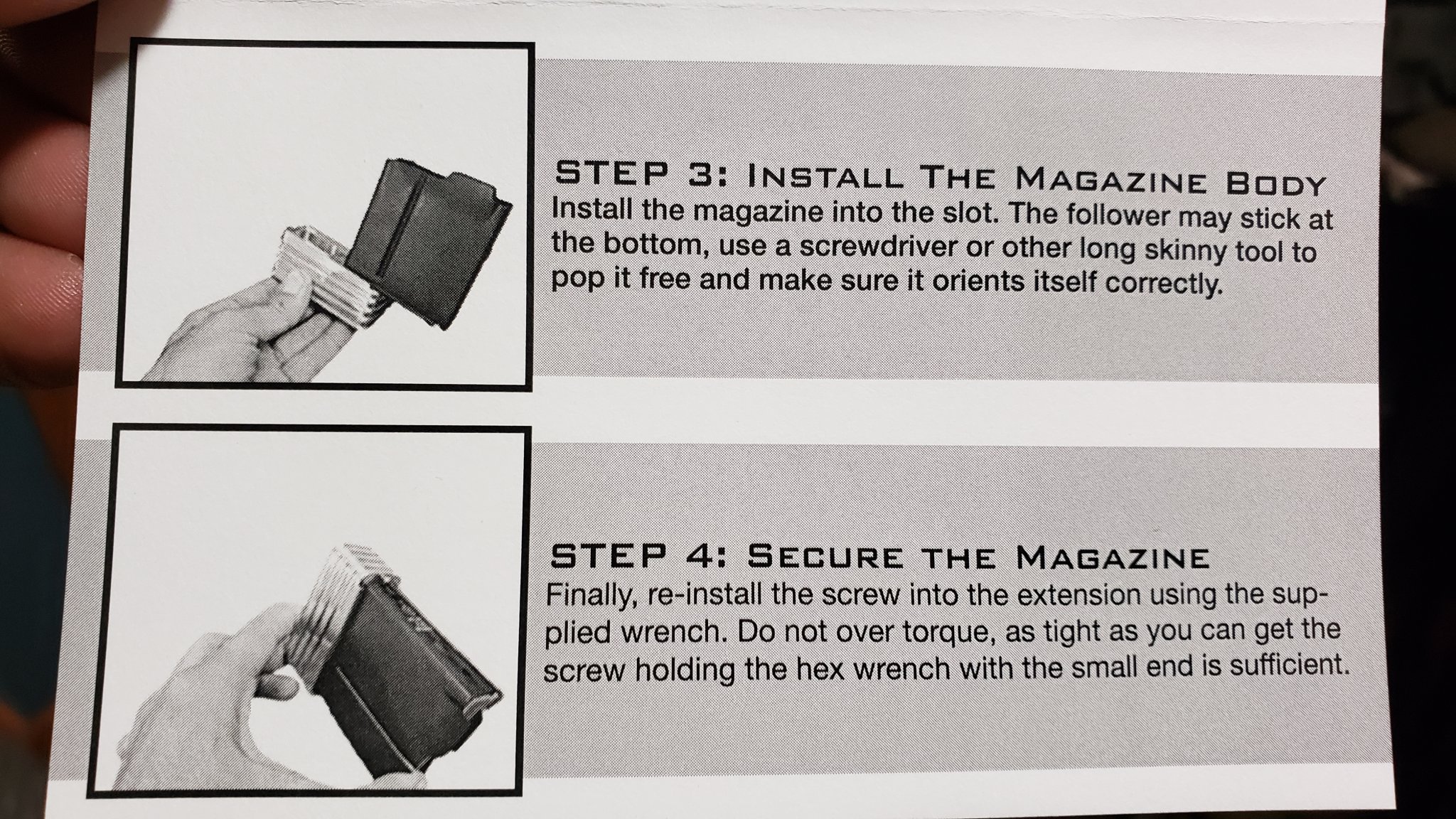

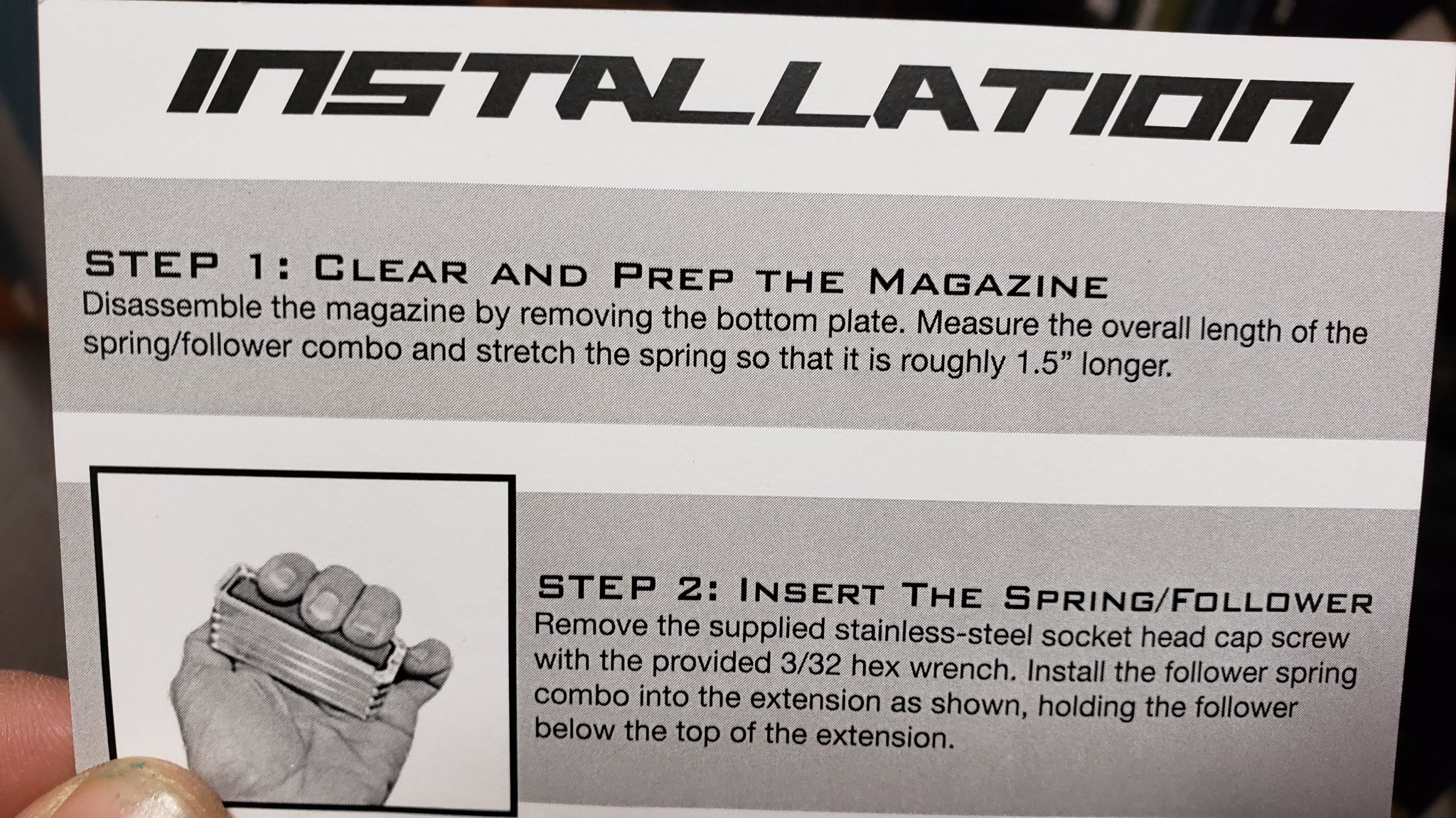

Generally, you will need to elongate the spring a few inches to keep enough tension to move rounds upwards. It's part of the 419 install instructions.
I actually went and checked the two unopened boxes I have for two of their extensions and neither have instructions, just a sticker and an Allen wrench. I feel less stupid lol. So just stretch the spring out?
Here are instructions.
Here you go. I was wrong; it's 1.5" longer than current "stock" configuration follower + spring.
7041489
7041495

Wish I read these posts before picking up the Area 419 extension. Definitely doesn't work with my MDT 10-round magazine with the stock mag spring. Pretty lame that I now need to get an extended mag spring to get these to work.
I use the standard MDT mag/spring with 419 extensions. Zero issues. But you do need to stretch the spring slight before Installation. Should be in the instructions included with the Area 419 extension. Have 3 mags setup this way. No issues all of last season or this season.
