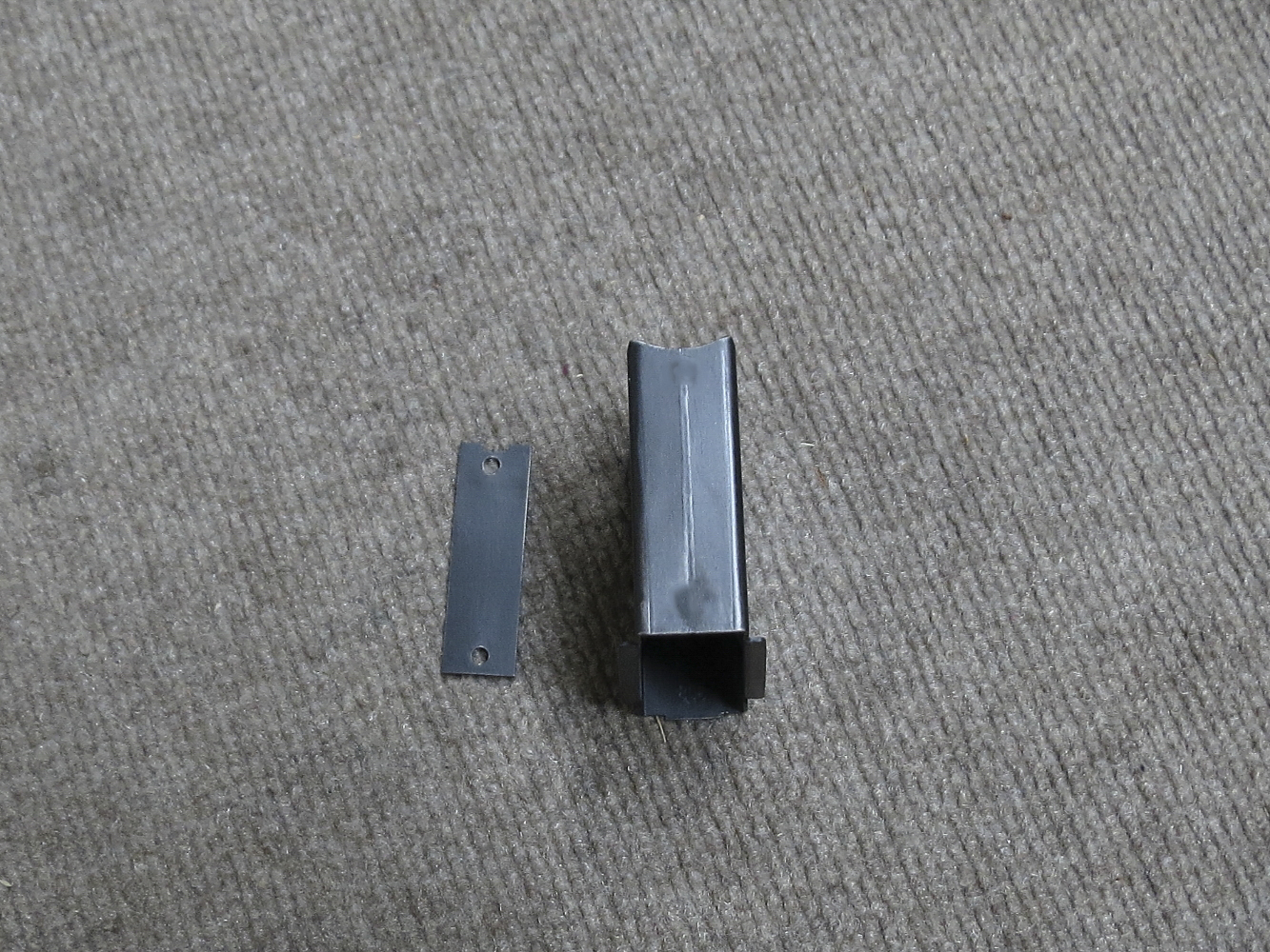

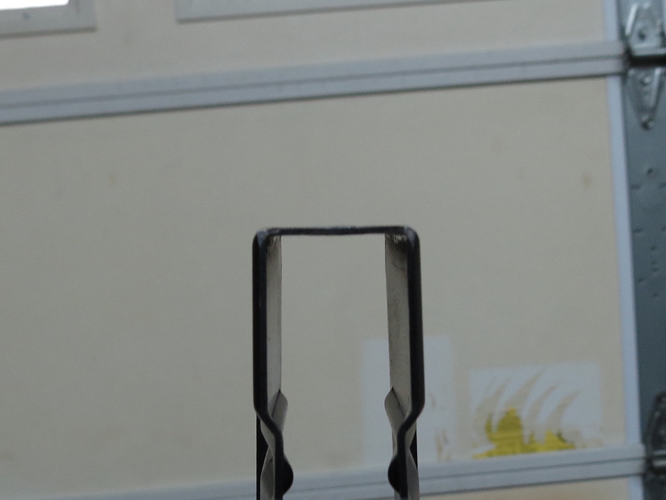

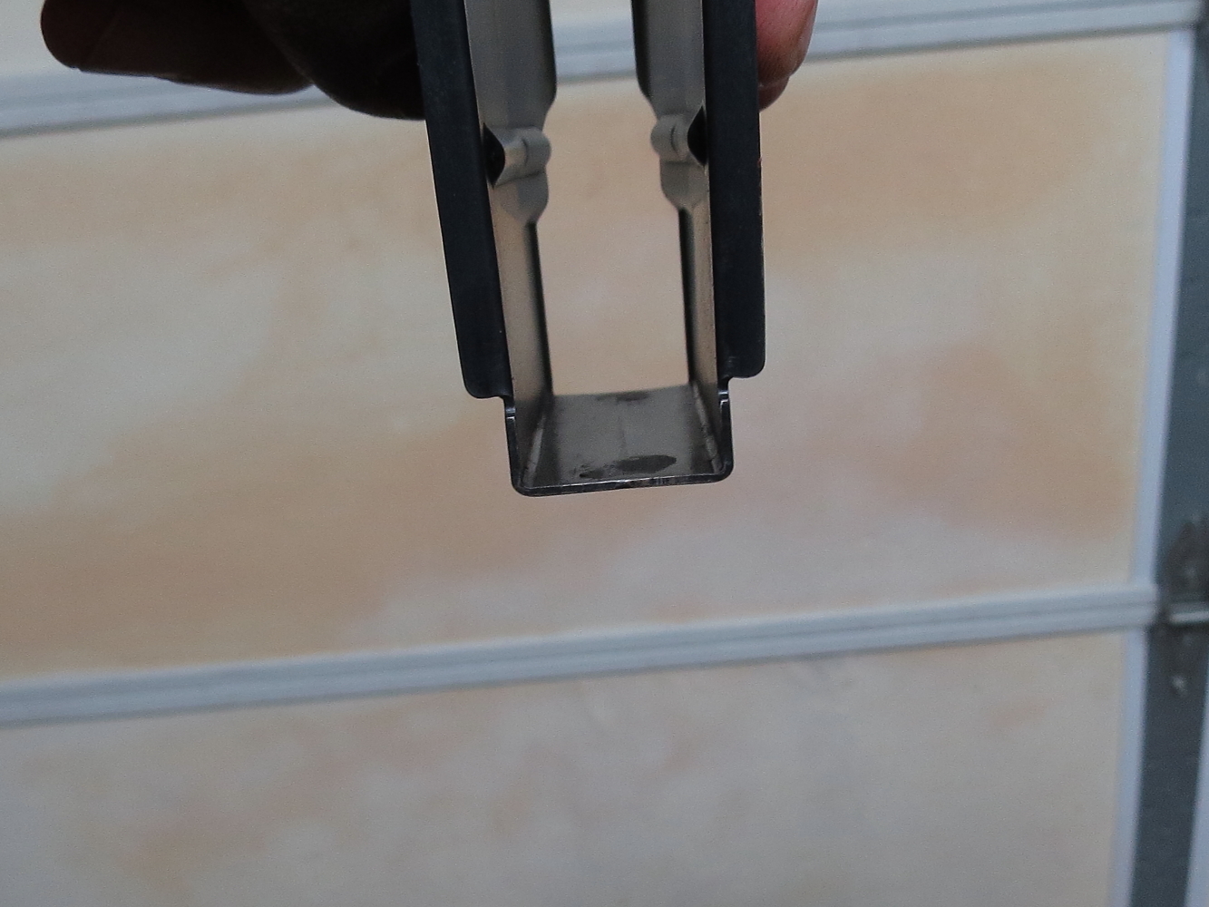

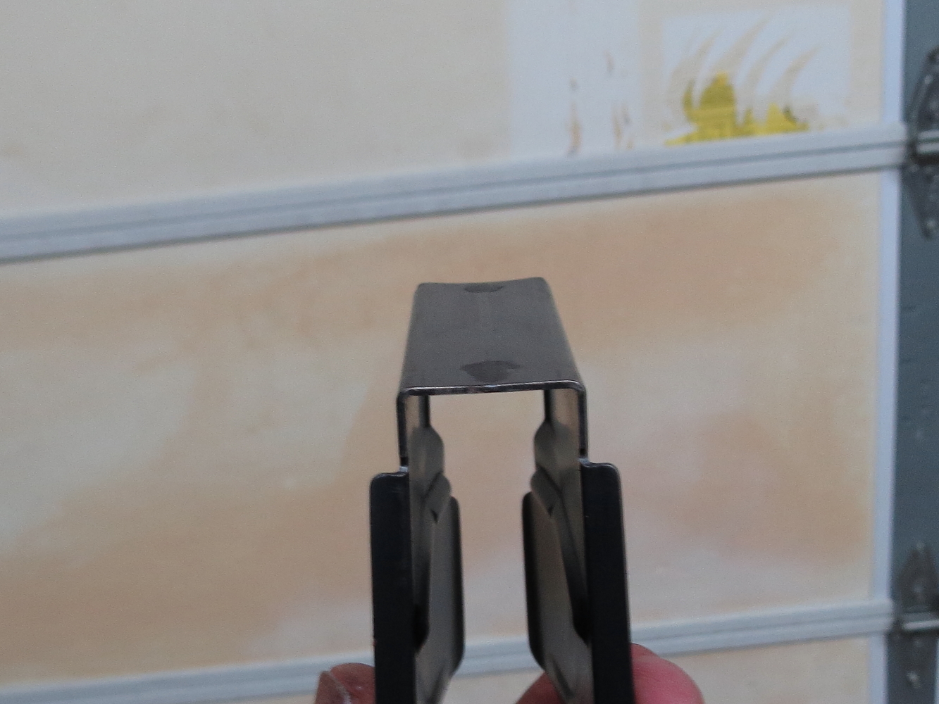

People have been drilling out binder plates and filling the holes for years.
I've drilled out several of them including the MDT 5 rounder.
Some people fill the holes with tig weld and some use epoxy.
I used JB weld epoxy and sanded them smooth after it set up and I've put dozens of rounds through them without a single problem.....
MDT 5 round

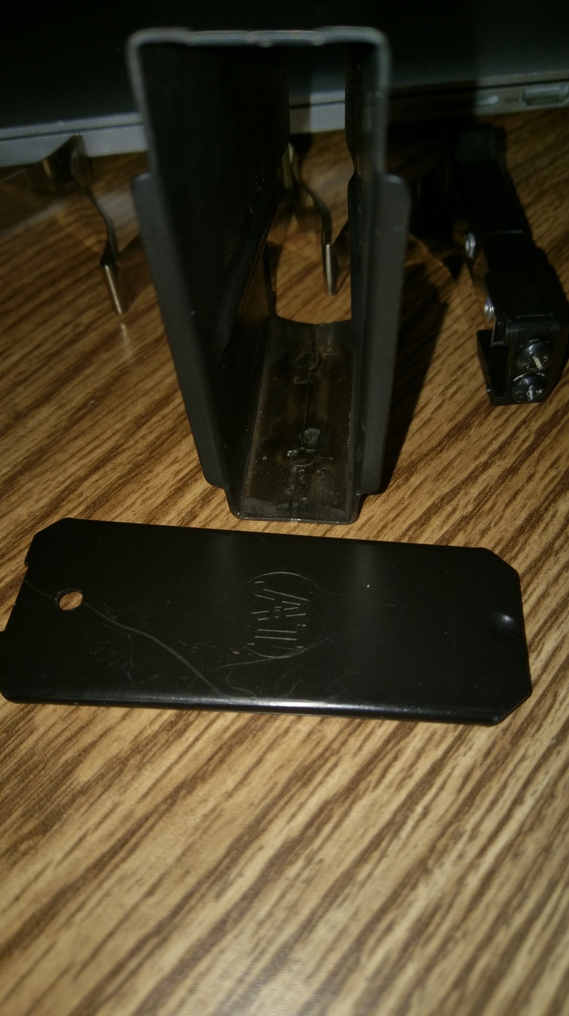

I have removed the binder from both Accurate and AI mags. I have MDT mags but they came without a binder plate.
There many ways to do this but I did not want to weld holes, and I can weld.
I mark the spot welds on the inside of the mag, I then use a carbide burr on a dremel to remove material from the binder.
You need to make sure you dont go too deep and make sure to cut a large enough circle to remove the weld.
When I have enough material removed I take a SHARP wood chisel and a small hammer and with the flat side of the chisel up against the mag I start to peel the binder away from the mag using soft blows from the hammer.
You need to go slow and check if you have ground enough away so the the weld breaks away without damaging the mag.
If not, just stop and go back to grinding.
Added a few pics of the MDT 5 rounder to my post above.....
