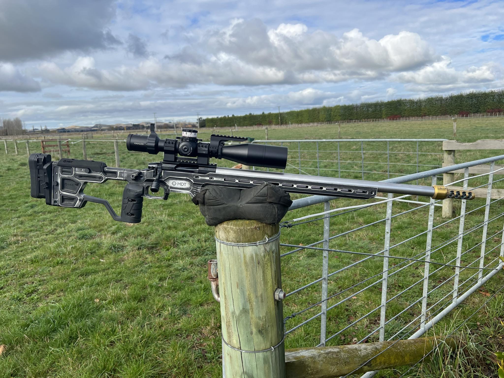

That looks wicked mate, and the gold TMB is sweet! I did remove the butt spacer, more so for my T-Rex arms but did drop a bit of weight from the rear.
The bridges aren't to everyones taste, but that's what gives me most control over the wobble and keeping the rifle on target once the shot breaks. Ive tried hand on the scope bell, and thumb clamping down on a side weight and always found myself either inducing wobble or cant.

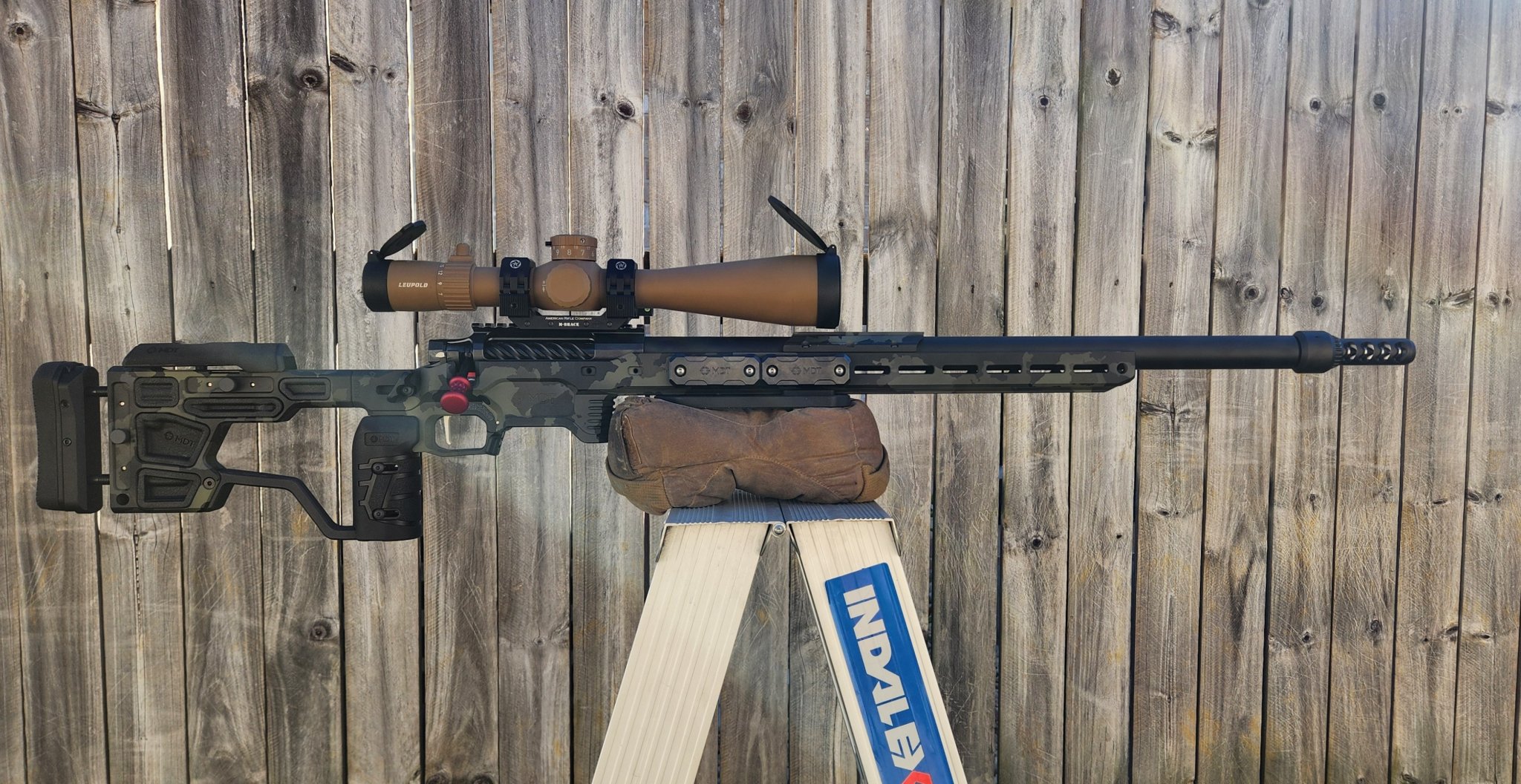

I run Impact action, ZCO 5-27, 26" M24 (6CM) with full internal weight and 2x external mounted on the fore-end. Also a set of baker wings. Rifle is dead stable, though heavy at 23.5lbs. Also running the spacer on the rear as I have a giraffe neck and need the push back to get into the eye-box.
Balances on the back of a folding chair with a Schmedium game changer no problem. I've found if you're picky about the balance point, using a chair (1" tube, basically) is a better predictor of balance than a wide surface like a 2x4 or ladder, which can provide more support/distribution.
