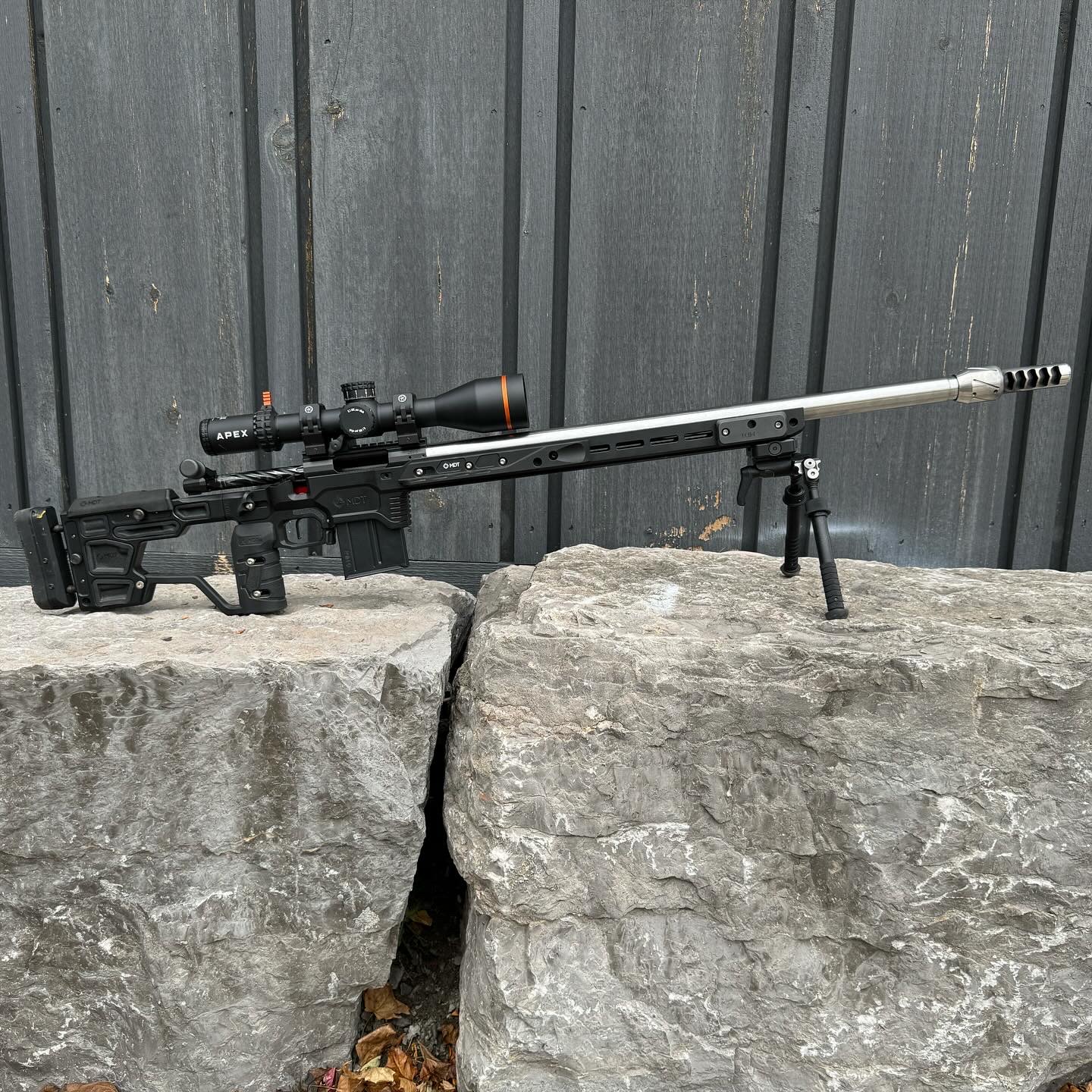

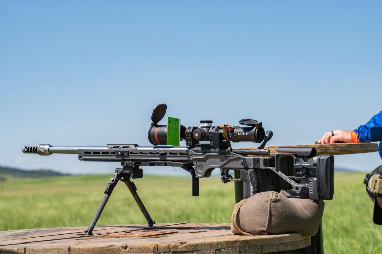

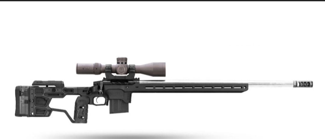

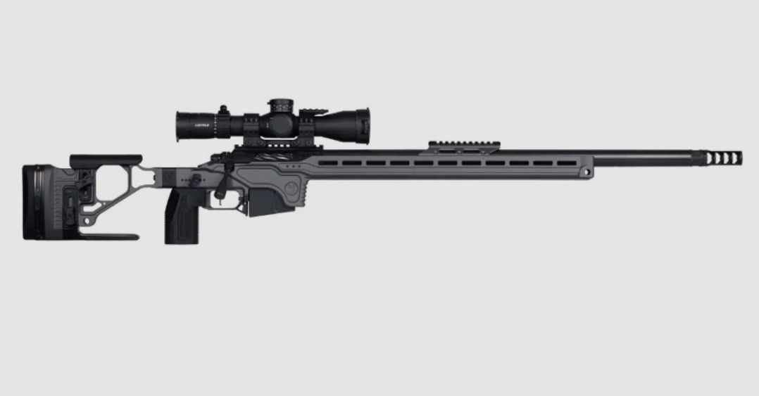

I haven't found any threads comparing these 2 yet. Wonder if there just aren't many people who have had time behind the vision pro.
I'm in the market for a new chassis to replace my PRS-TCS. The distance from grip to trigger is just too big for my hands. I'd like to go with chassis over stock for added adjustability also. This will be used for PRS.
At first glance they look very similar. The buttstocks are different and I do like the adjustable bag rider on the vision. Price wise is very similar here in Canada. Vision is 10% more. Not sure its enough to make a difference, but MDT also has a wicked black friday sale that I could have some luck in this year making it a little cheaper. I like how the Vision is ambi, seeing as I'm a lefty, and if I decide to sell it for whatever reason I have a bigger market to sell to. I'll most likely be adding accessories to it as well, like a control bridge or weights.
Wondering what people think about the differences between the 2 and if one was a clear winner (for those who have handled both).

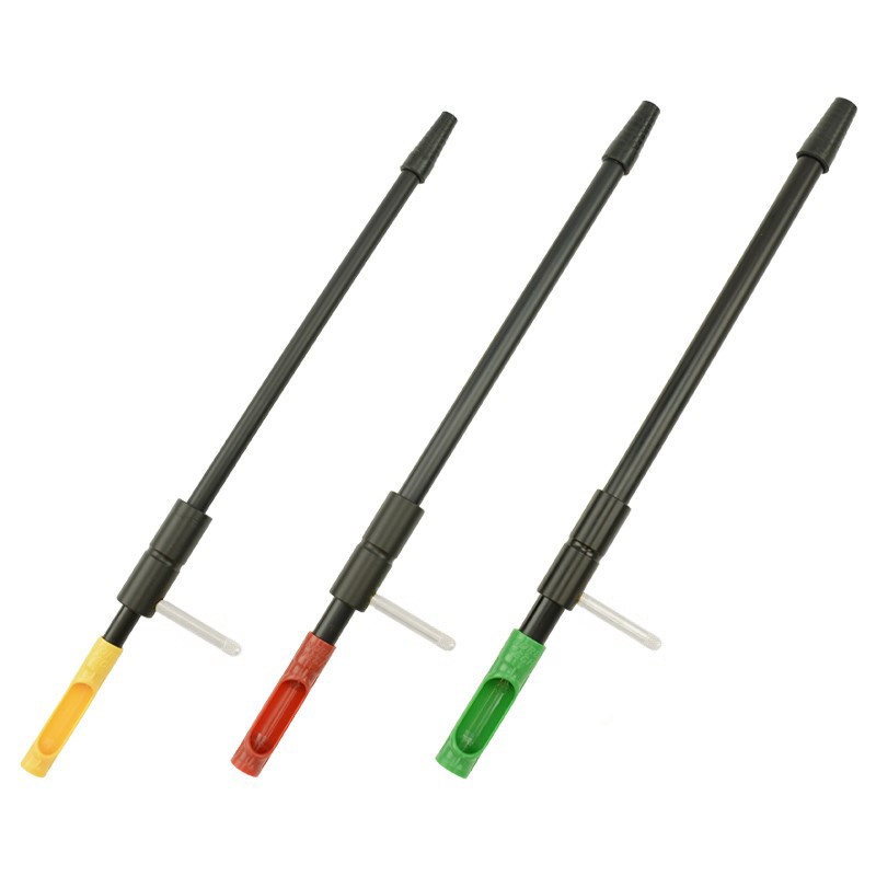

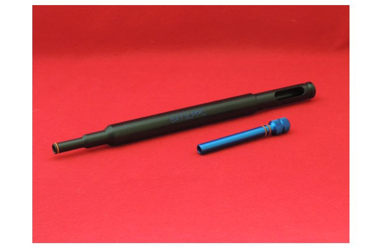

Well, it turns out that if you don’t use a PMA bore guide (largest known to mankind lol) a bore guide fits just fine.
First tried this type which is thin. This is a pic from BoreTech but the same item is sold under many other brands
Fit just fine, ran a rod down the bore and it wasn’t touching the bore walls. Nice and smooth.

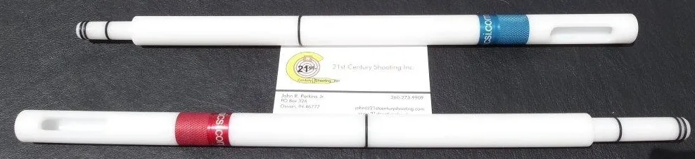

Then I tried a Delrin guide similar to this and it too fit straight plumb and true. Ran a rod again, no contact
Just thought a little clarification was in order.
P.S. - I found the one I used...it was this one from 21st Century Innovation (was 21st Century Shooting) which is a very nicely made Delrin guide and is a bit sizable itself. Fit fine. I have a few things from John at 21st and I'm quite happy with them. Nice outfit IMO.
