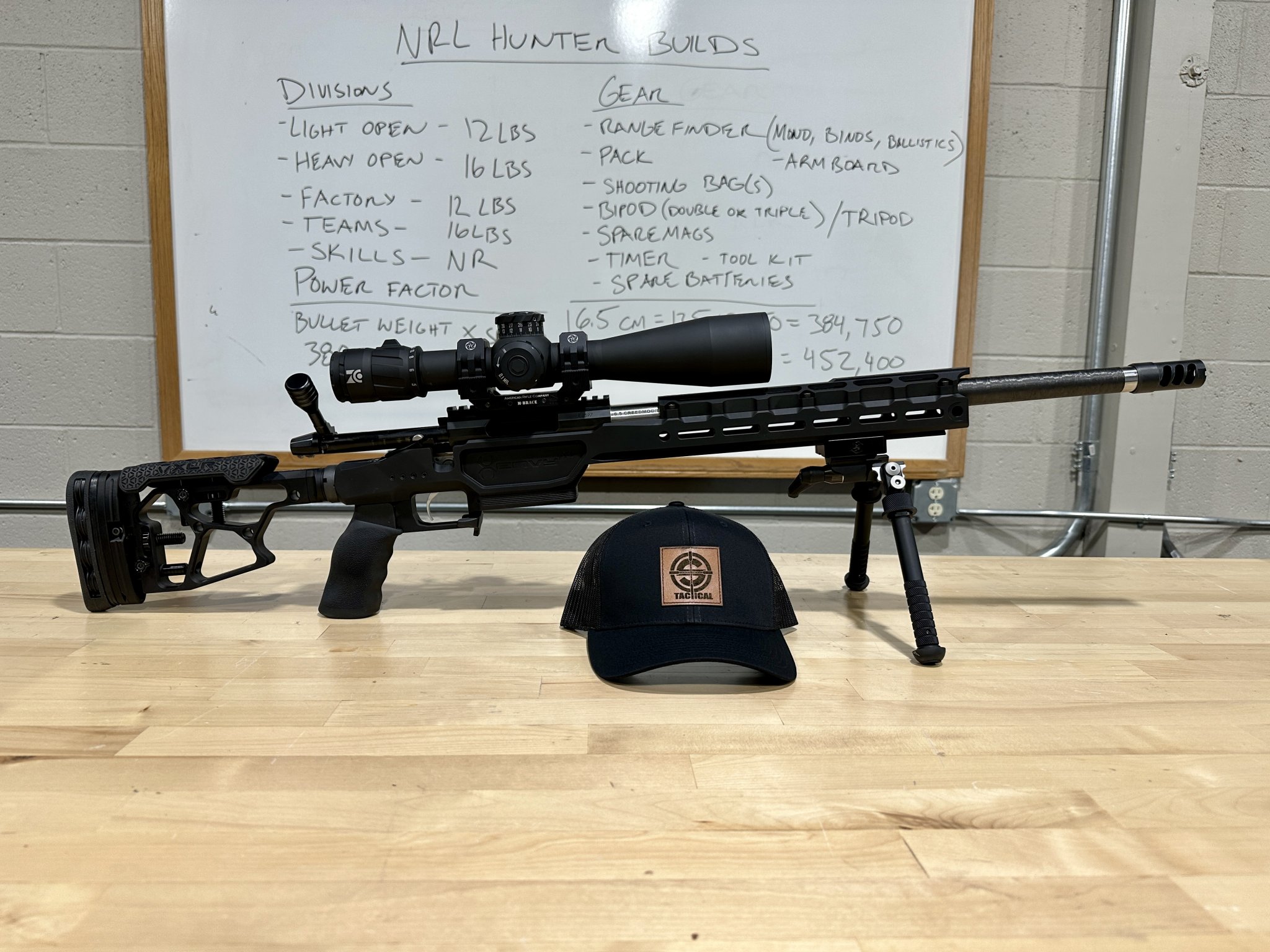

I've had a similar experience balancing the ACC. I am currently running a 26" M24, the lightweight buttplate, NV bridge. It takes 4 internal weights and 2 pairs of exterior weights to balance 4" in front of the magwell. With a gen 2 razor rifle is 20.4 lbs. With a lighter scope you could probably run it a pound or so lighter and still balance.
Similar I didn’t want to overweight it. 26” MTU, full length internal and one set of external weights with the aluminum butt plate is about perfect.
With the steel plate I balanced right in front of the mag well.
I’m thinking with the aluminum butt plate, and if I remove the treaded rods from the butt stock I might be able to make nrl hunter weight with a carbon barrel.
