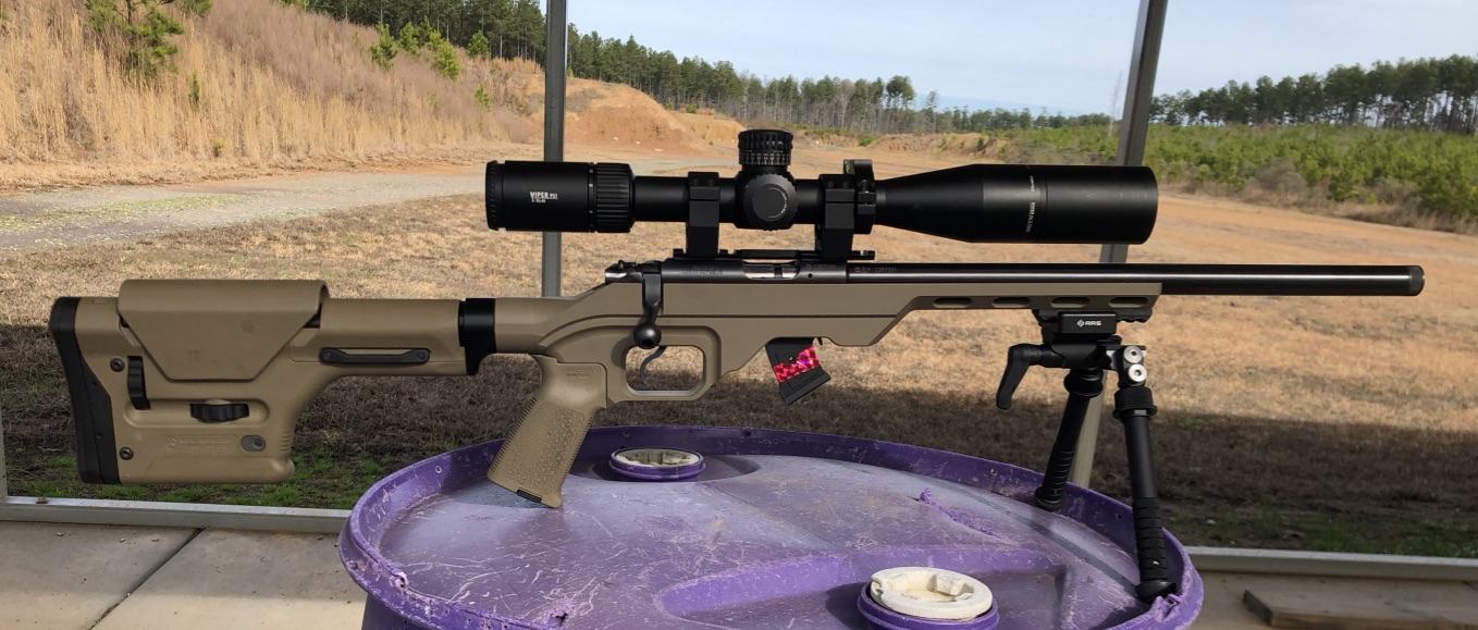

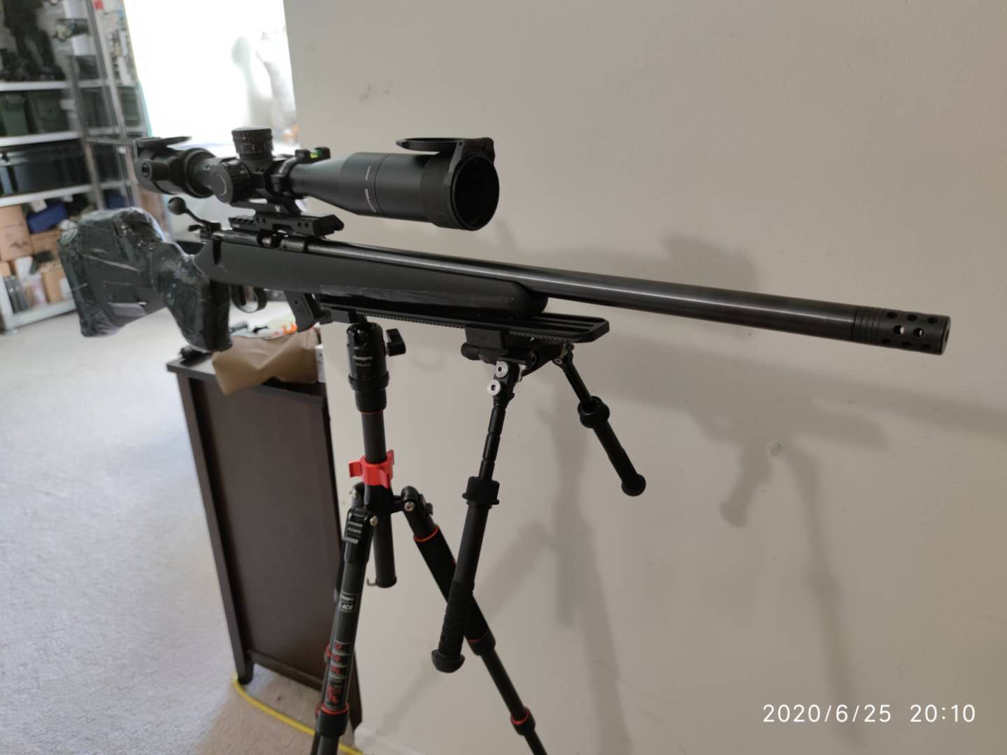

MDT Chassis VS More Ammo / Practice (CZ455)
kermit the monster
May 12, 2020
44
22
Hey guys. I wanted to get into PRS/NRL Matches so I picked up a CZ455 as a trainer rifle recently. I'm currently using the original polymer stock it came with. Duct taped a vertical grip and cheek rest on it. Sanded the for-end a little to "free float it" (but unsure how free it is when the polymer flexes ever so slightly).
In your opinion, how important is it to get a chassis? For the same I have the option of either picking up kitted out MDT chassis for the 455 or getting ~6,500 rounds of CCI Standard Velocity.
Which would be most beneficial in the short term? Will I have to buy the chassis eventually?

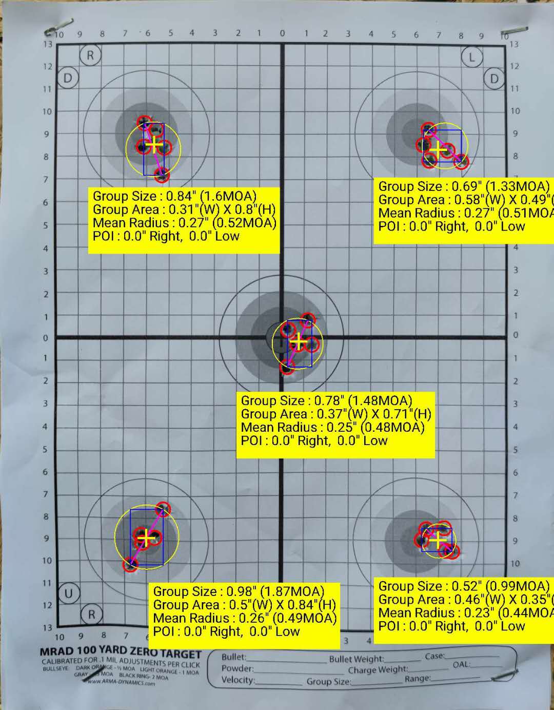

Would appreciate any input, thanks. Included a target I shot today in okay conditions. Little bit windy, but not excessive.

How well does that rifle group in better condition? Are you shooting off a tripod or prone? You should get the rifle to consistently shoot at least .9moa at 50 yards.
For PRS and nrl22 to type stuff you can do majority of it just dry firing. Don't need to shoot 6500 rounds of ammo.
It looks like you have your set up pretty comfortable for yourself. Get a few boxes of SK+. Stop using CCI SV.
Reactions: kermit the monster
This was in prone with a sticky brick rear bag. I usually shoot USPSA/IDPA so this rifle shooting thing is new to me.
I've been able to squeeze out quite a few 9.9-1.1 MOA groups with CCI SV, however not consistently. Lots of the bad shots in these groups were operator error. Either fatigue, eyes not focusing properly, forgetting to squeeze the trigger properly.
I've only put a box of STD+ in this gun, got some groups of 0.8-1.0. It's a comfy setup, but I'm just worried not using a chassis is preventing me from squeezing all the accuracy I can out of the rifle.
I know you mentioned 0.9 MOA as a standard for 50 yards, is that what's necessary to be competitive in PRS or NRL? Appreciate the input, thanks!
NRL22 generally has 1/4" targets at 35yards. That's where they stretch the most out of the rifle. .5" at 50 is common. 2" at 100yards is common.
If you strap your rifle into a vise, and shoot it, you can check it's potential if you don't trust yourself as a shooter. The chassis isn't going to make the rifle shoot better, it might make you shoot better if it makes you feel more comfortable. Things that I had issues from the base stock that you seem to have modified -
No cheek rest - you fixed that.
Rounded bottom that made it wobbly on barricades - you seemed to have filed/installed an arca rail so you're fine.
Vertical Grip - you fixed that.
Learn to shoot a heavy trigger, then get a lighter one. Don't jump to a lighter trigger if you can't properly shoot a heavy trigger, just bad fundamentals.
So if I was in your spot, what a chassis lends me would be -
I can throw weights on there to get a better balance. That's about it tbh, I got a chassis because I'm not handy and didn't want to engineer my own cheek rest, arca rail, vert grip. But you seemed to have solved almost of that, except the balance. Also your rifle is pretty light which makes it a bit more unstable on barricades. You could solve that by just filling the stock and foreend with lead too.
CCI SV can shoot well... it's just not consistent. It's hard to shop for lots. You're constantly rezeroing and redoping every brick you buy. Lot test some SK+ from goodshootinginc, buy a case. Call yourself good for a year.
