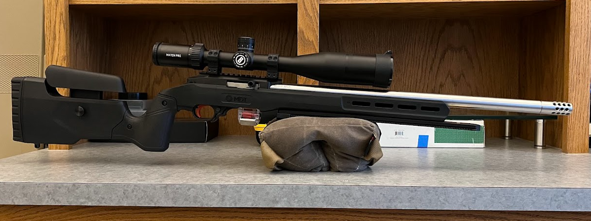

I'll start off by saying I am probably not the typical 10/22 shooter so take what I value with a grain of salt. I'm an NRL/PRS guy who enjoys positional shooting. I don't shoot bench rest (outside of ammo testing) and I don't do a lot of off-hand rimfire shooting. That being said, I've been looking for a decent stock option for my 10/22 that would allow me to shoot it like my NRL/PRS guns (Vudoo 360 and CZ 457). I will probably never compete with the 10/22, I just like the idea of being able to and shoot those types of courses for fun.

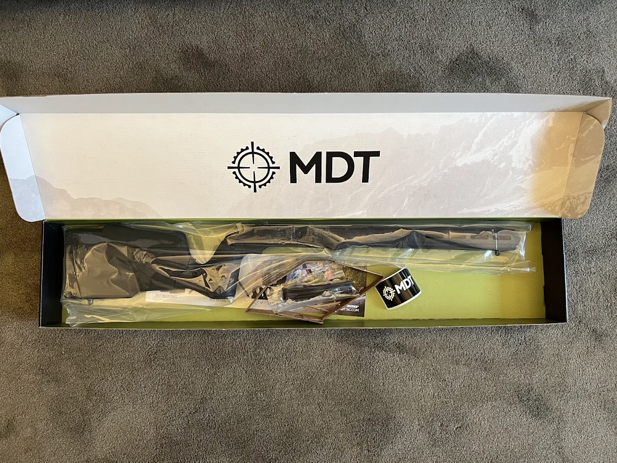

View attachment 8573289View attachment 8573270

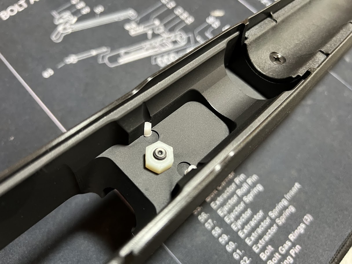

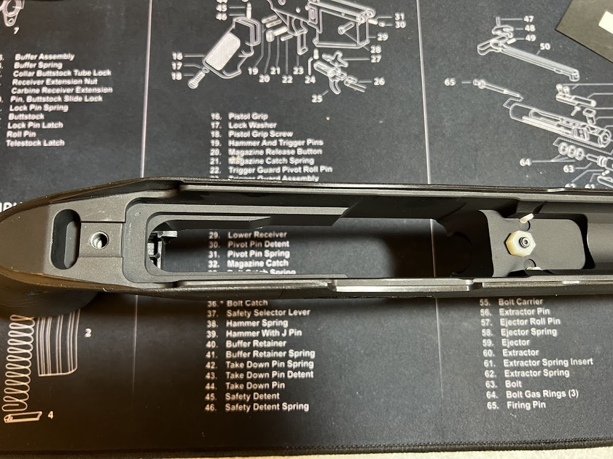

Inletting
- Aluminum Inletting gives the receiver a solid surface to mate to. Similar to having a Mini Chassis or V-Block bedding.
View attachment 8573283View attachment 8573301

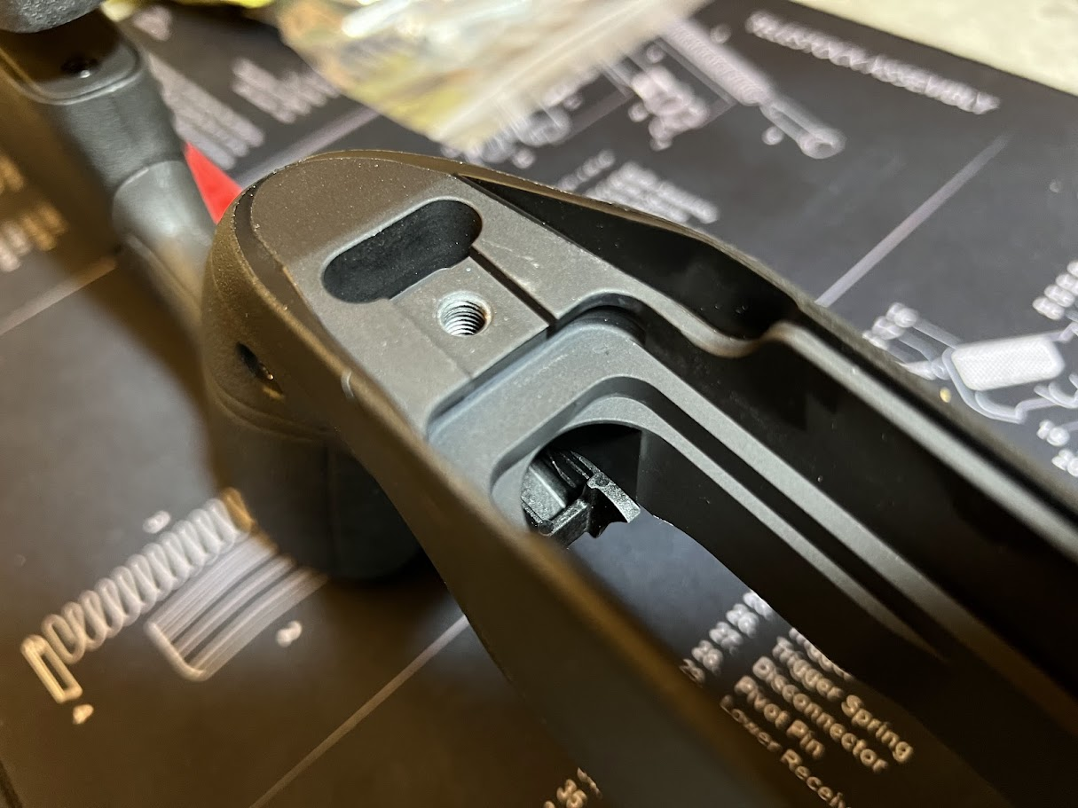

Rear Anchor - Having a rear anchor system is really nice for performance. The system they developed for this stock is an idea I’ve heard kicked around for a while. It doesn’t seem like the most secure method, but it is better than nothing. You can see they use a plastic/polymer buffer bar that is longer than normal to attach the rear anchor. The buffer is also held in place by the stock when installed.
View attachment 8573284View attachment 8573285

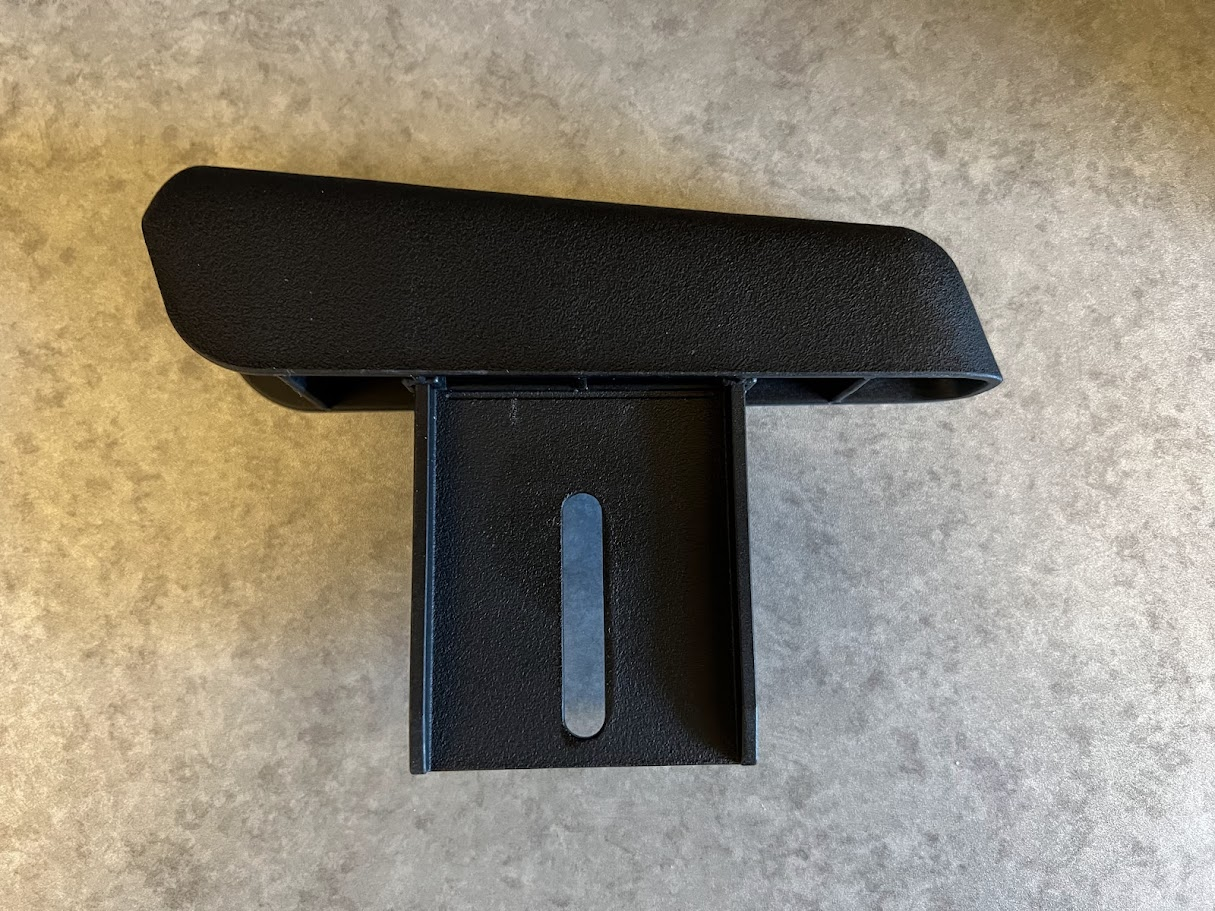

Cheek Comb Riser - I understand why they used this design. It is very cost efficient. However, the system is not great at staying in place. The thumb screw can only go so tight without pulling out pliers and the cheek riser will still move with a moderate amount of force. Not that I usually press on my cheek comb hard, but I also don’t usually expect it to move if I put a bit more than normal cheek pressure on it. The cheek riser is also quite narrow so not the most comfortable.

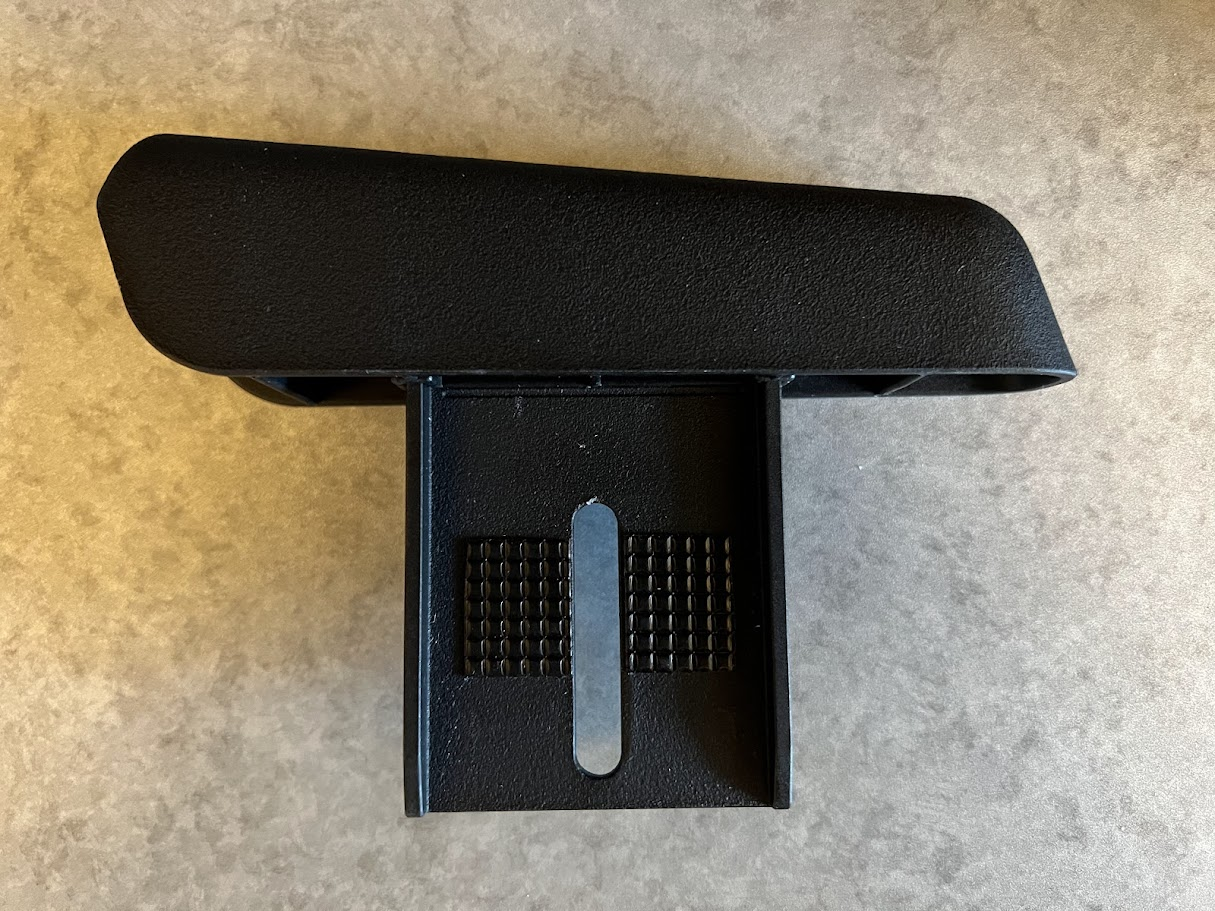

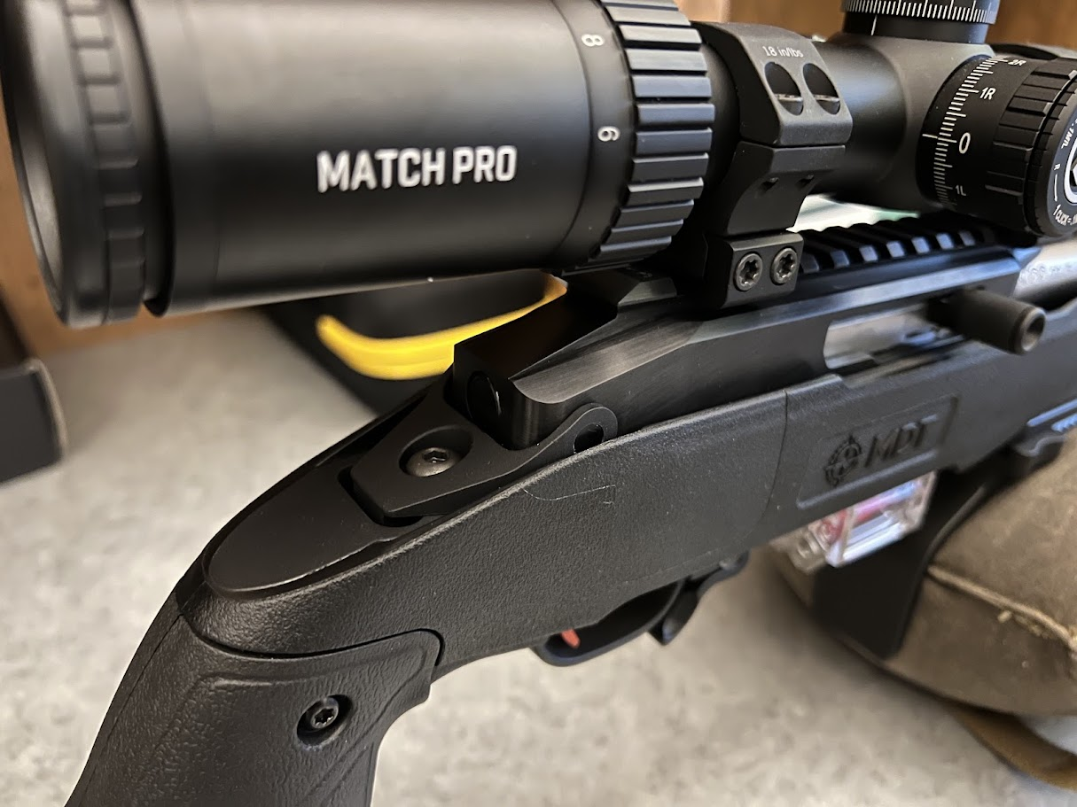

My fix for both of these issues were pretty simple. I added a little bit of stick on rubber to the inside of the riser pillar and it seems to work. Had to get the placement right as going too low it would just get stuck. I also added some foam padding to the cheek comb to make it more comfortable and a little wider.
View attachment 8573304View attachment 8573292

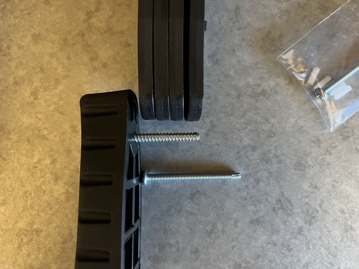

LOP Hardware

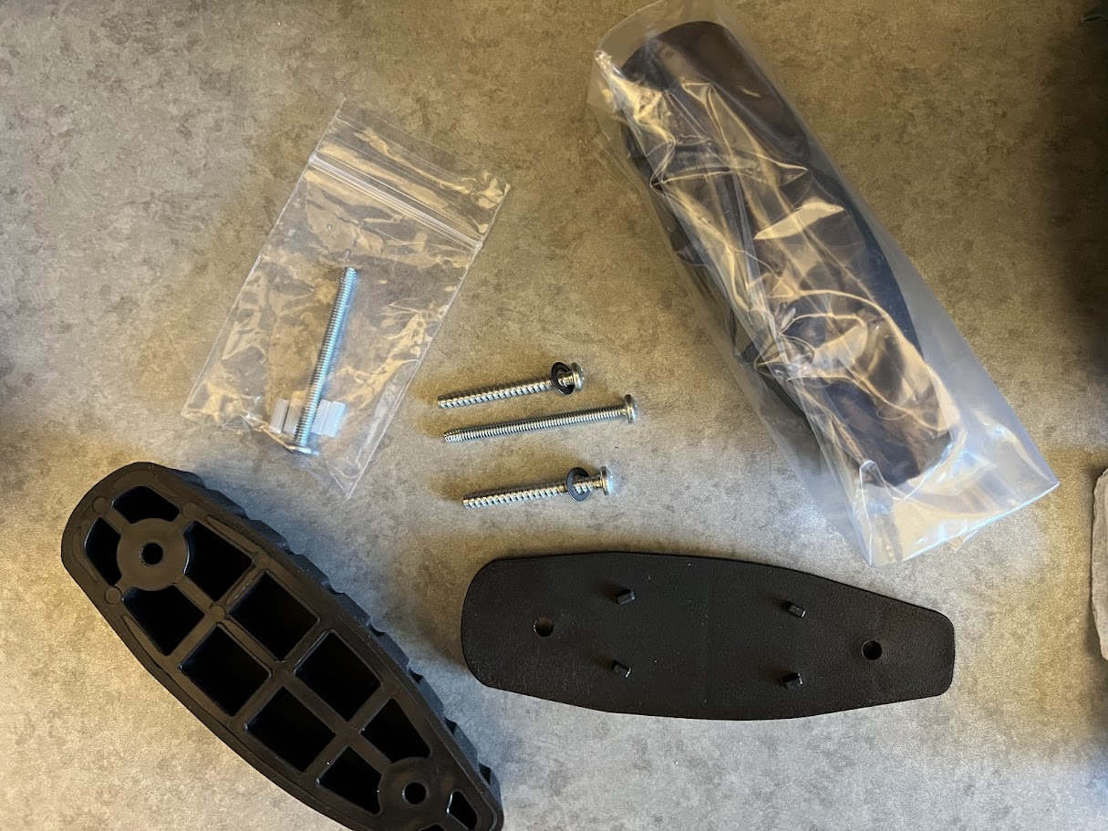

- MDT was nice enough to include the spacers. A lot of their stocks don’t come with them, though I’d take $30 off the price to not have them. The stock comes with a 14 inch Length of Pull with a single spacer installed from the factory. I pulled this 1/4 in spacer out to get a 13.75 in LOP. The gripe is about the hardware they include and use to secure the buttpad. The phillips head screws are in there super tight and it’s hard to not strip them while removing them. Hex screws would have been much nicer. Also, the longer screws they include for increasing LOP are not the same thread pitch. They’ll work since they’re just screwing into plastic, but how hard would it be to just use the same type of hardware?
View attachment 8573293View attachment 8573294
