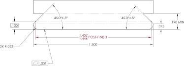

Have you looked up what the external dimensions should be and verified they are within spec ?

Or the ARCA rail is too small. That would have to be noticable if you had any other ARCA attachments to test it with though. So I'm still voting user error.

There isn't a dimension standard for ARCA rails like there is for a Picatinny rail. There are variations and incompatibilities. Some manufacturers of clamps have addressed the issue. How old is your MDT?
