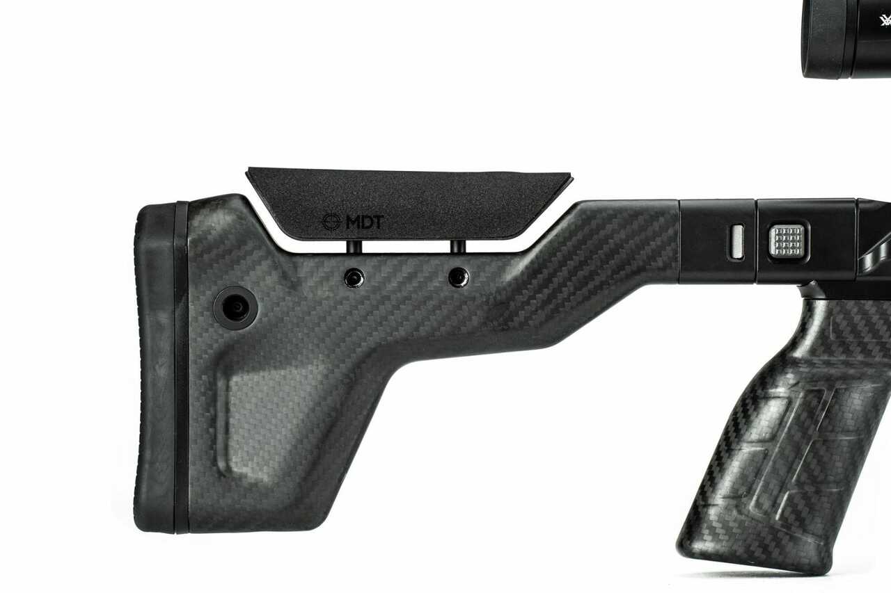

MDT HNT26 Tikka LA
HowiePb82
Sep 21, 2018
55
43

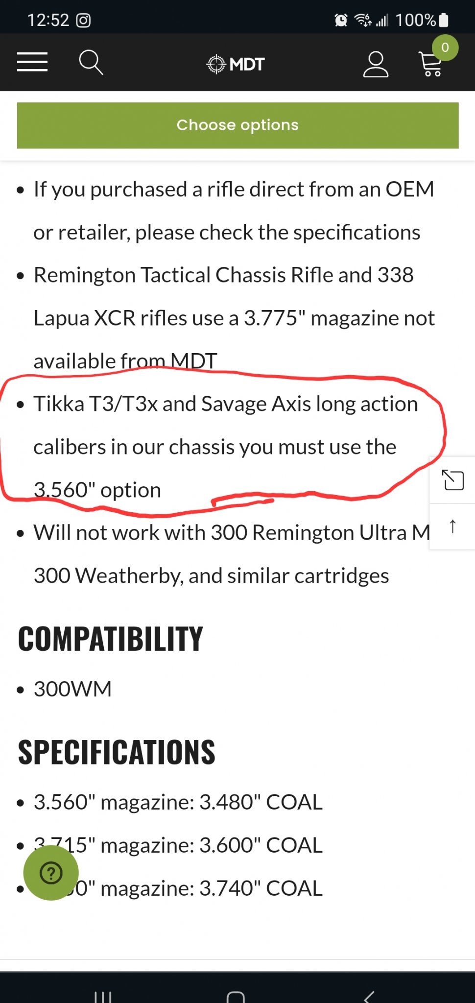

Hey guys, I bought MDT HNT 26 for Tikka LA 300wm and I can’t get any of my LA mags to fit. Has anyone else had this problem? It won’t fit any of the AI mags or any of the MDT mags, Magpul AICS mags. I left MDT a message but I plan to follow up with them. Just wanted to see if anyone had the issue.
What mag length are they? MDT uses the 3.560" options for Tikka LA footprints.
