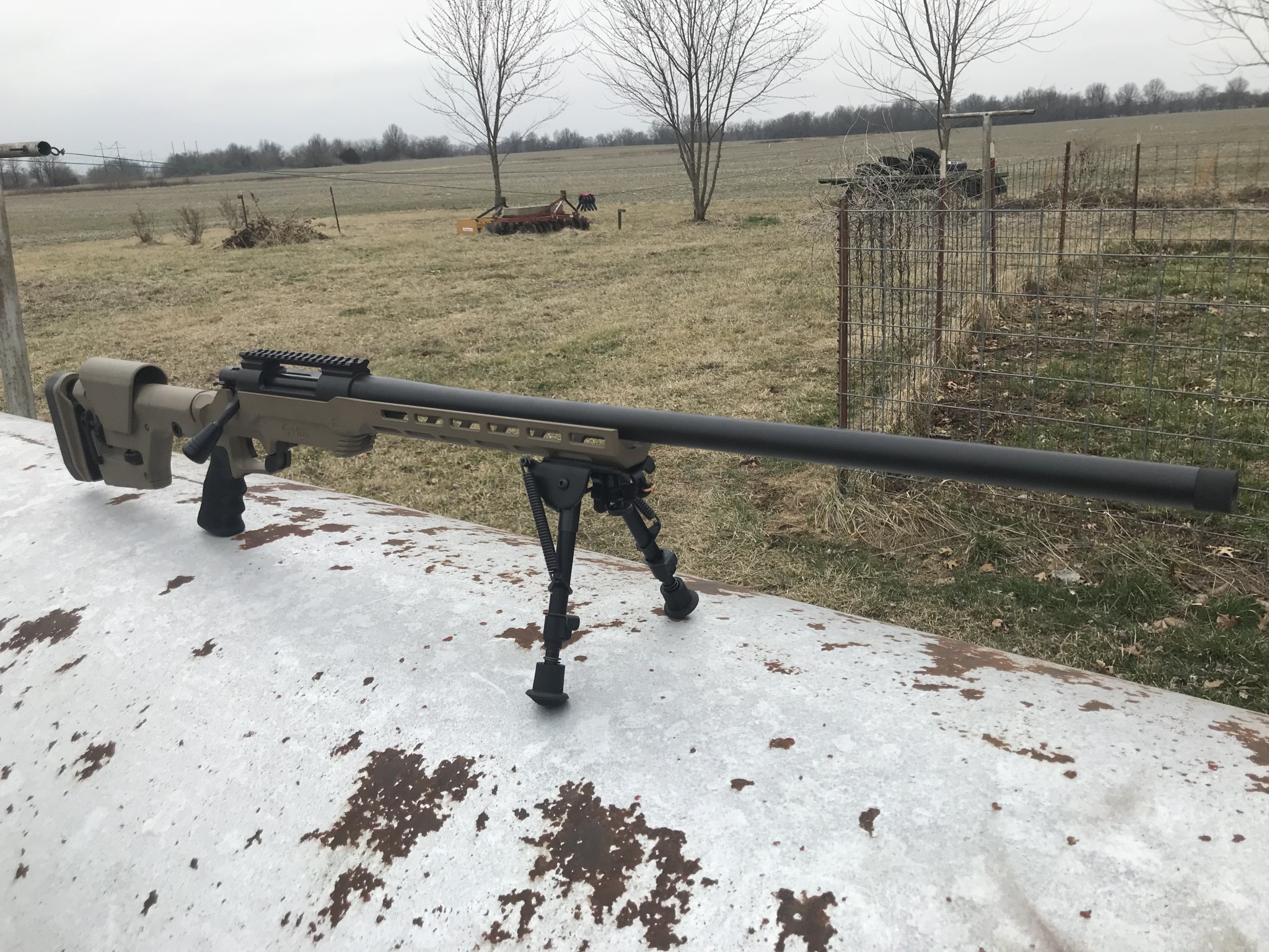

I built a Howa 1500 LA 300 Win mag and put it into a LSS-XL Gen 2 chassis. The chassis seems to have a lot of flex between the mag well and forend. Anyone have any ideas on how to fix the flex? I was shooting at 700 yards yesterday and just noticed that with little movement I could make the cross hairs go way off target from the chassis flexing. Maybe my best bet would be to switch to a different stock?

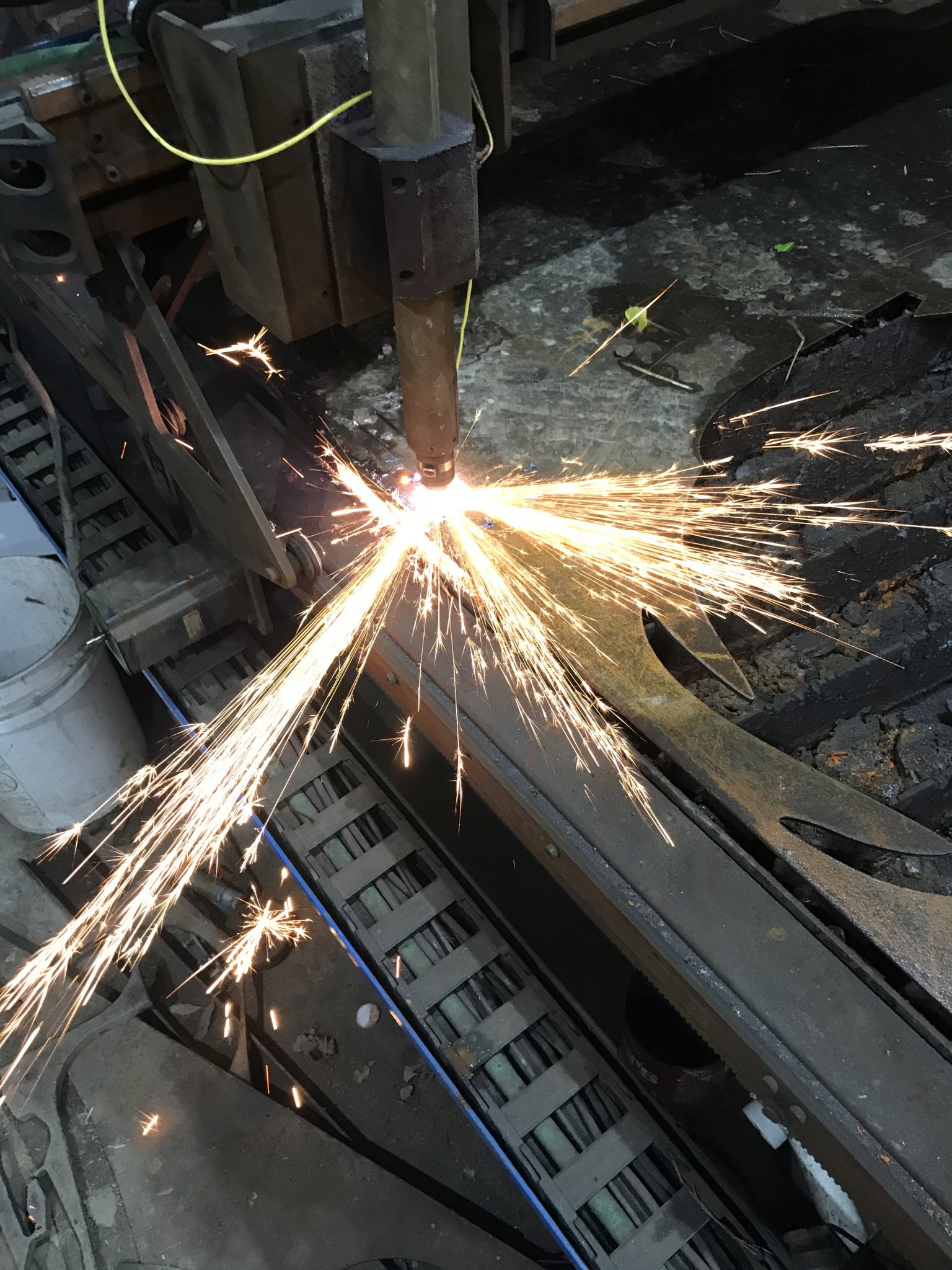

Went out to the shop and fired up my plasma table and made a little test bracket.

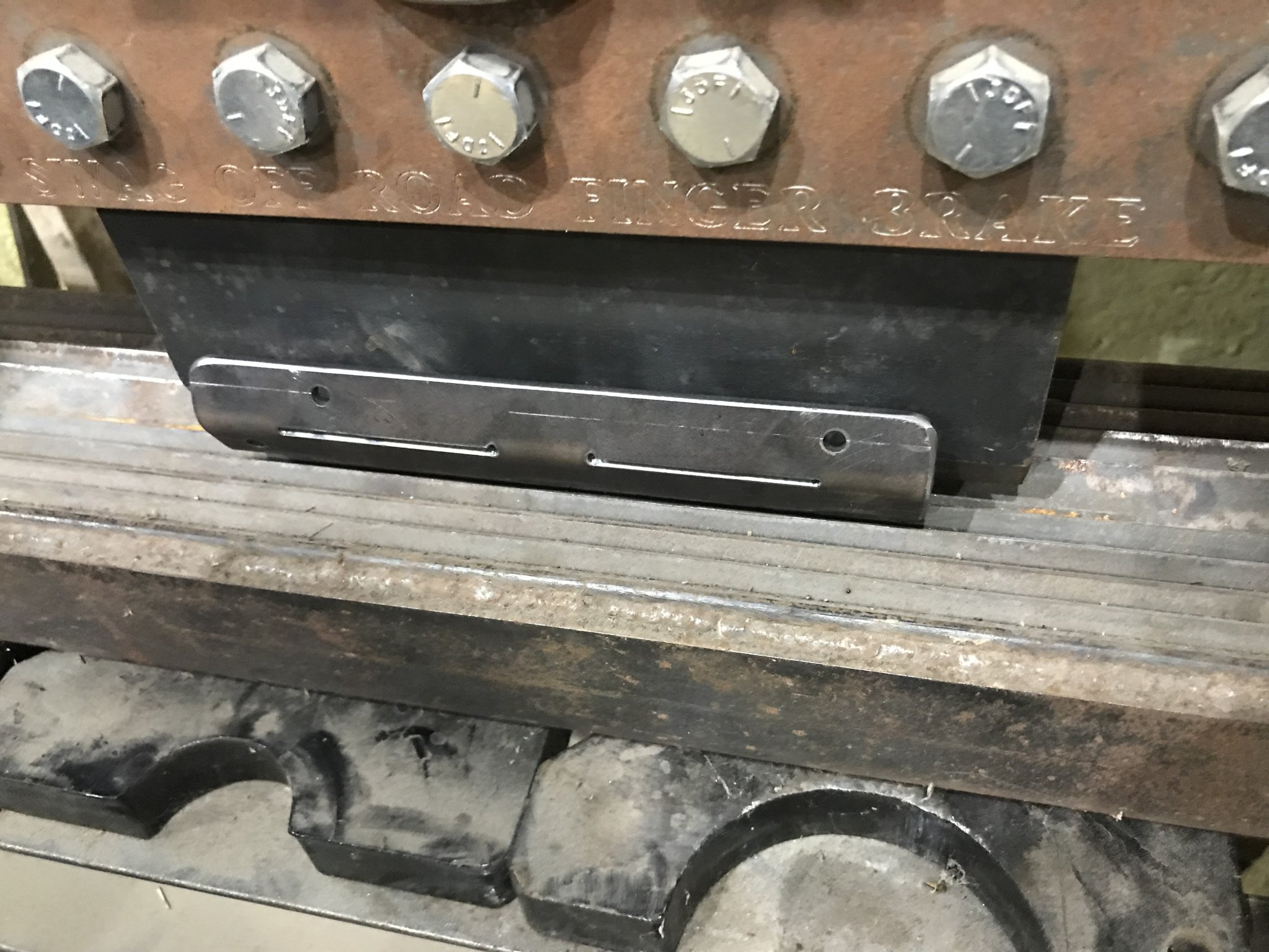

Did a little bending

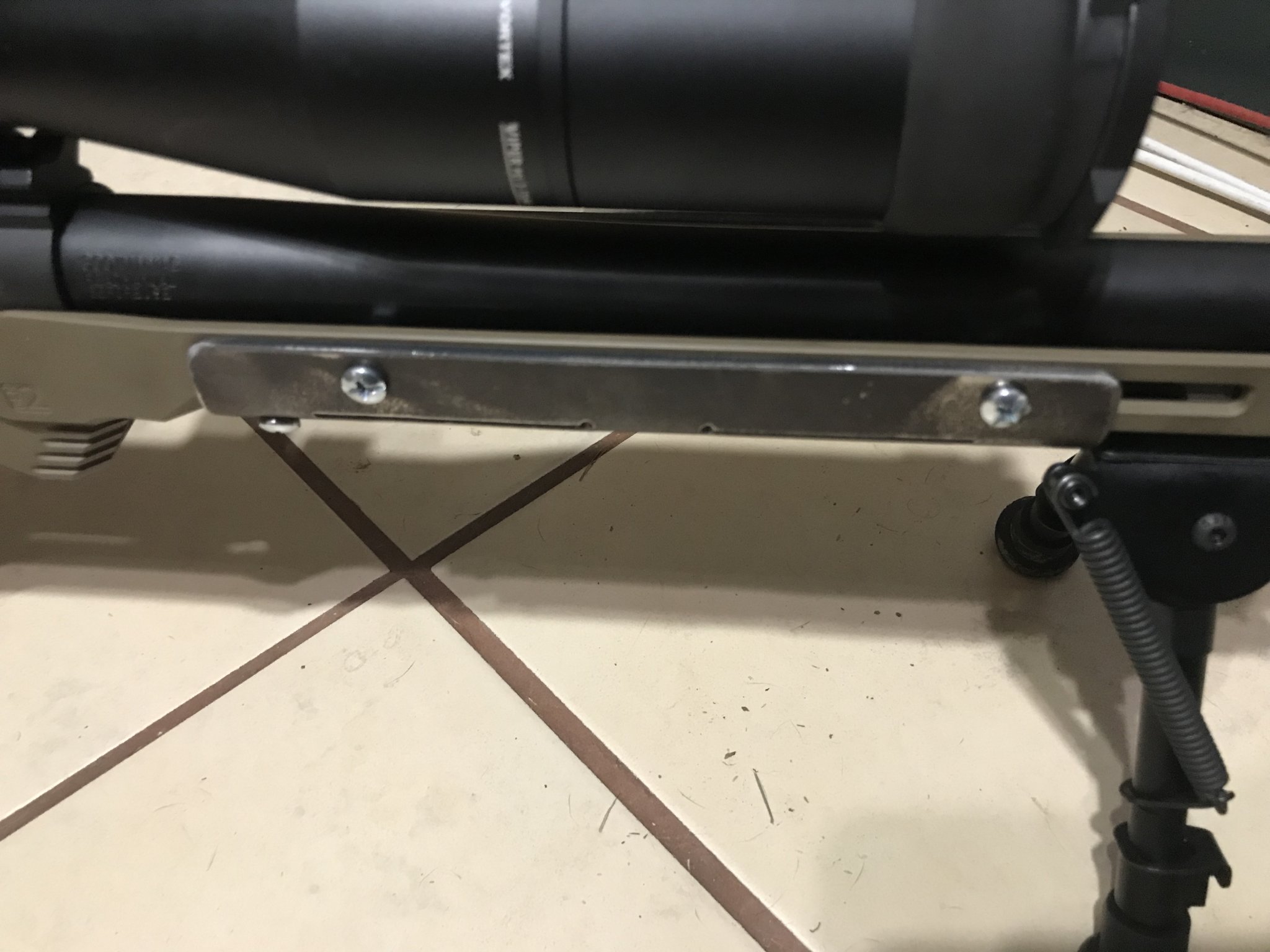

Bolts are just temperary till I get the correct ones to make it look clean. Im going to try this bracket out, may end up making it fit the whole forend and go under the bipod on the next one. This fixed 90% of the flex, now the bipod is moving like you said. So I may make this longer to try to give the bipod more of a bite.
Awesome. Very nice!
I’ve found the LSS XL flexes like a wet noodle unless you bolt something on the bottom to stiffen it up.
Also, be very careful where you clamp on it (PIG/HOG Saddle) as the action inlet area flexes just as much as the rest of it.
