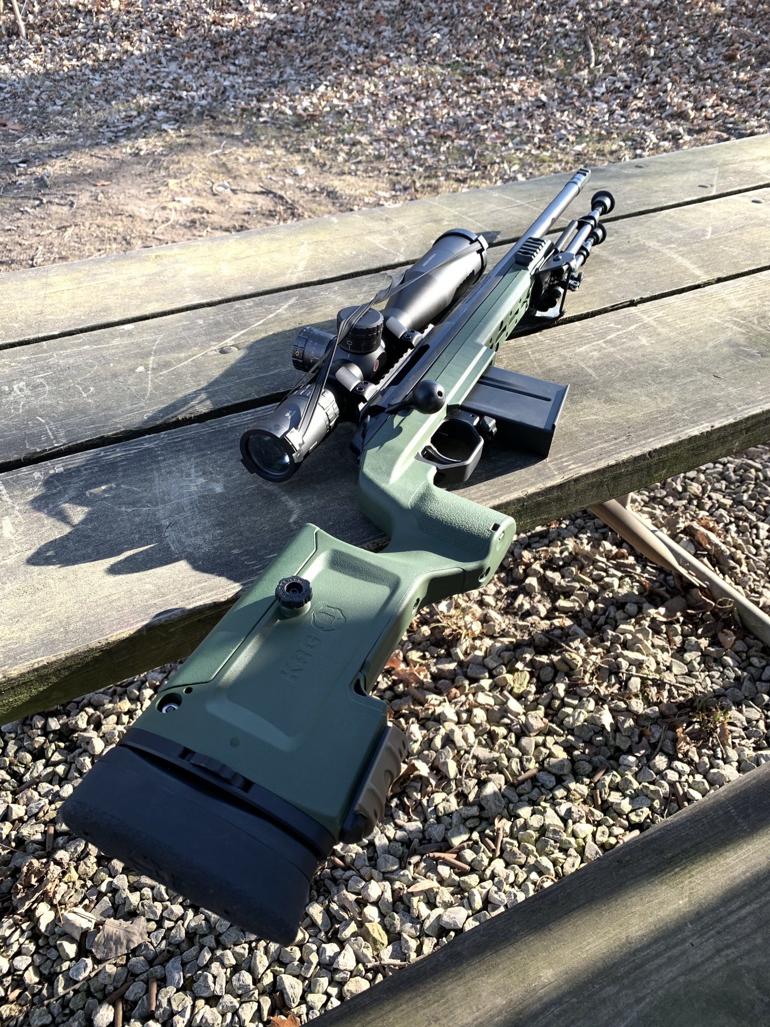

Hello guys.

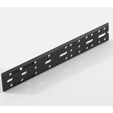

I have a T3 with KRG Bravo, recently considering improve it with an ARCA rail so the bipod can slide on the rail based on my need.
However KRG's own low profile rail is out of stock, the heavy version seems overpriced for me.
Thus I wonder if putting a MDT M-LOK arca rail onto a KRG Bravo a good idea?
MDT says it's okay with any M-LOK profiles, and it seems the holes at the bottom of KRG Bravo's plastic case are M-LOK holes.
Thank you.
The KRG rail bolts on through the plastic handguard and attaches the rail solidly to the aluminum backbone. It is a solid connection and takes flex out of the forend. Using a M-lok attach rail will have the rail only held in place to the plastic handguard and is likely to be pretty flimsy. I would try to get the correct KRG rail.
