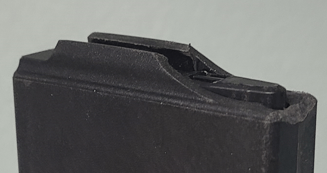

It could be something as simple as shortening your mag lips a touch, are you using poly or metal mags?

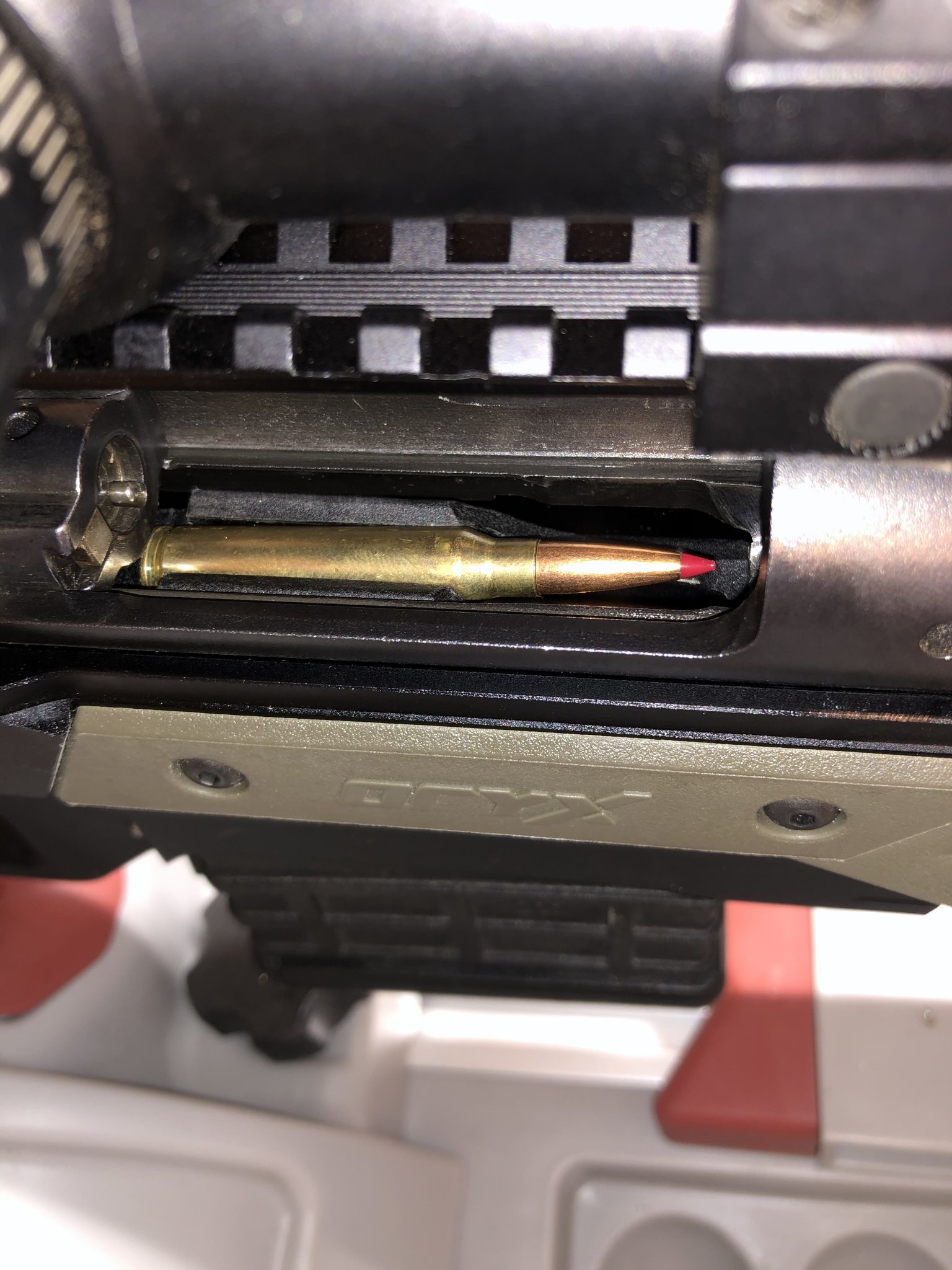

I have watched it and it does seem to be that the feed lips are to long I would modify it but it’s a loner mag from my brother. It’s a poly mdt mag I’m using.

So the bolt will pick up the round but doesn’t lift it out of the mag into the chamber. I’d post a video but not sure how

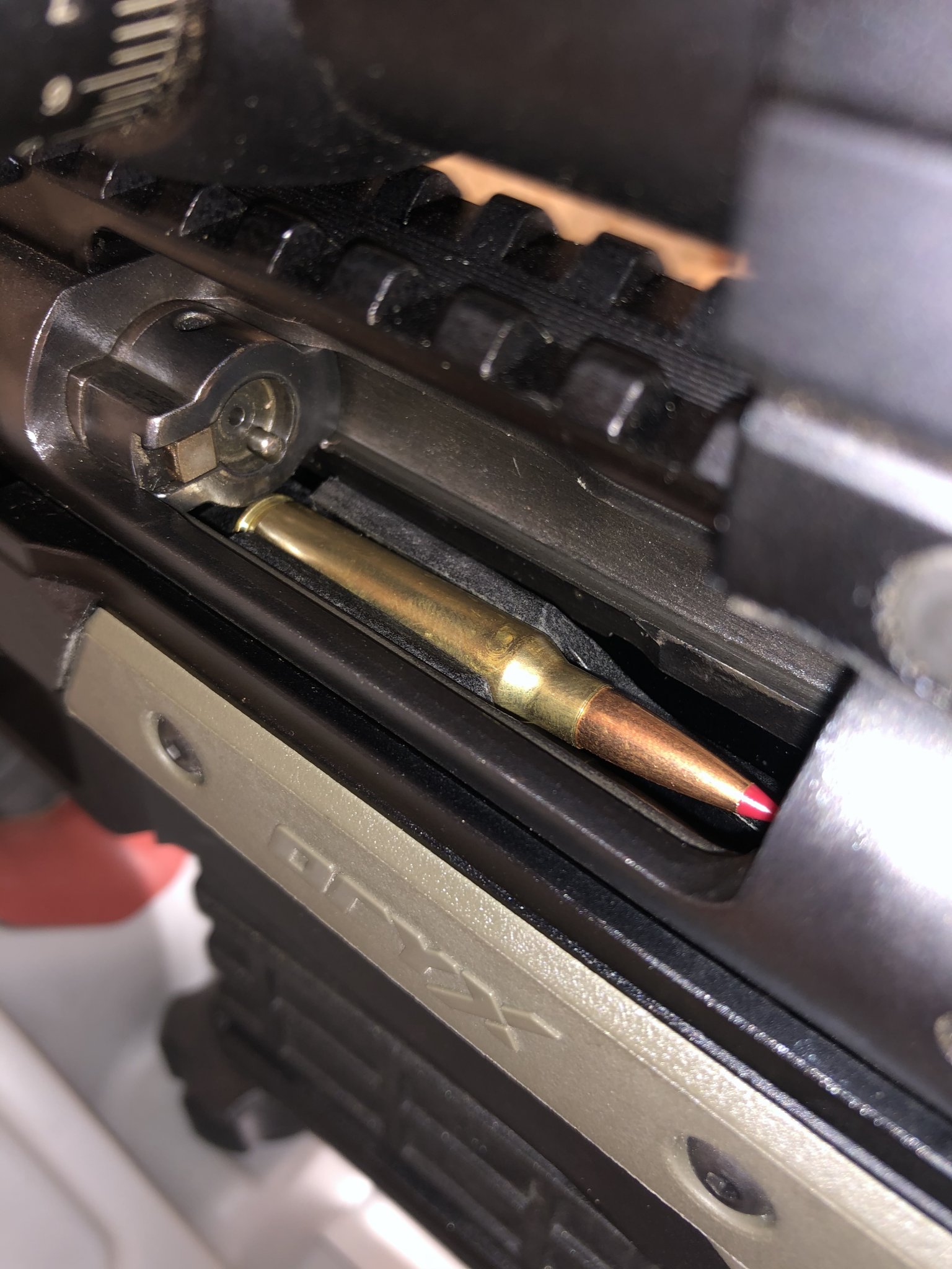

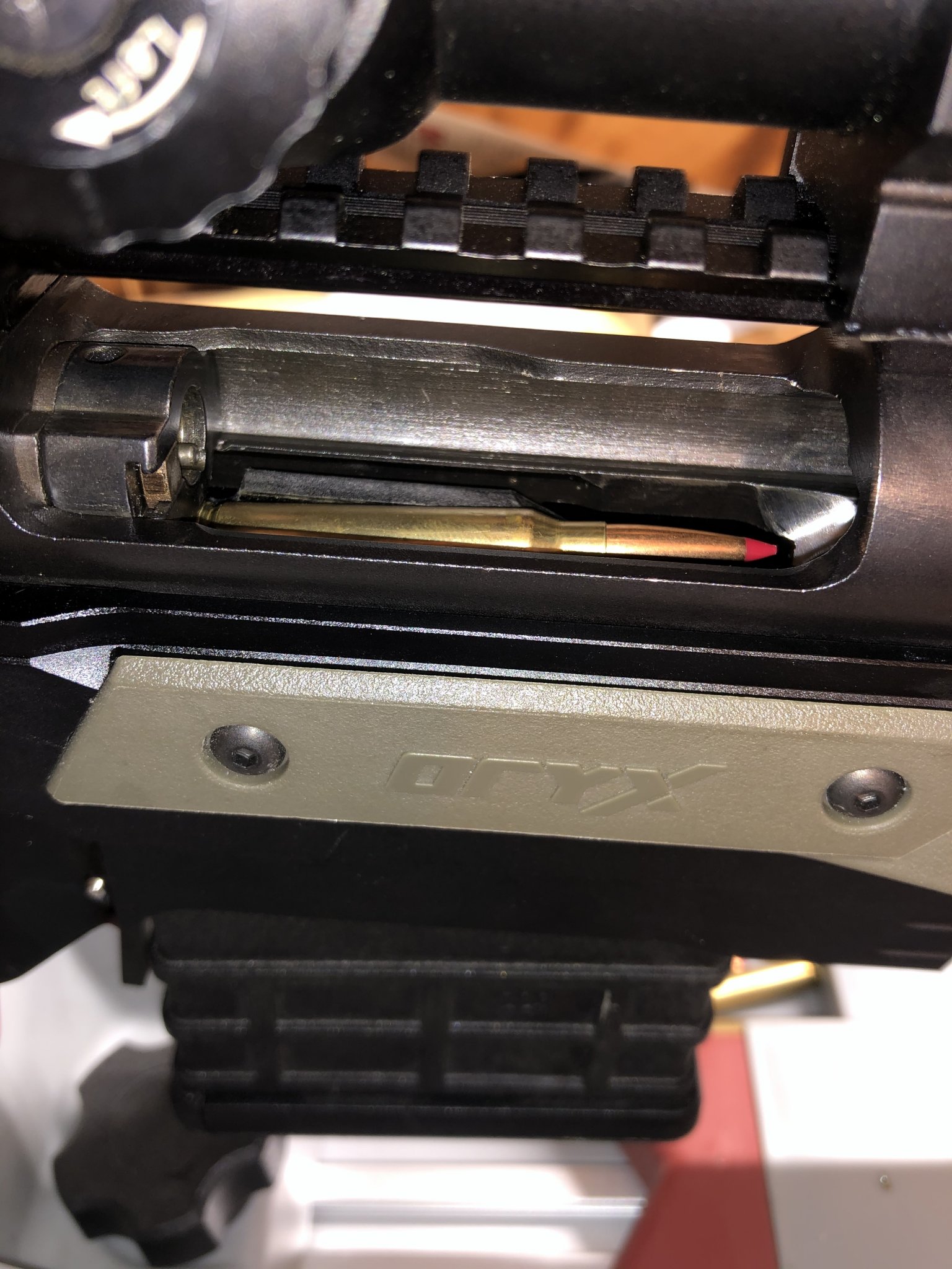

So this is my Savage 12FV .223 action in an Oryx with a MDT mag. Looks like my mag sits up quite a bit higher in the action and the round is much further up the bolt face? I assume your bolt ends up slipping over the top of the round? I also just realized that your round seems to be weakly pushing on the feed lips...mine is very snug all the way across. I also have the long baffle and ground the rear of it down to get the exact pull I wanted on the bolt.

Try filing the feed lips down on the inside. File an area about 1/4 to 1/2 in long from the front of the lip back. This will allow the case to "pop" out of the mag a bit sooner.
What grain are those eldm’s? What COAL are they loaded to? Does factory SAAMI ammo jam in the same place as your hand loads?
Can you take a couple more photos with the bolt feeding a round further forward and another at the point of jam?
I have a sneaking suspicion.

Raising the mag if you can would be a good start, you can see yours is seating lower than the other posters.
How much clearance is there at the moment between your bolt and the feed lips?

Can you take a pic of what happens when it doesn't feed correctly?
I had a similar issue with a Savage in an XLR Element. I had to file down the front edge of the MDT polymer mags because it was making contact with the action and not seating deep enough to lock in place. If I remember correctly I also slightly filed down the top/inner edge of the feed lips so the bolt barely cleared the lips, and the rounds sat as high as possible. Feeding has been reliable.
