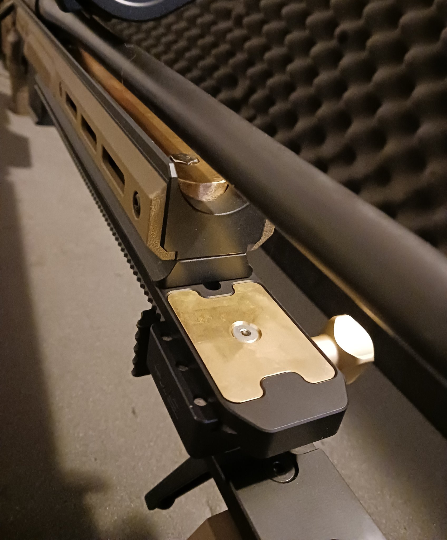

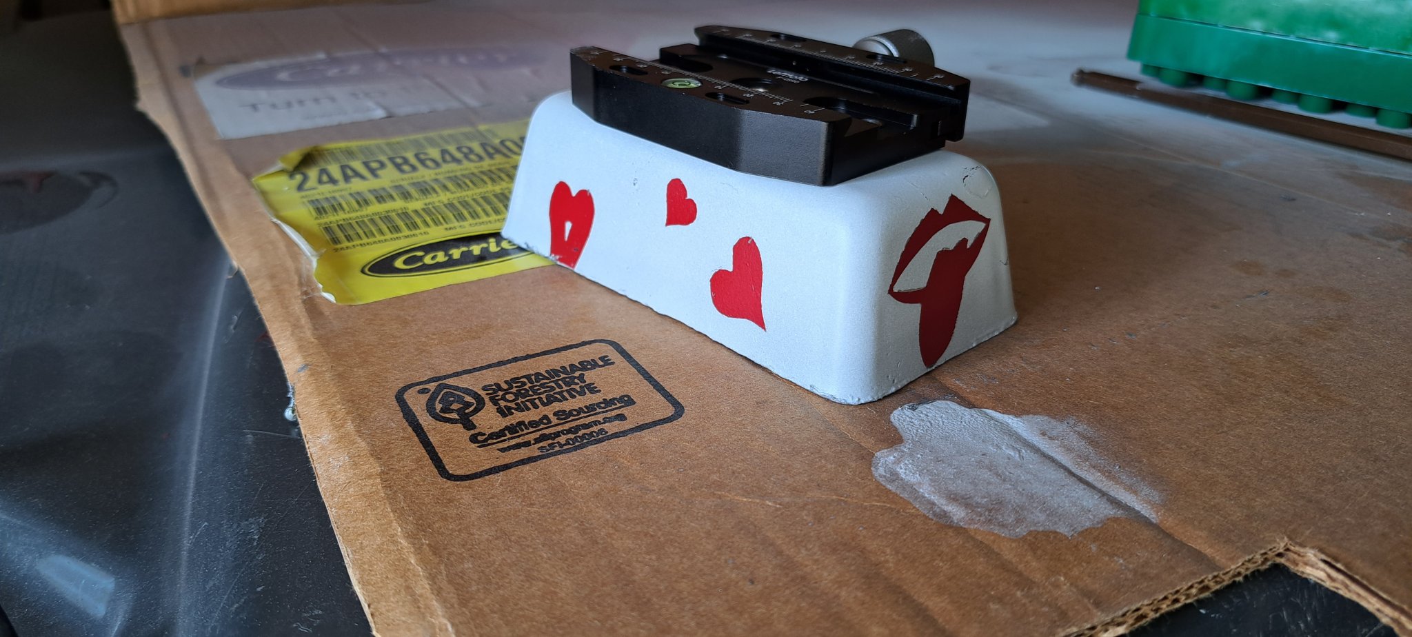

Or, you could make a removable, adjustable weight out of lead. Attach it to an arca clamp.

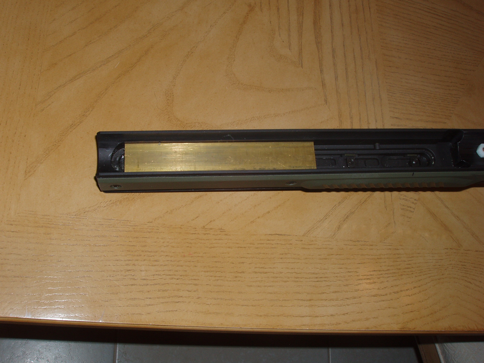

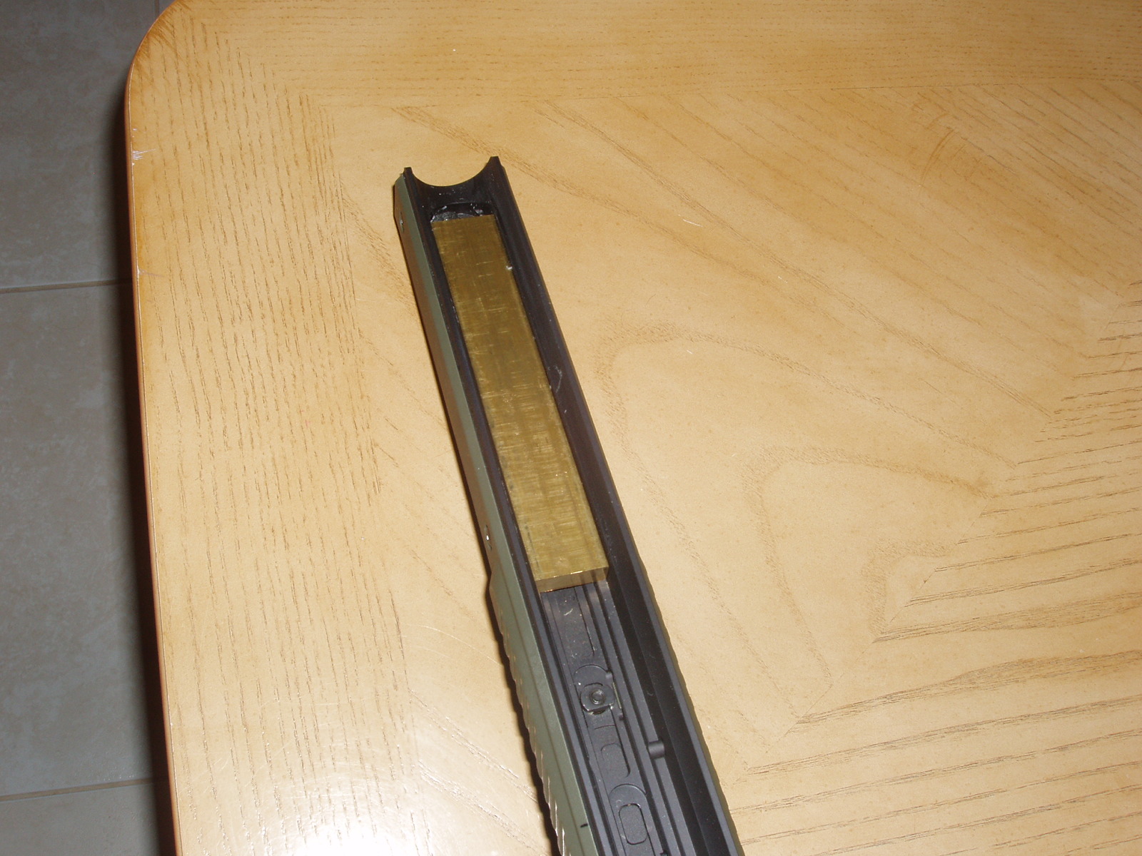

How is the barstock fastened?
I poured shotgun shell bb s in the channel on the bottom of the stock then poured epoxy on top of that then press fit the brass bar onto the stock and it was a perfect fit. The channel is one inch i believe and amazon sells that brass stock. 1 inch by 8 inch by 3/8 inch if memory serves me Lead shot worked out great

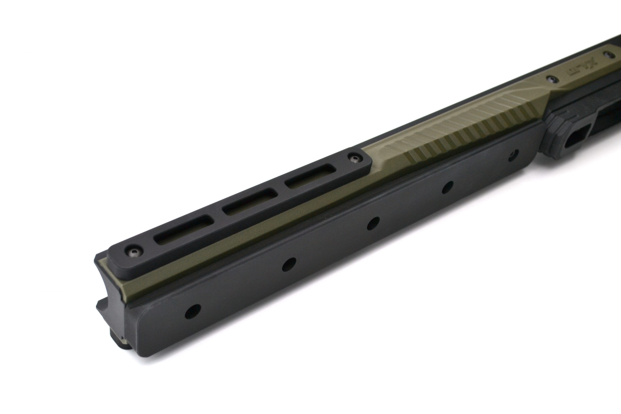

Do we need to order weights with special spacing or are the forend mounting screws suspiciously 140mm apart?
@MDT_Josh can confirm, but I think the hardware they include to mount "two weights per side" is for MDT's exterior weights. I've no idea if other weights would or would not work. Obviously any weight intended to mount to 2 or 3 m-lok slots will work within the m-lok section of the skin.
No these are designed for use with our existing M-Lok exterior forend weights and do not require any proprietary weight setup!
WE are a Canadian company and design our parts in mm, so that is the reason for the "suspicious" 140 mm spacing ;)
