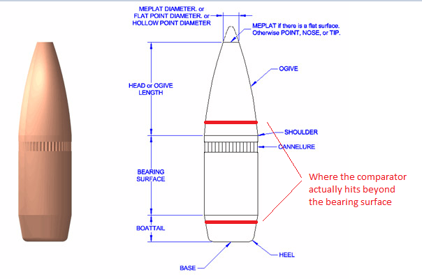

Without two datums it will be impossible to get a real bearing surface length in a boat tail bullet.
The best you can do with a single is bullet base to ogive.
And even with two hornady comparators a true bearing surface length wont be possible as you have the smidge between the actual bearing surface (which is at a .308x diameter) and where the comparators touch (which is a .300 diameter) to contend with.

To get a real bearing surface measurement youll need a real bearing surface comparator tool
