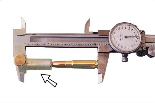

There's a much easier way. I use a resized case that has a slotted neck. It holds the bullet loose enough to allow you to chamber it, and have the bullet push deeper into the case when it's chambered. However, the case neck is tight enough to hold the bullet when you open and retract your bolt.
Then measure it (from the ogive) with an inexpensive device like this:
You can read more about this technique (and others) our website.
- Innovative
</div></div>
I did this before I got my Hornady tool. They both came out with the same measurement so I know that this method is just as good as any tool.
As for closing the bolt. I just push the cartridge in all the way with my fingers then pull it back out. Then take the measurement. You have to make sure that the slotted neck still has a good amount of tension in it. You load the bullet long into the cartridge, then push it into the chamber. The lands should push the bullet back.
